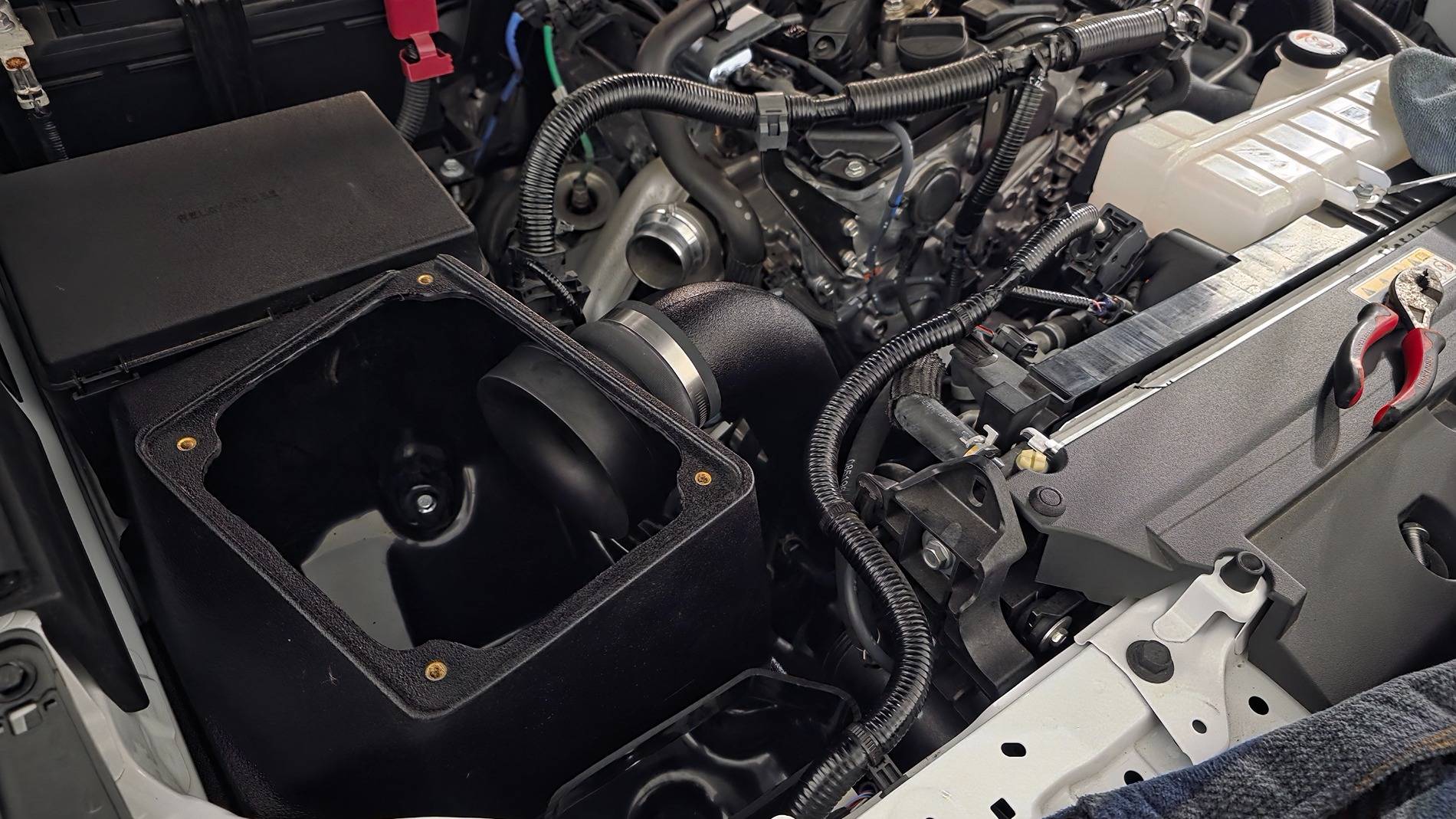

Installed this intake with high hopes of a clean and easy install. K&N does a great shop in r&d and fitment always seems on point. However, this wasn't entirely thr case with this new intake..I chose it over others for the full inlet replacement. Where those vacuum hoses all tie together is a mess, and the provided hose too small i.d to fit on. Seems like a few small hose clamps should be used here and there but arent. It was also missing a bolt to hold the airbox down. The holes in the lid of the airbox dont align with the airbox itself and took some effort (one shown in first pic).
Once installed it looks very nice, turbo noise in much increased at initial spool up. I like the aluminum flange that ties the turbo to intake they added. I've attached a few images from the process. I'll be looking for ways to better finish the vacuum lines though, those appear like a complete after thought from K&N.
Any questions feel free to ask. Kit does come with b/w install instructions, the website has them in color. The MAF orientation can be confusing and the wire is a little tight once in place.
2024 Tacoma K&N 63 series air intake review + sound clip video (on gas 2024+ Tacoma 4th gen) 20250414_214844
2 bolts were easy, the next to were off enough they were very difficult to get started.
2024 Tacoma K&N 63 series air intake review + sound clip video (on gas 2024+ Tacoma 4th gen) 20250414_215539
Completed install, does look very nice IMO.
2024 Tacoma K&N 63 series air intake review + sound clip video (on gas 2024+ Tacoma 4th gen) 20250414_212735
Mess of vacuum hoses.
2024 Tacoma K&N 63 series air intake review + sound clip video (on gas 2024+ Tacoma 4th gen) 20250414_212741

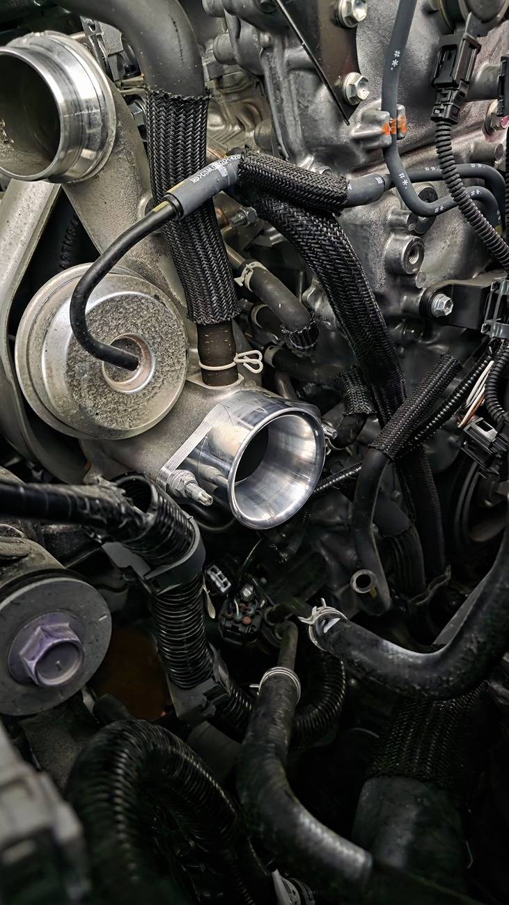

2024 Tacoma K&N 63 series air intake review + sound clip video (on gas 2024+ Tacoma 4th gen) 20250414_203131
Factory turbo inlet silencer "manifold"
2024 Tacoma K&N 63 series air intake review + sound clip video (on gas 2024+ Tacoma 4th gen) 20250414_203846
K&N turbo airhorn installed.
Part throttle initial boost is the most noisy, the "dose" from no bov is fun too.

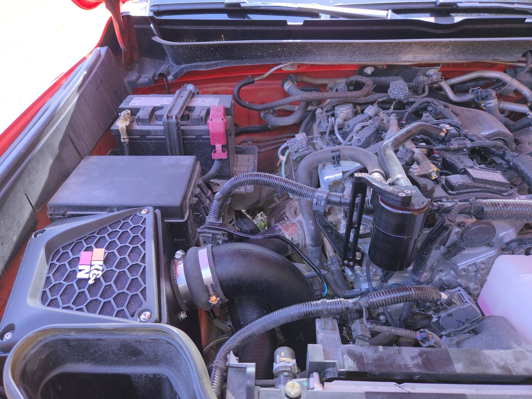

New member here, I just installed this intake and I very much agree with the mess of the vacuum lines. I have been having some issue with mine it's been saying reduced engine power message, which i feel like it's a vacuum hose issue but could be wrong
Is that the burger catch can? I plan to get that as well, already had some oil in the turbo inlet
I'm debating removing the k&n because of the vacuum lines, I haven't had an issue but it's such a hack work around I cant believe k&n released it.
Ace-ington
Apr 29, 2025
Yeah it's the burger motorsports catch can, I ran the k&n intake first before the catch can and had the issue, today I went to canadian tire and bought a clamp for the hose that has the clamp on the one side so I will see if that made a y difference. The message usually shows up after one or 2 drives.
