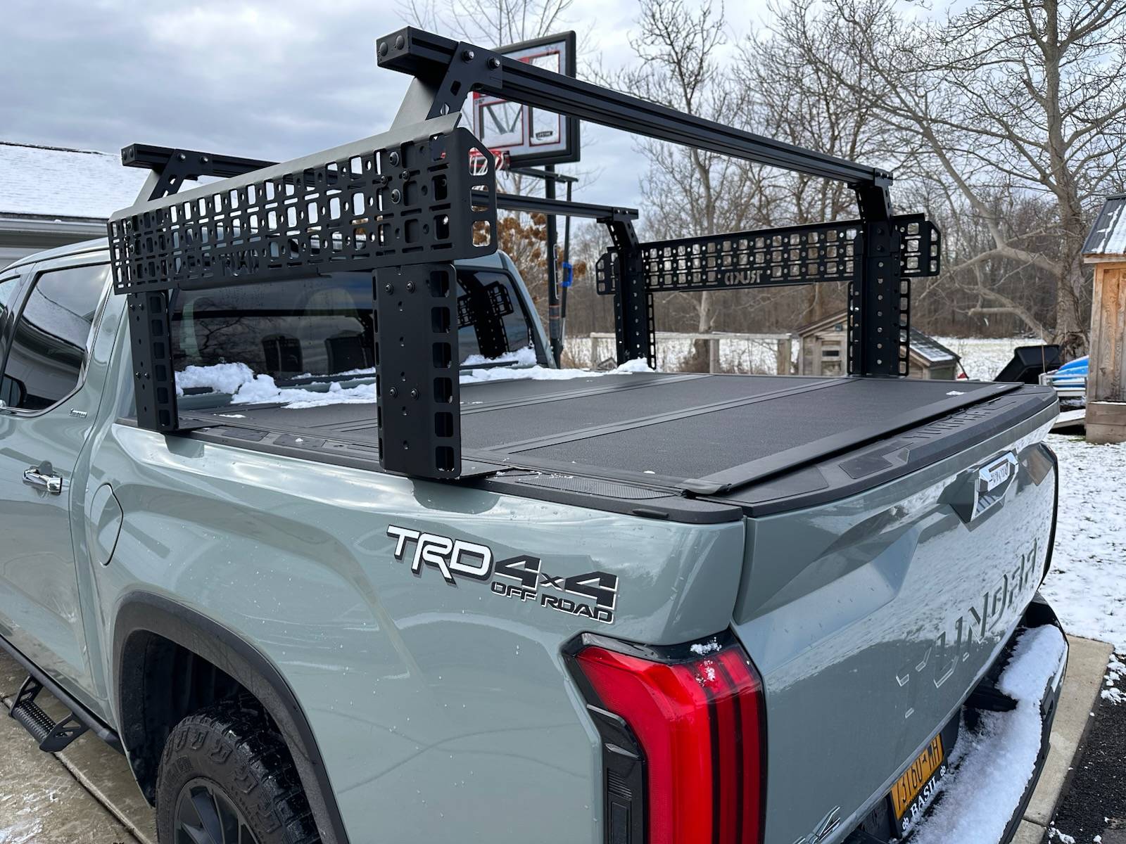

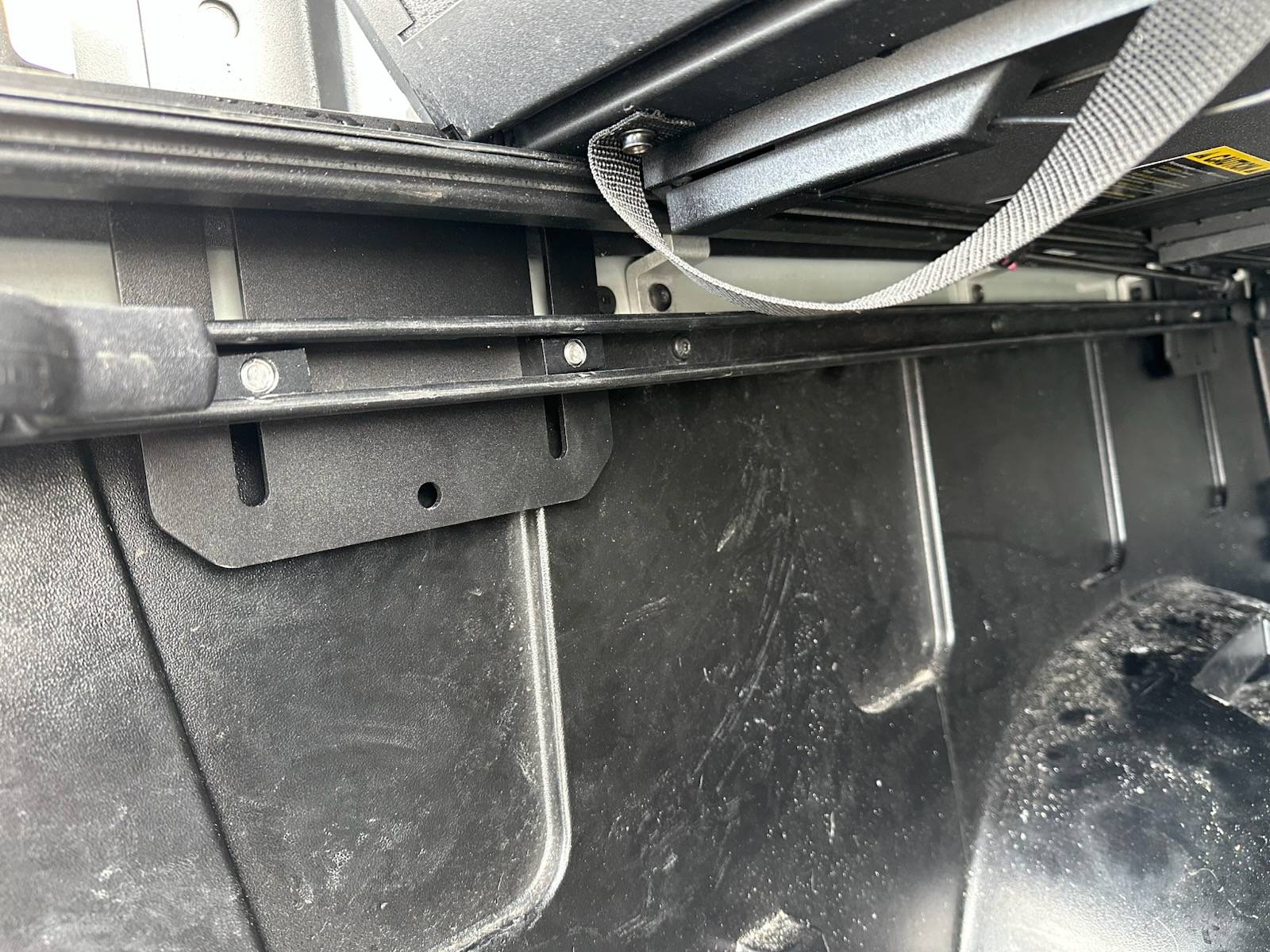

The contours required of such a bracket are tricky. We have had customers overcome it by modifying the utility rails. I attached some pictures.
You can also sandwich an Elevate TS rails between the bed cover rail and the truck utility rail. Then you could mount a T-Slot rack to the TS rails.
