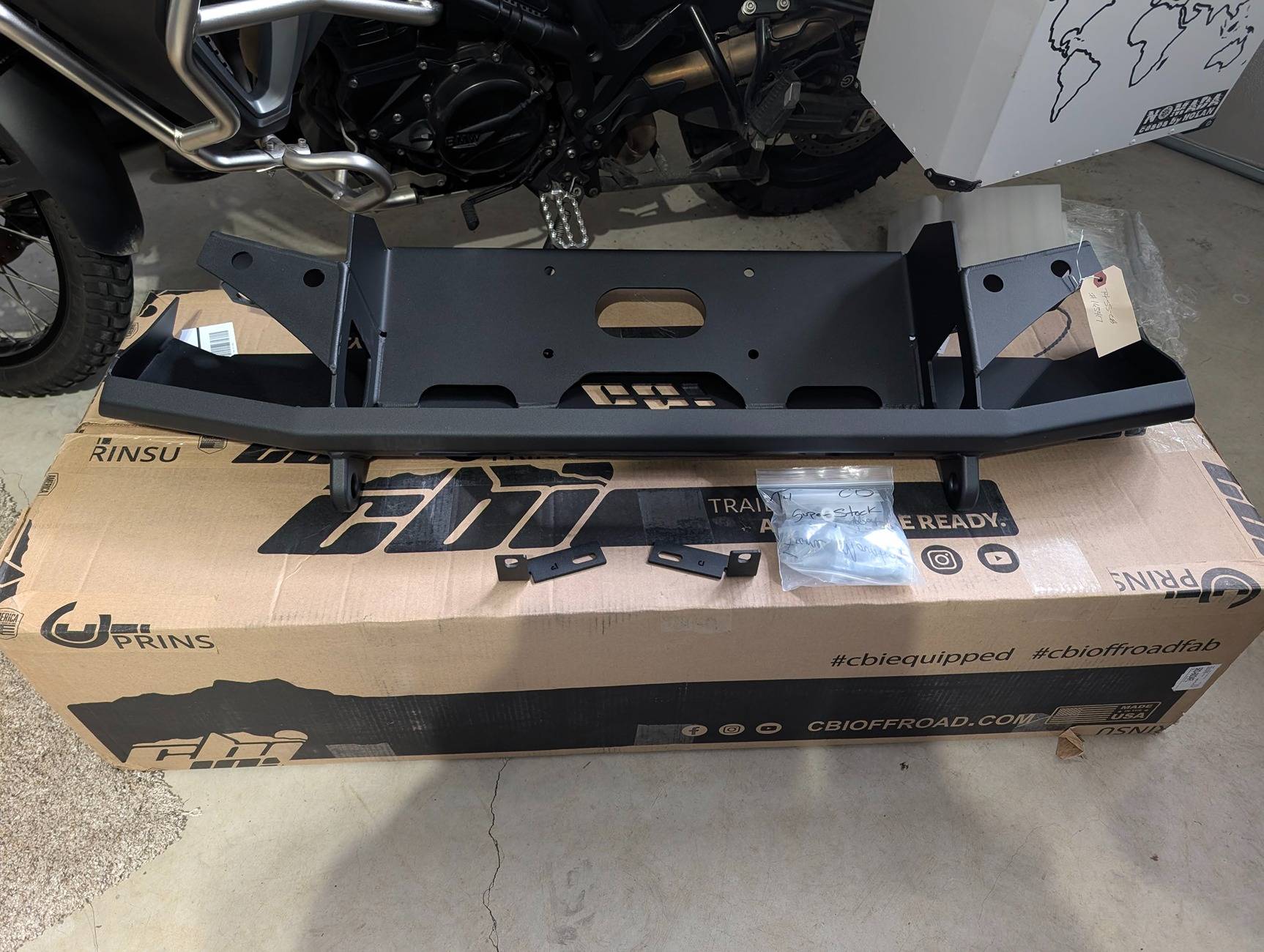

The bumper was packaged very nicely with plenty of material to protect it and a sturdy box. The bumper itself is heavy gauge steel with a nice finish. I don't see it rusting anytime soon. It is a nice bumper. That said, there was absolutely no documentation or packing list of any kind. I always like a packing list so I can verify all the correct parts are included before I start. In this case it's a pretty minimal parts list. The bumper, washers and bolts and two "wing" pieces to affix the fenders to the bumper (since you're removing all the plastic that formerly supported the fender). Everything was there but there was a separate bag with four smaller washers. I have no idea what these were for. They're too small to fit any of the included mounting bolts.

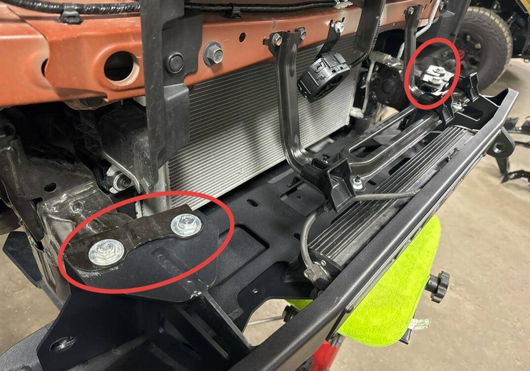

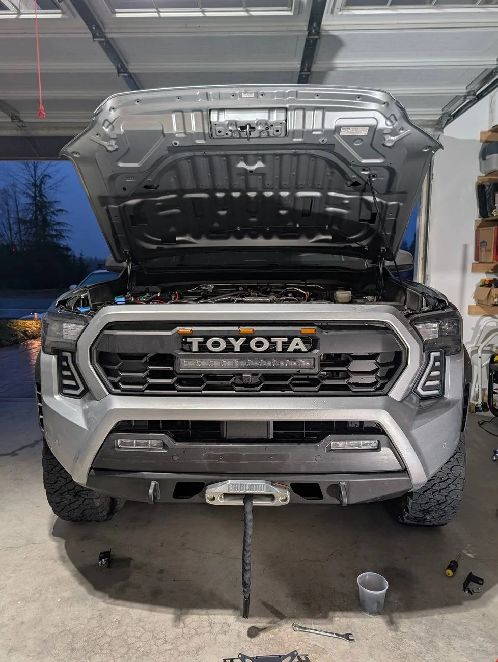

Plenty of room for the Harbor Freight Apex 12k winch. Note in the picture I had the extension cables installed to relocate the solenoid. I ended up NOT needing to do this and returned it back to having the solenoid mounted on the winch.
I have a love/hate (mostly hate) relationship with Harbor Freight but I have to reluctantly admit that their quality has improved dramatically in the past few years. I'm very impressed with the winch. It came with everything you would need, including a solenoid relocation bracket and extension cables, a nicely polished fairlead, forged hook, wireless remote and cover (unnecessary for this install). I had a 25% off coupon so paid ~$450 for the winch.

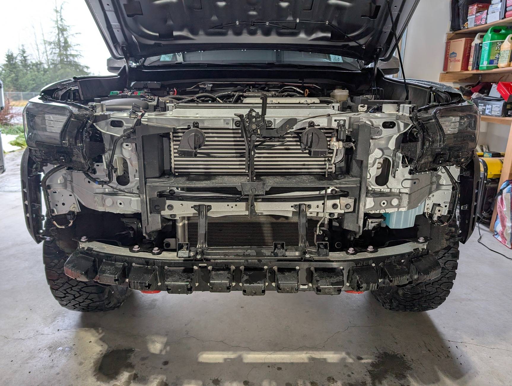

Taking the front end off the truck is easy and there are a ton of videos out there on how to do it so I won't go into detail.
There are four or six bolts holding the factory crush bumper on. It's an easy removal. Interestingly the bolts on one side were torqued really tight while the other side was barely finger tight.

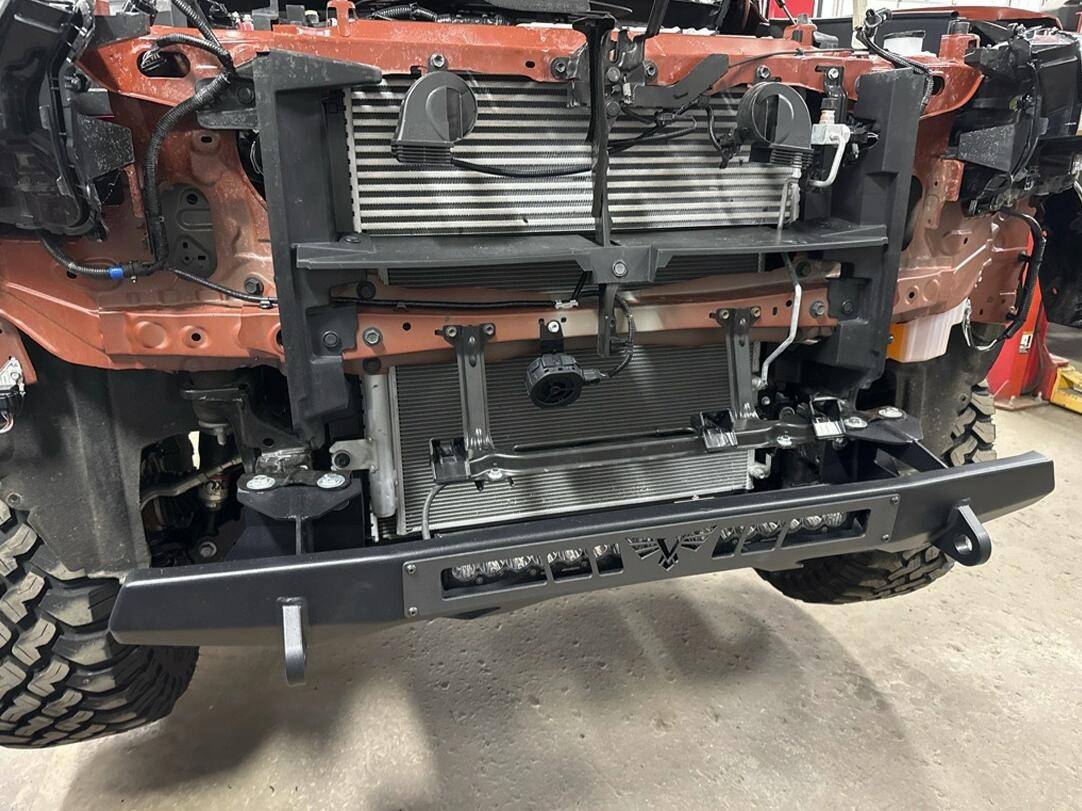

Note that the solenoid has plenty of space under the grill support beam but also note I've removed the support structure that hangs down. CBI removes it in their video and never reinstalls it. The main issue is that with the support installed you can not turn the freespool lever. This is universal to all the installs I've seen regardless of the manufacturer. RCI is the only one I've seen that really solves the issue. If you watch their install video, they actually include a replacement bracket (the 7:40 mark shows it) that allows the support to be used whilst still allowing the lever to turn. Very nice! That said, I decided to leave the bracket completely off and I think it's fine. The grill does not move at all so I'm not concerned and I can reach in and easily turn the lever. I could even plug the controller in if I had to, although there would probably be scraped knuckles. Wireless is the way to go...

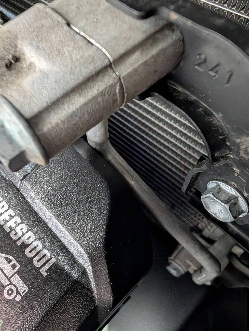

At this point I ran into a huge issue. If you look at the picture there is a tube running down the radiator on the driver's side. I don't know what this is for but it seems like a coolant or a/c line or some sort. Upon tightening the bolts to the bumper down, I found that the winch was physically pressing against this tube. Quite hard against the tube, hard enough to flex the tube. This was not acceptable to me. Sooner or later vibration would wear a hole through the aluminum tube, probably at the worst possible time. You might say "that's not CBI's fault, you're installing a winch that's too big". I'd argue this is a huge design flaw on CBI's part. They suggest the Warn VR Evo 10-S as an add-on purchase on their site. I compared the factory stated specs on the two winches and the Warn is not as wide but it's actually deeper than the Harbor Freight winch and depth is the issue here. I see no way the Warn winch would work. After mulling over various solutions I found some large 2" galvanized fender washers in my toolbox. I used these to space out the bumper. It's less than 1/8 inch but that gave just enough clearance that nothing is touching.

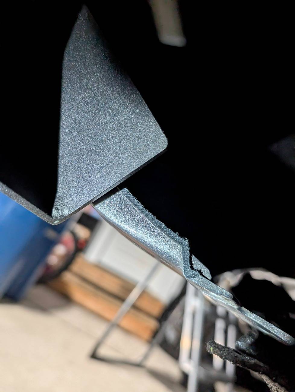

The last piece after putting the front end back on was to attach the two little wing pieces that secure the fender to the bumper. The hardware included with this seems to be an afterthought. There were two different bolts, one for the fender and one for the bumper. One is a nice black bolt, the other a plain carriage bolt. It's clear you would use the nice bolt where it's visible but in the installation video they swapped the position, one side they put the nice bolt out, the other they put the plain bolt out. Small things... Also, the bolts are way longer than necessary. The biggest thing are the actual wing pieces though. They don't remotely match the angle of the fender so if you were to tighten them down all the way you would simply break the plastic by trying to twist it to a right angle with the bumper. My solution was to simply snug the nylock nut down without putting any undue pressure on the fender.
That worked well enough on the driver's side but when I got to the passenger's side, literally the last bolt in the install, I realized that CBI had not drilled the mounting hole in the bumper for the wing. &*()*D(_& At this point there was really nothing I could do. The fender is hanging there unsupported but in reality it's no worse than the flex we have with the rear bumper plastic pieces (which bug me). There is no way to drill a hole through 1/8 plate steel with the angles I had to work with so I just left it off. Very irritating though and an example of really poor manufacturing quality control!
Correct, hole for bolt...
Nope, no hole on the passenger's side....
