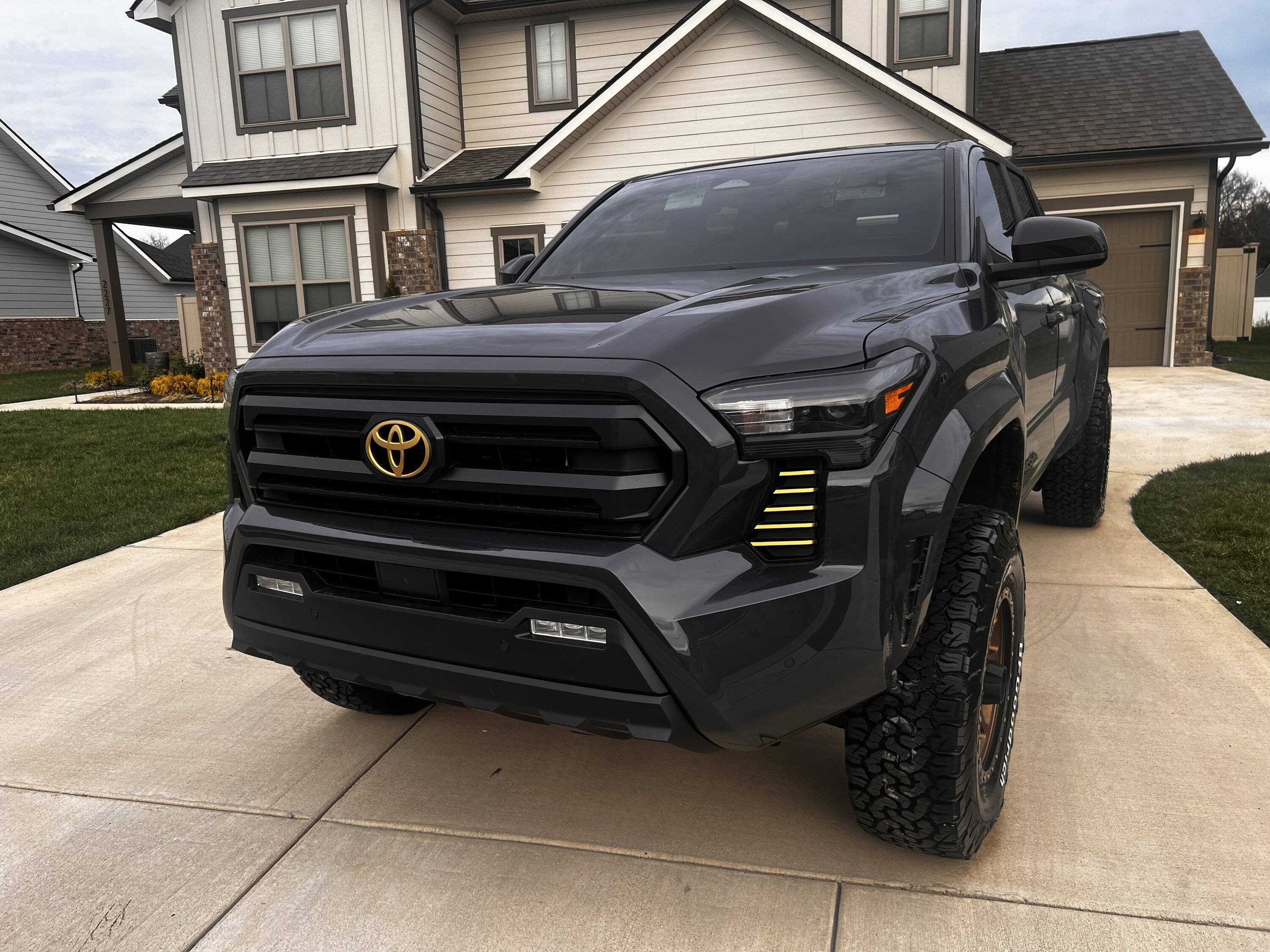

I did 1.5 level and 275/70/17 on new wheels after 2 alignments and still positive chamber.. is this normal ? I have lifted several Tacoma’s and never had that??? Any ideas?
2024 Tacoma Chamber after realign/ tires and lift??? IMG_6127

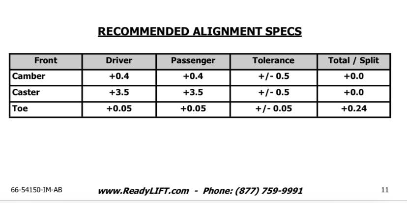

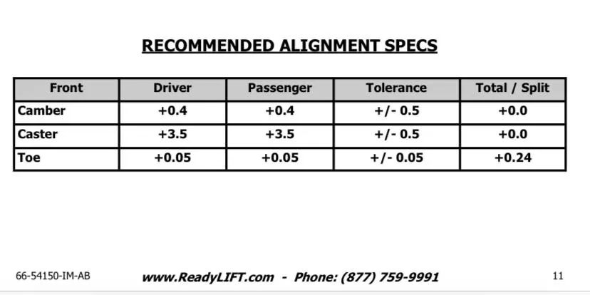

Interesting. And sorry I’m no help, but i am also about to install same kit in a week or so and then go get it aligned. I don’t know anything about alignment or what the stock specs should be myself, but is your shop using stock specs or the suggested specs from the readylift install guide? Are the readylift specs stock or altered for the increase in ride height?
ABComa
Apr 17, 2024
2024 off-road
Readylift specs from the Gen4 1.5” kit.
2024 Tacoma Chamber after realign/ tires and lift??? IMG_4936
