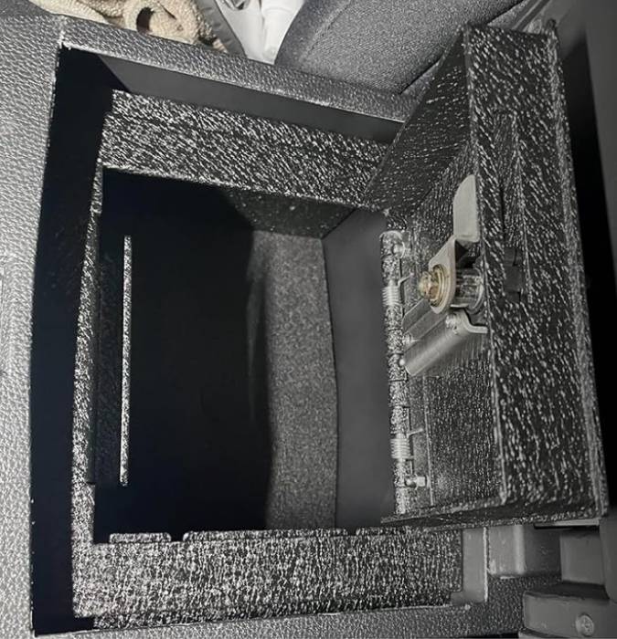

Hi Tacoma4G,
I just recently purchased and installed the Muslogy center console safe and couldn’t find any installation guide. The product itself is quality for it’s price (way cheaper than the OEM one) and has more room since it only takes a small amount of space to have it screwed/bolted within the center console.
Product Link: Muslogy Center Console Safe for 2024 Toyota Tacoma
The product installation itself is self explanatory but some people might get confused on how to install it. But here is my own guide on how to install it,
1. Make sure to clear out your center console (leave the bottom rug/cover)
2. Double check that all the installation requirements are within the box and bags provided by Muslogy:
4. Use the thin center hole puncher to make holes on the side panels.
5. Use the small Philip screws and the small Philip screw driver to screw/bolt the side panels on the center console. Make sure that it is screwed in/bolted in properly.
6. Place the top panel and make sure that it sits perfectly on the side panels.
7. Use the cap nuts and the L shape socket wrench on the screws from the top panel and make. Make sure that the nuts are bolted in properly.
Congrats you now successfully installed your Muslogy center cole safe.
To change the pass code,
1. It doesn’t matter if the center console safe is open or closed, but make sure that it is on the “0000” (stock) pass code.
2. Move the small hinge from bottom position to top position. (You won’t be able to move it if the pass code is incorrect)
3. Once you do that, you now input your new pass code.
4. Move the small hinge from top position to bottom position to enable your new pass code.
Congrats, you now have a new pass code for your Muslogy center console safe.
If there is any question feel free to comment here or message me and would be glad to help out!
