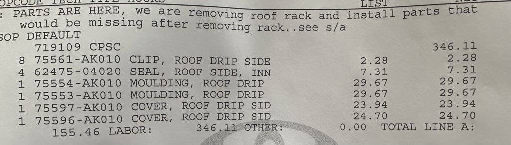

I'm about to buy a Trailhunter that comes with the OEM roof rack. I already have a roof rack on my 4runner and never use it, so I'd like to plan to remove it. Does anyone know what/where I need to order in order to make the roof stock again?
EDIT: I found this picture from another forum that appears to be the parts list if anyone else has this issue.
2024 Tacoma OEM parts after removing OEM roof rack? IMG_2903
