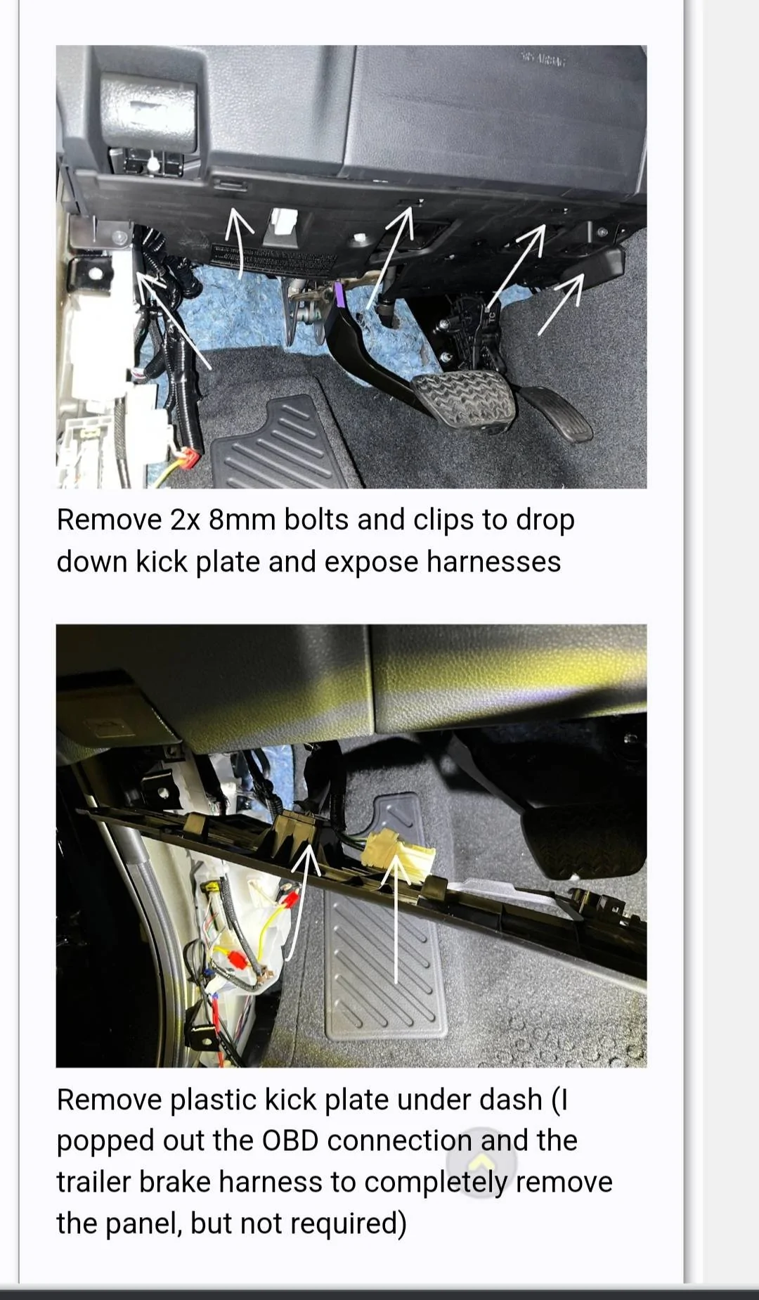

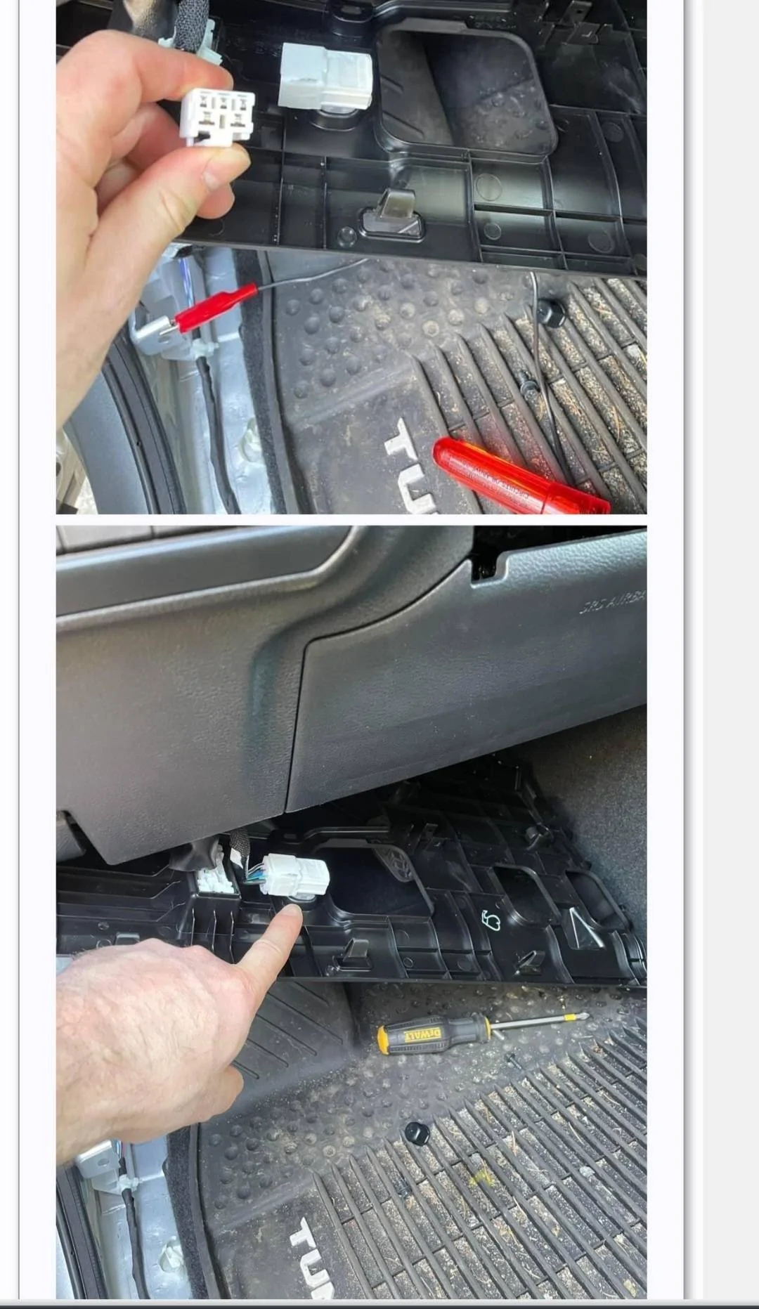

I found these in the new gen Tundra forum.
I know its a stretch but I'm posting just in case you haven't checked behind this kick panel? And linking that thread at bottom just in case it can help.
2024 Tacoma REDARC trailer brake connector location Screenshot_20240328-074952_Chrome
2024 Tacoma REDARC trailer brake connector location Screenshot_20240328-075051_Chrome

Nope, nothing but obd port. The taco has a very similar construction to the tundra under there tho
