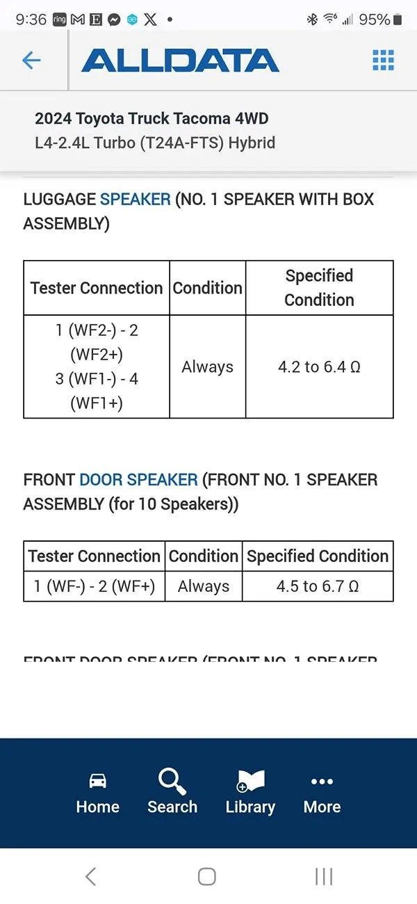

Looking for spec info on JBL amp output and speaker resistance....such as sensitivity and ohm resistance value.
What does the JBL upgrade actually up grade ? Are the dash corner and all 4 door speakers better than the non-JBL speakers ?
Know it upgrades with removable center dash speaker, front piller speakers, sub woofer and amp-----is that correct ?
Looking to upgrade door speakers to improve over all sound----but not sure if it is worth it..
Have beat Sonic amp-----can it drive all 4 door speakers better, or not ?
Thanks
