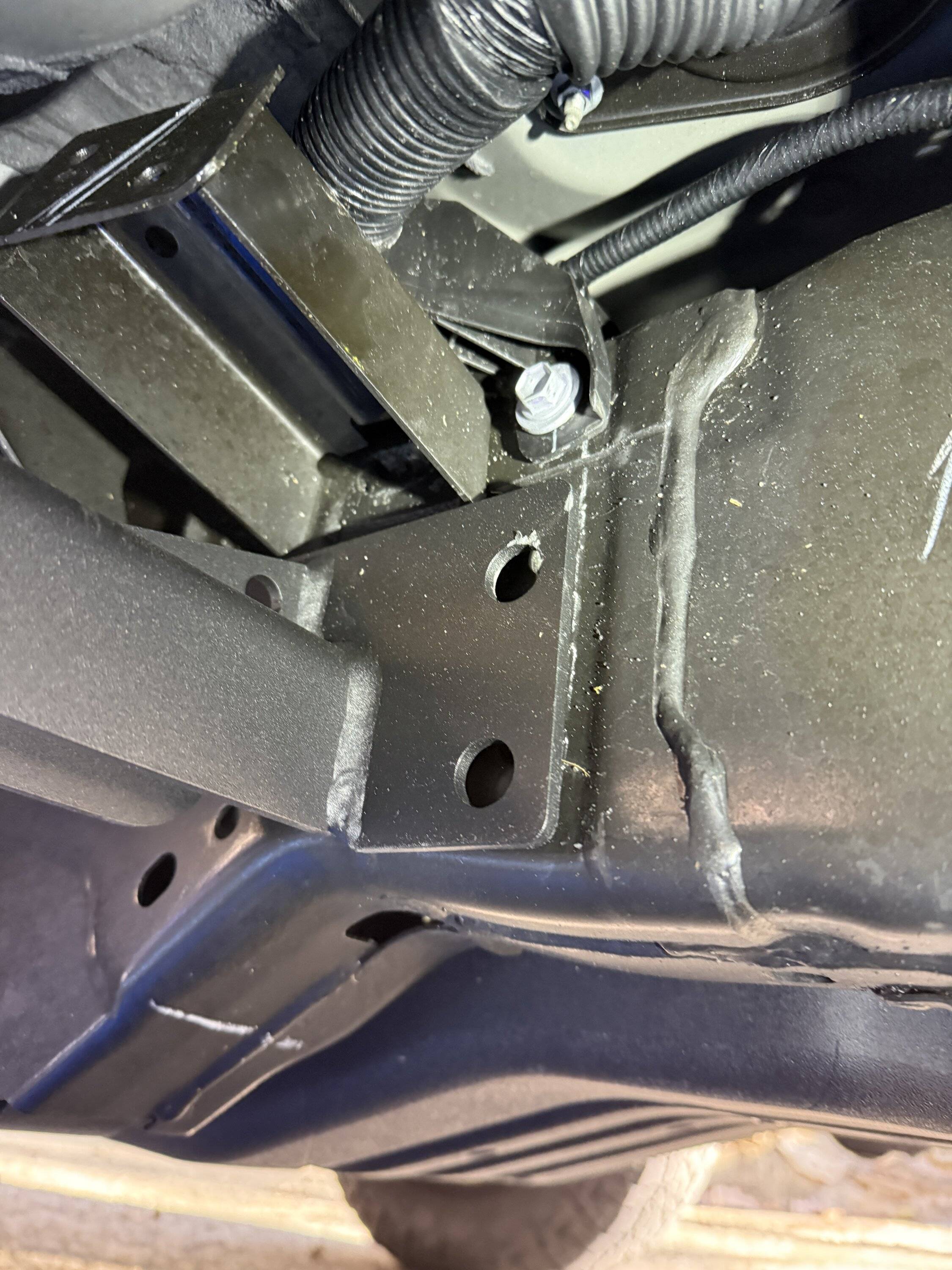

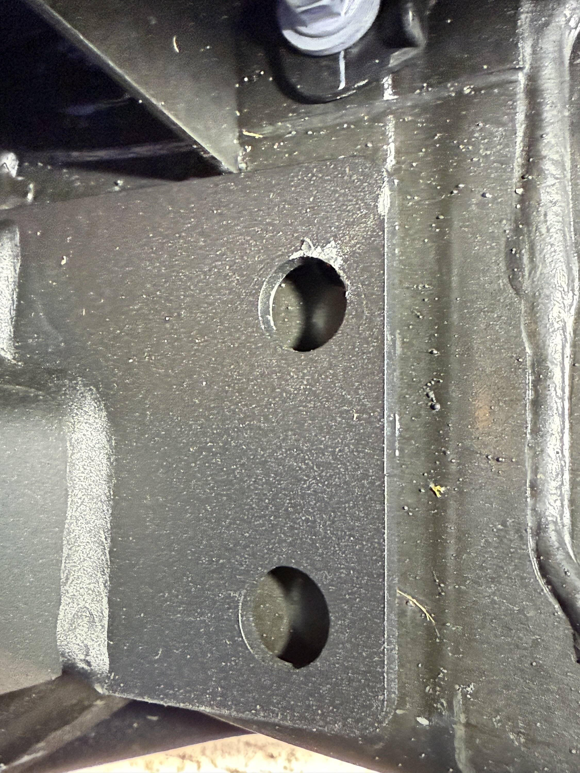

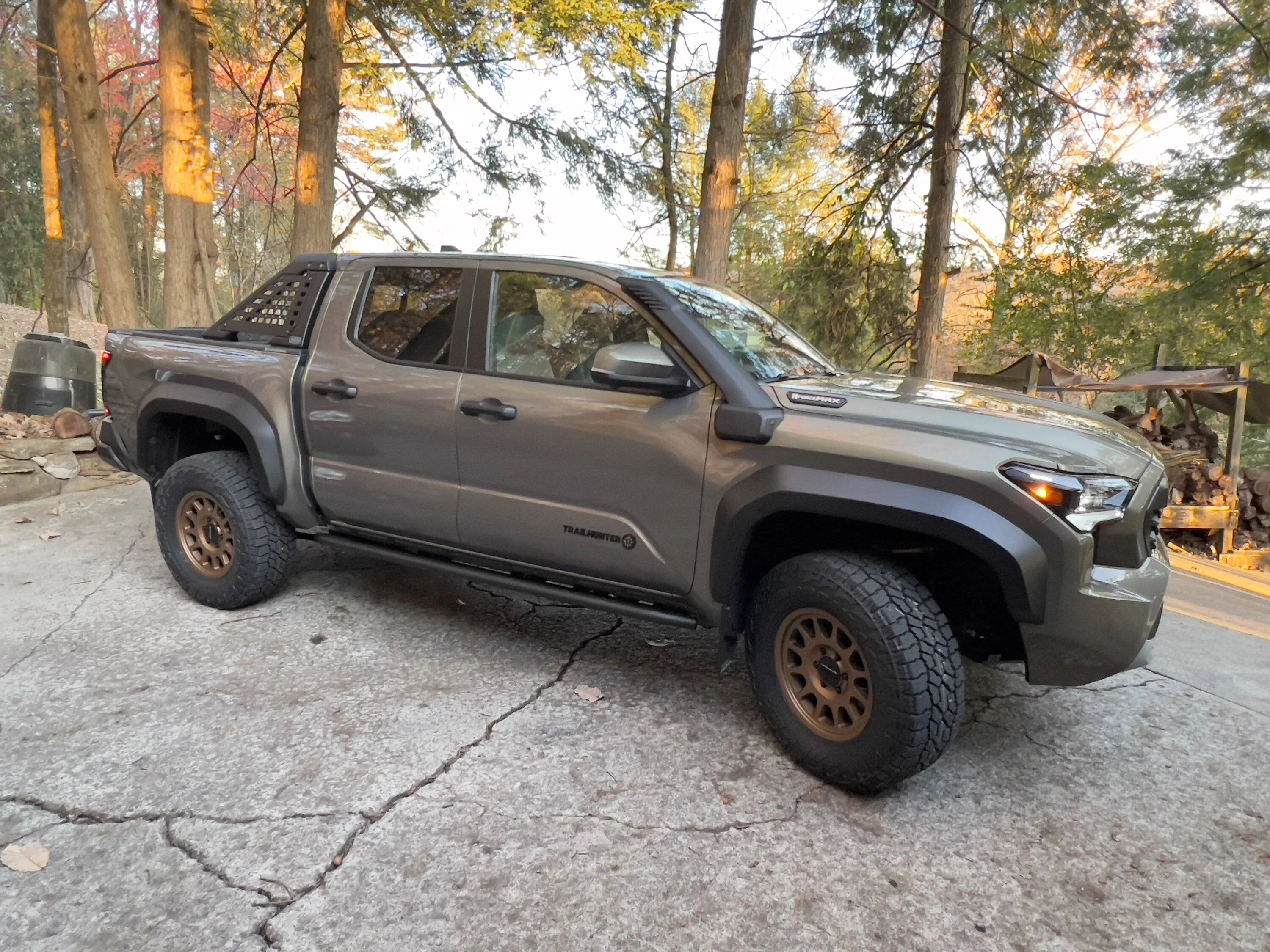

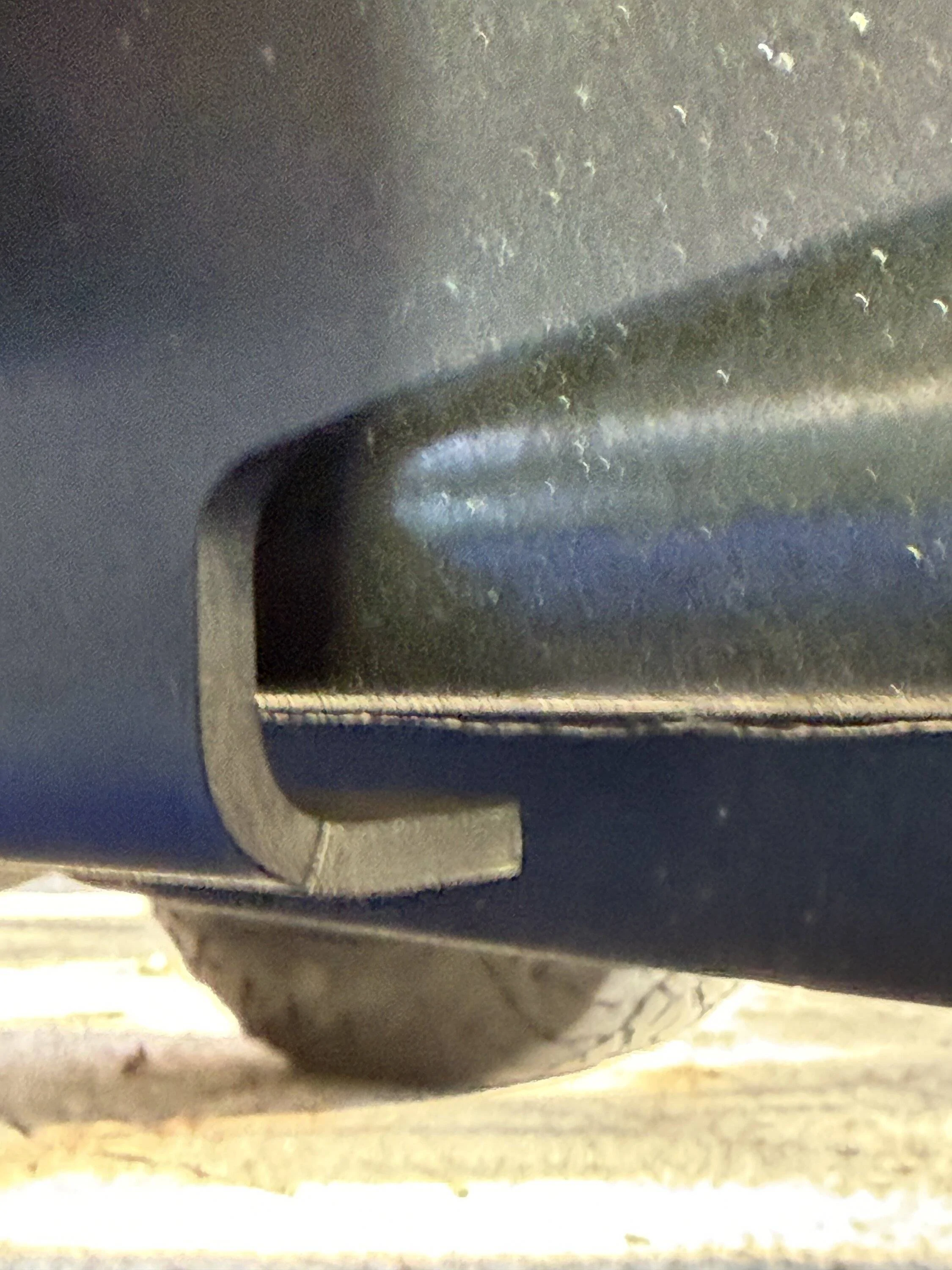

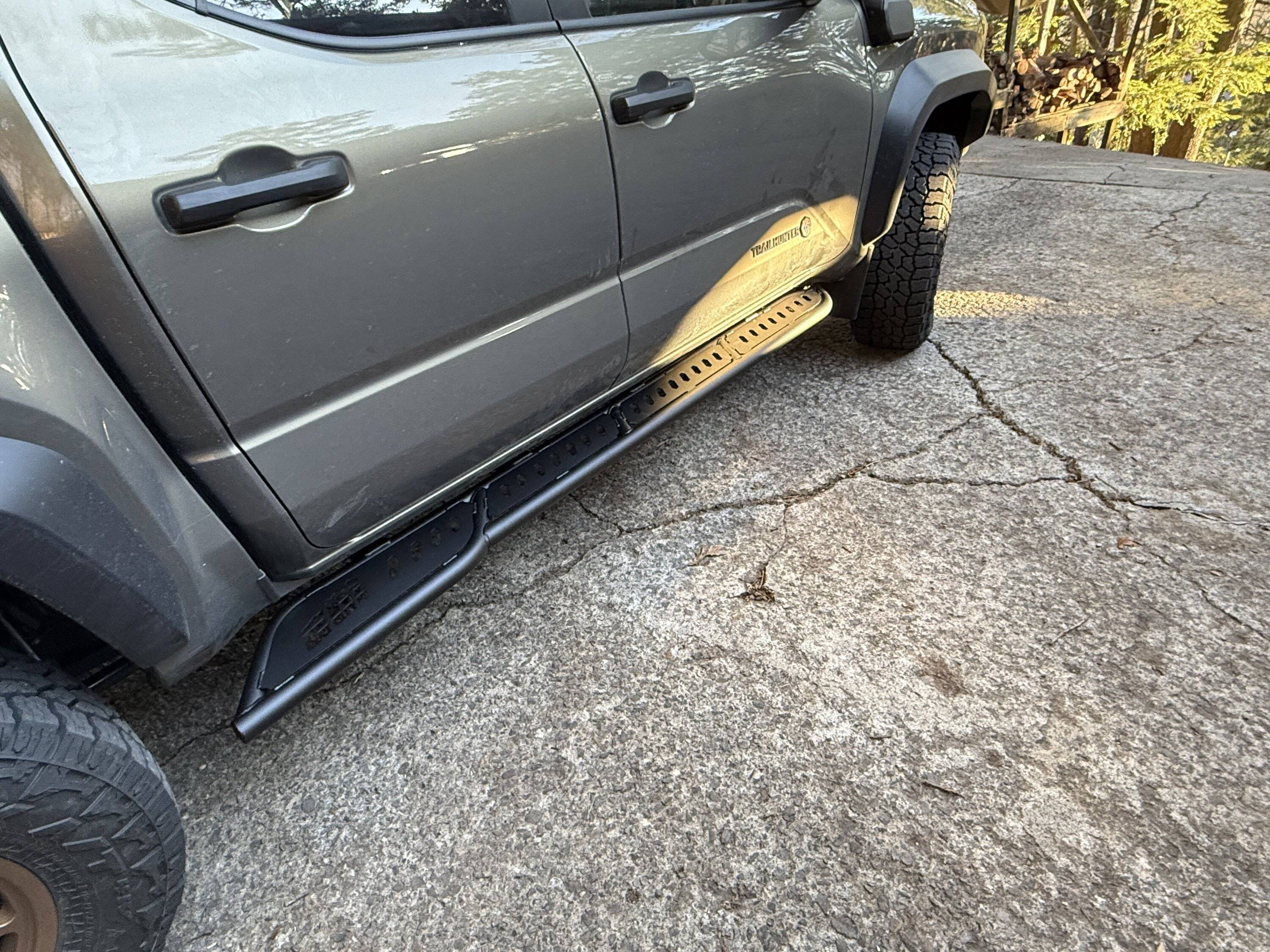

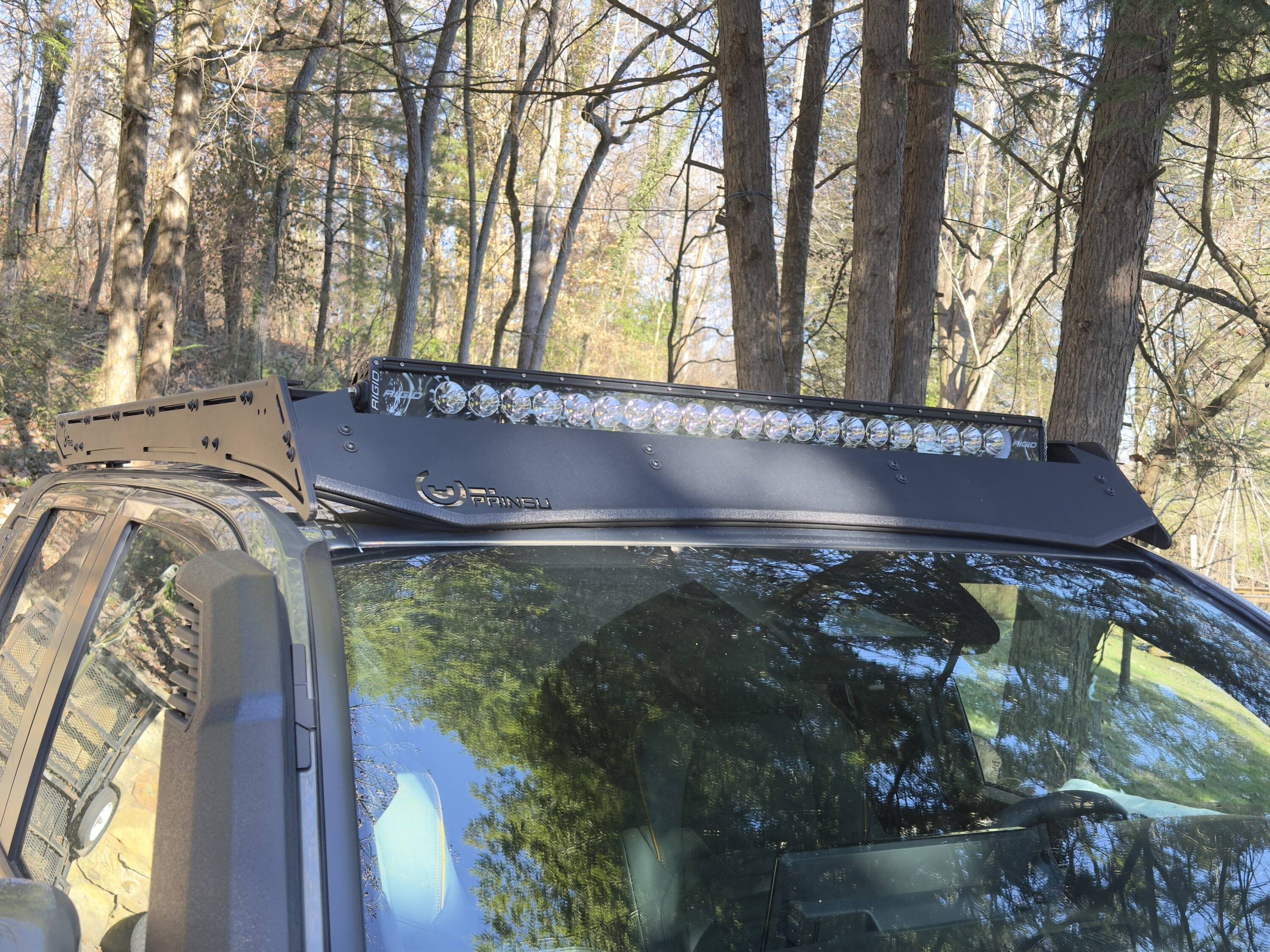

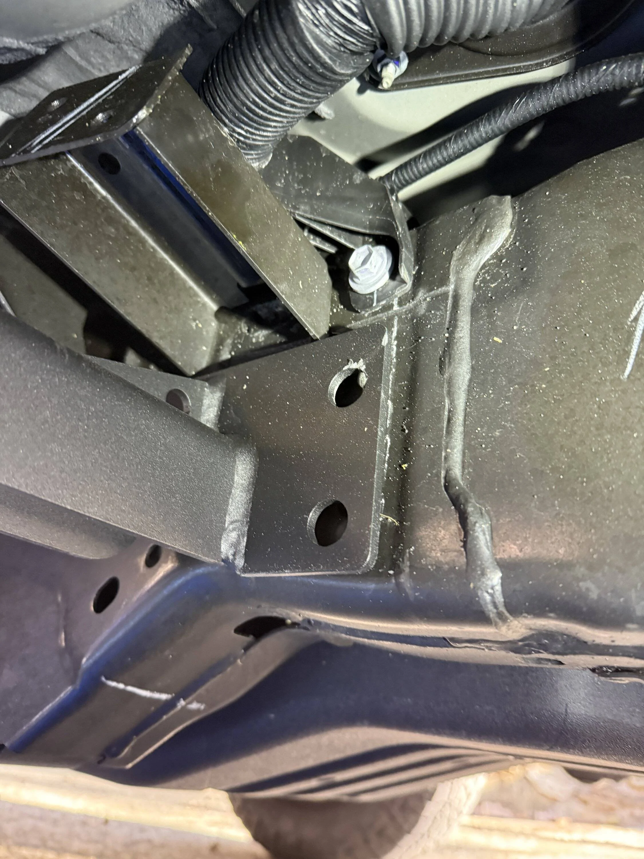

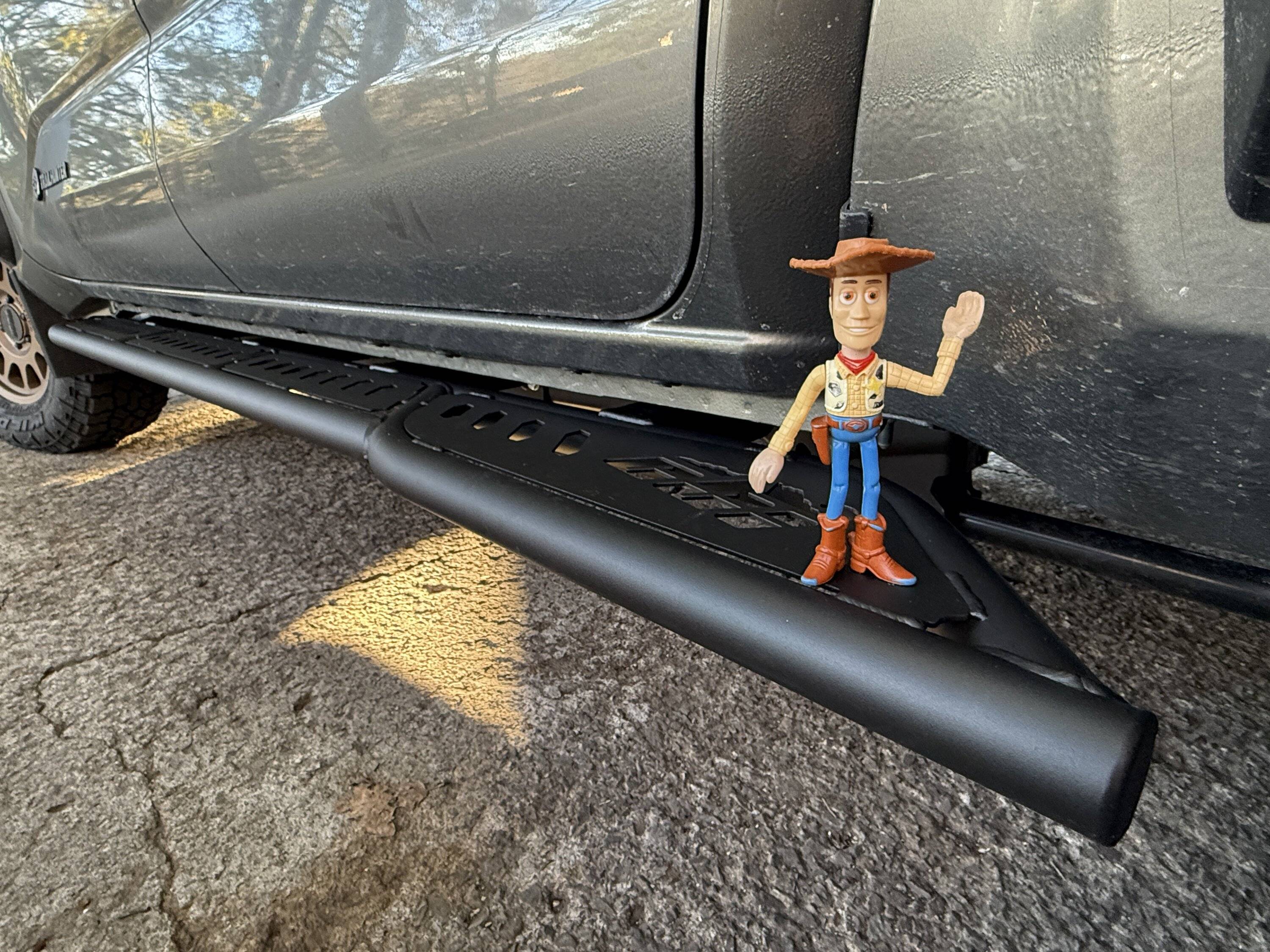

Started the build on my TH with Method 703 Bronze wheels and Falken AT4W tires (285/70/r17). Next took off OEM Rock Rails (no step and not as protective as I wanted) and put on CBI Overland bolt on Rock sliders (powder coat/ DOM/ double cab 5’/ kickouts). Had Asheville Vehicle Outfitters install Prinsu rack with Rigid Light Bar. Waiting for CBI Covert bumper and AluCab Contour canopy to come in. Only difficulty so far was trying to bolt on the Rock Sliders.. Dont know if there is some manufacturing variance, but there was small box hanging off frame in rear that prevented sliders from going into place. Fixed with small 1/3 inch triangle cut out of both sides of box and sliders mounted just fine.
