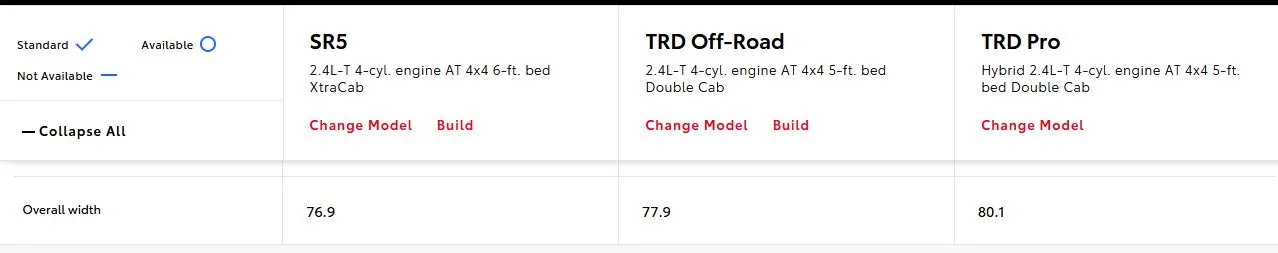

I don't see much speculation on the production look of the flares, given the truck is listed at 80.1" wide, would it be safe to assume it'll probably have the Tundra style clearance lights on the flares, tailgate and the grille? Anyone else thinking the same?

I would think that the flares are going to be exactly what we have already seen in all the preproduction trucks and I do not see any clearance lights.

I am also curious on this. I wanna say before, the width listed for the pro was like 79.6 in wide where the clearance and marker lights wouldn’t have been required. Now seems updated to the 80.1. They may be required now if this spec does stay.

Hopefully we can find more out this month, I'm trying to wait patiently
