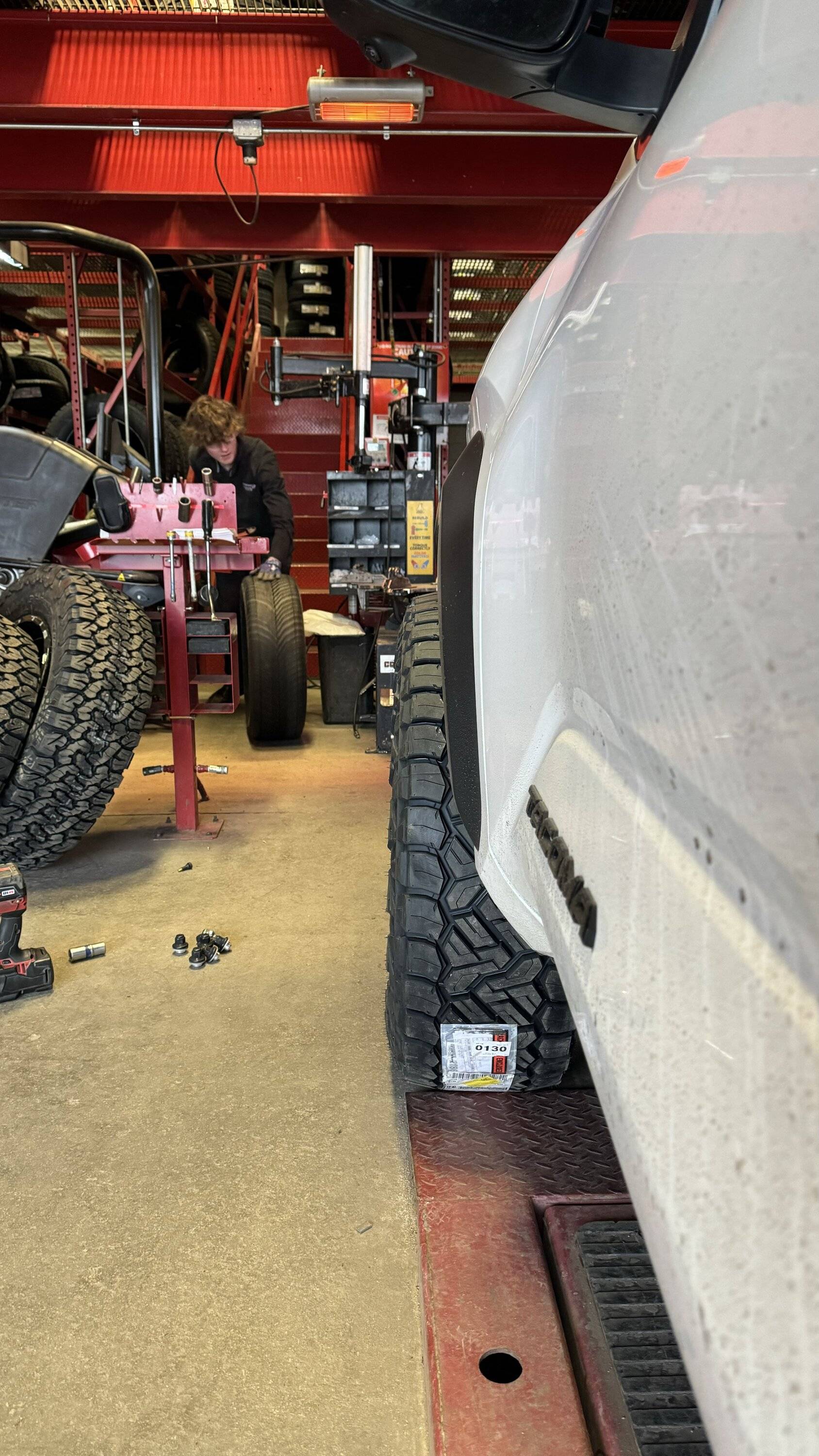

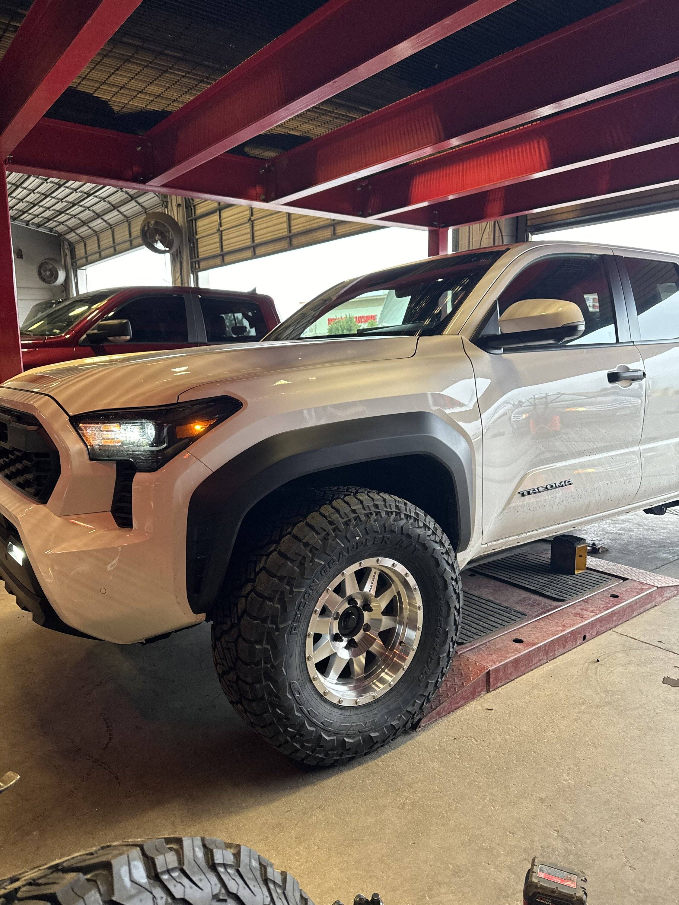

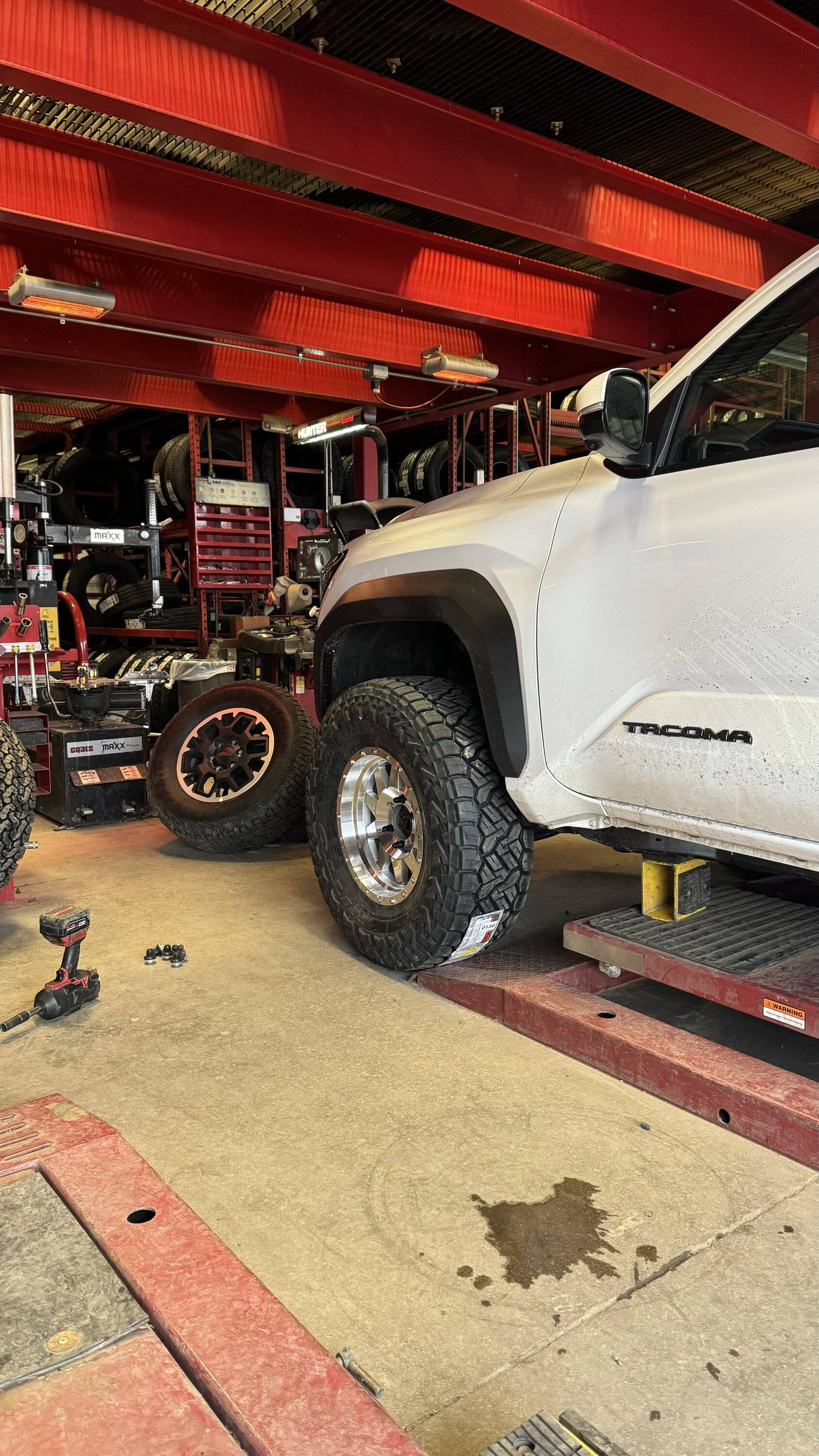

It was at discount tire!! We lifted the truck up to a full 3in lift

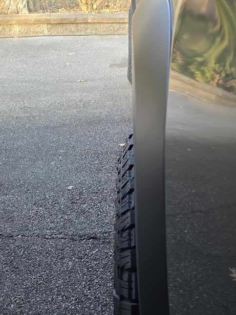

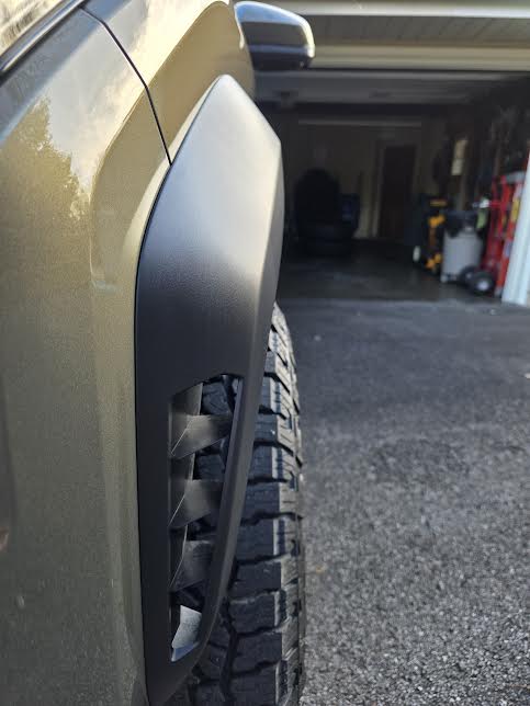

Here are some pictures of a nitto recon grappler 35/12.50R17 with a 17x8.5 0 offset. Stock height, it’s a tight fit but it’s doable, you’d have to remove the bracket from the body mount and trim a tiny bit off the front bumper. (At the very bottom)
