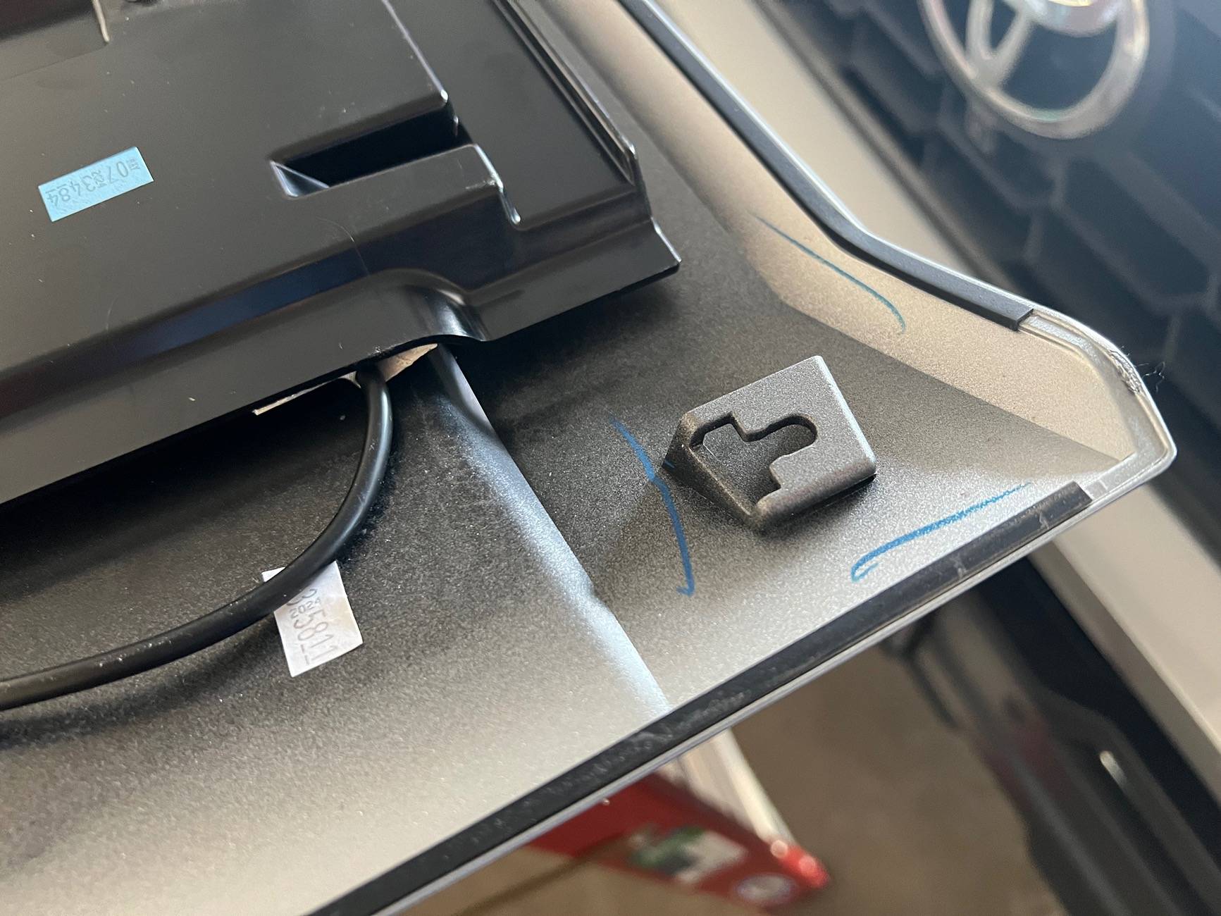

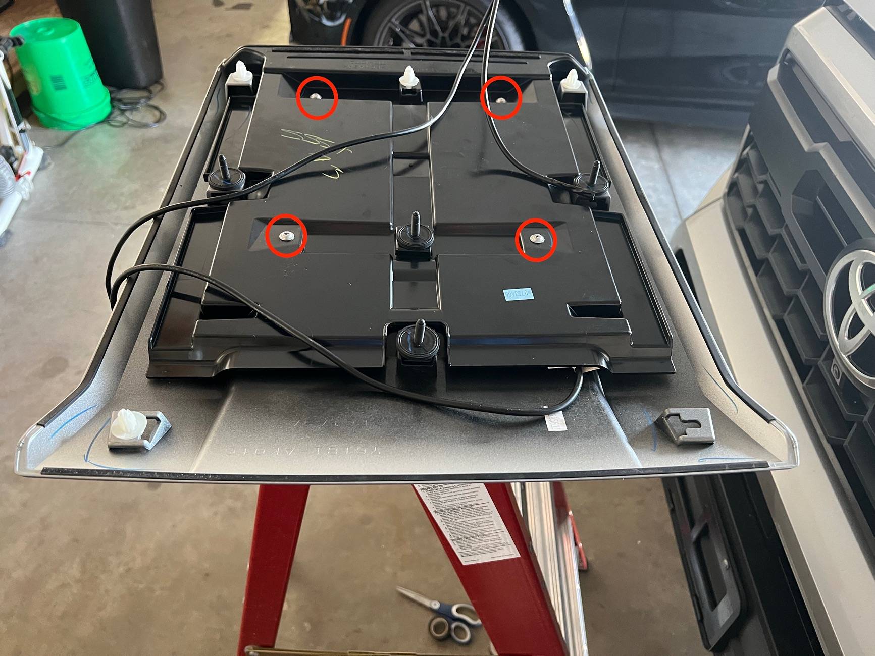

Step 2: You will find 3 bolts under the hood, directly under where the hood scoop is. BUT there is a 4th, directly in line with the one you'll find in the middle, but further back and inset into the hood a bit, along with being hidden by the hoses for the wiper fluid jets. You're gonna want to unbolt that one as well, so 4 in total. Once you have unbolted these, just pull up on the hood scoop and it should pop right off. There are multiple plastic tabs holding the scoop in place as well, but they are not hard to get pulled out.
Step 3: remove the 4 screws in the bottom of the hood scoop, it will allow you to get inside, and separate the painted cover of the hood scoop from the rest of the scoop (ignore the wires, this is a post LED placement picture but wanted to have a picture of what I was talking about)
**Put the painted part somewhere safe as to not damage the paint!**

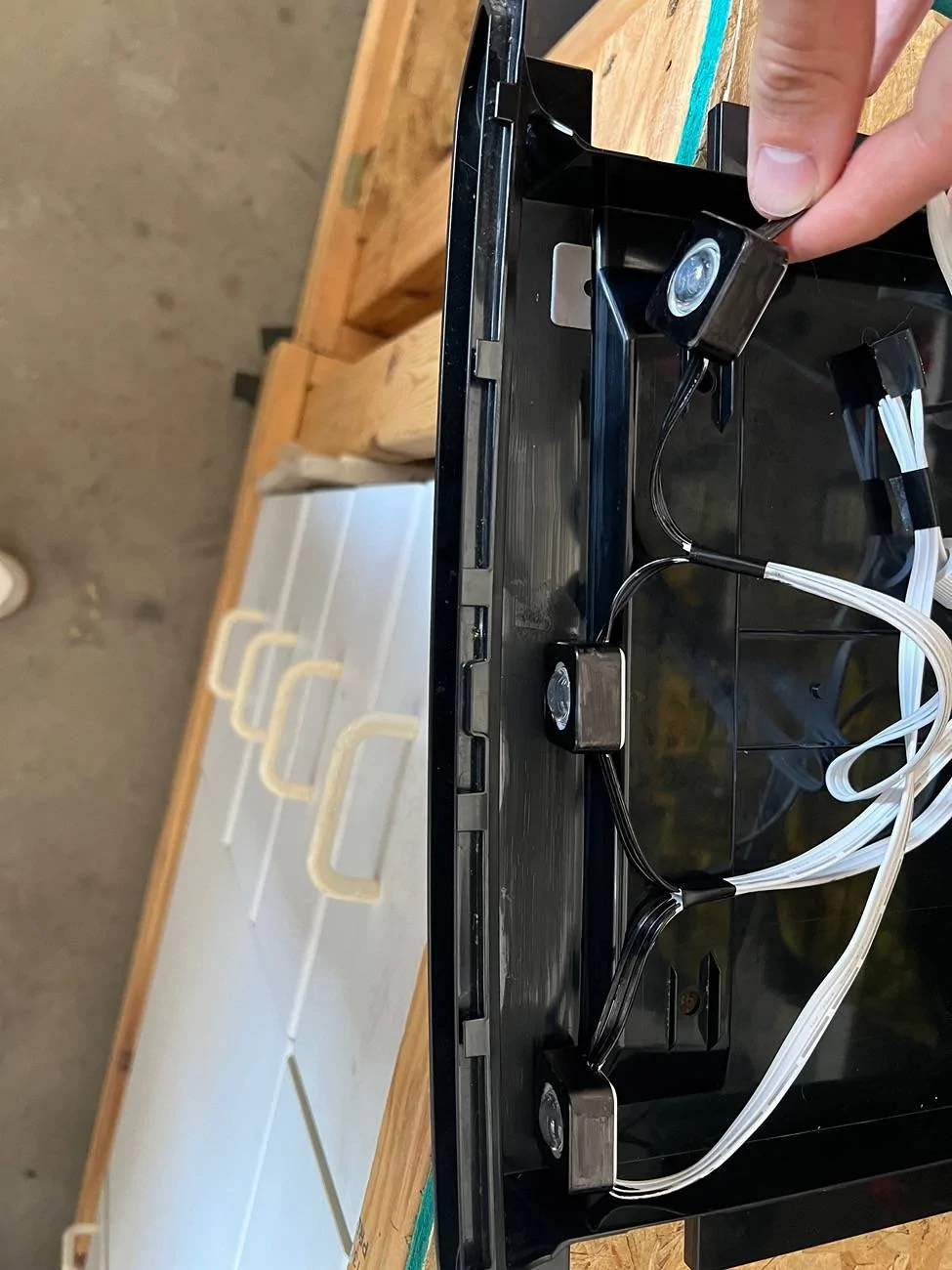

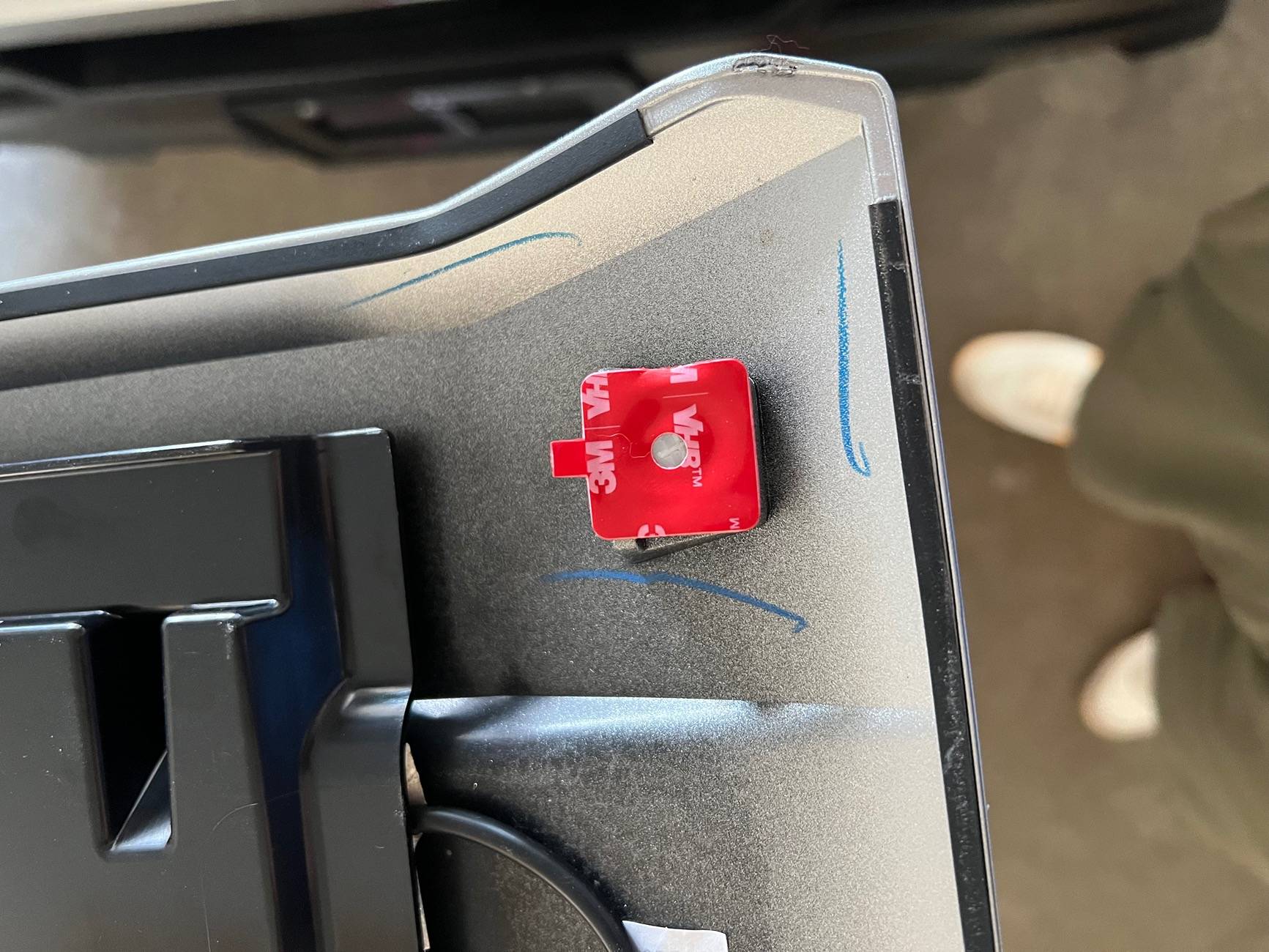

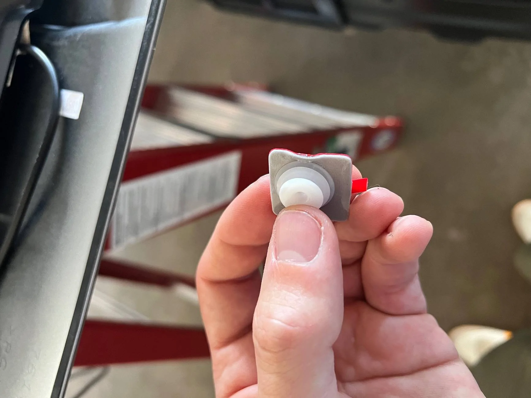

Step 5: Affix the LEDs to the scoop. I decided to use some 3m VHB pads that came with the light to affix 3 of them in the front portion of the scoop. I used a pad on the bottom edge of the light, and another on the top edge. The bottom edge will be adhered directly to the "inside" /black tray portion of the scoop while the top will adhere directly to the painted scoop cover. I then looped the excess wire between the lights, running towards the back of the scoop. To assure that they stayed looped, I used heat shrink tubing to cinch them. I decided to loop the wire rather than cut and splice simply because the wire could be hidden and this would reduce possible points of failure, but splicing would be an option. Side note: I had to color these lights black as they usually come white. It doesn't look amazing by any means but they're hidden in the scoop so it'll be ok. I used a Sharpie Pro (which holds up amazing in weather).

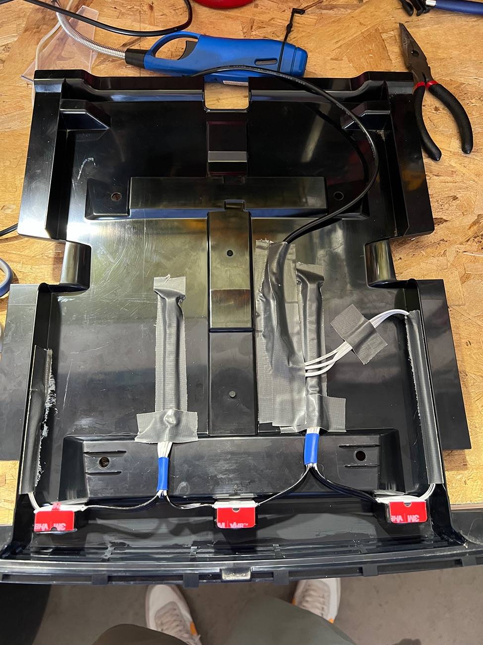

Step 6: I then used 20AWG wire to splice to the end of the LEDs to give me length to run the wire from the hood scoop, down through the hood, and around the engine bay to the power source. Then I secured the loose wires. I used "T-Rex Extreme Hold AllWeather Mounting Tape" to do so. I have used this on multiple other projects that have to endure the elements and it works very well. In the picture above you can see, on the left hand side, the amount of adhesive on this stuff as I barely had it brush the bottom part of the scoop tray as I was pushing it up against the tray wall.
Step 7: Put the cover back onto the tray portion of the scoop. Button it all up and make sure everything is seated and LEDs are staying where you want them and the wire to your power source is existing the scoop where you want it. I ran mine out of the back driver side corner. Then put the 4 screws you removed earlier back in (refer back to 1st picture)

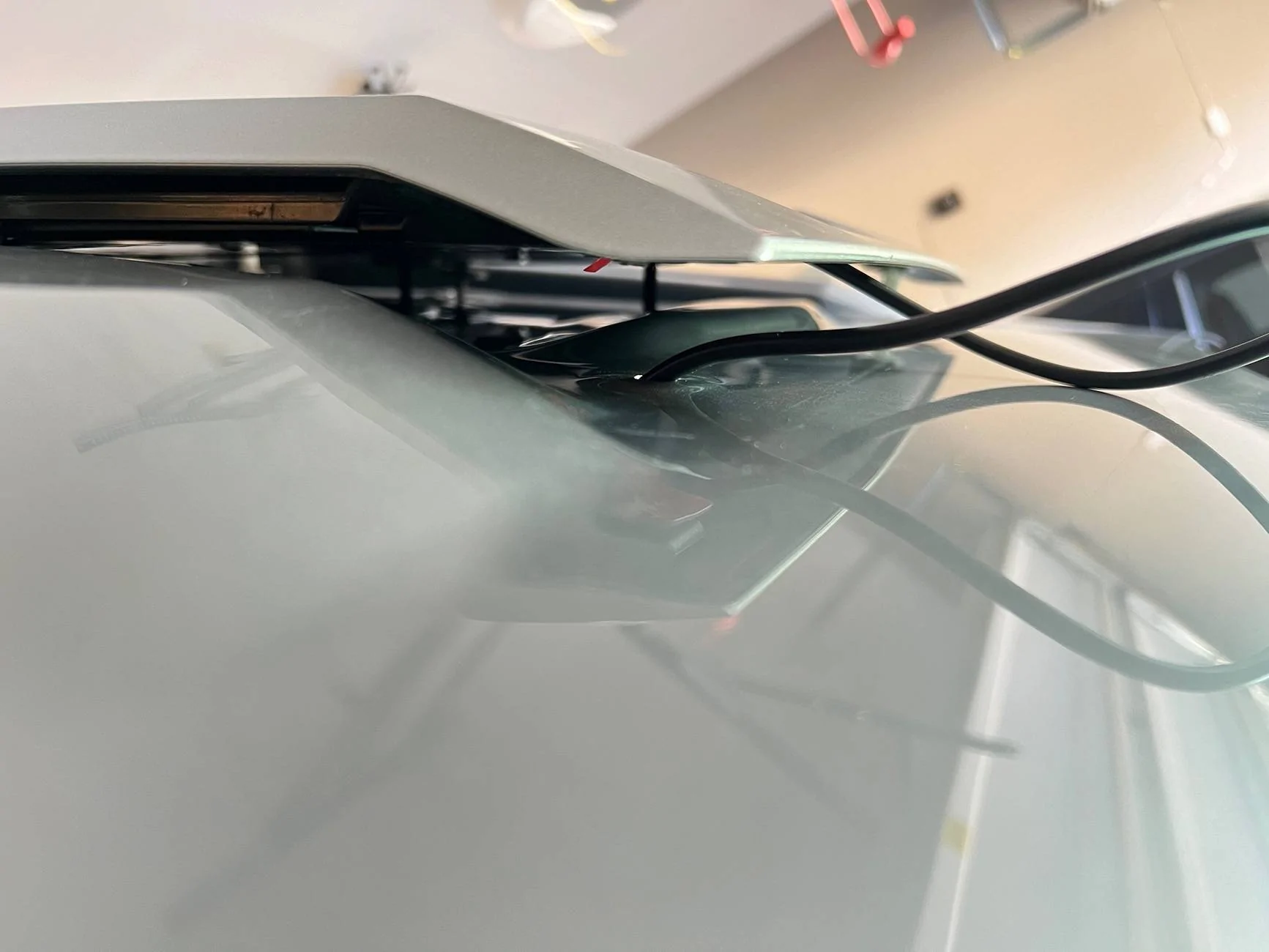

Step 8: Run the wire to the bottom side of the hood through whichever hole will work best for you. It is possible to add an additional hole in the hood, but I was too scared to do so. I just removed the back driver side plastic plug that holds that corner to the hood and ran the cable through that. I originally cut the "plug portion" of that plastic plug off and placed 3m tape on the bottom, hoping that it would just adhere to the hood over the wire. There are pictures below, but this didn't work as well as I had hoped so I pulled the plug back off. I am currently not running anything in that corner to hold the scoop and haven't had any issues. Fish the wire out of the nearest opening in the bottom of the hood, then place the scoop back on.

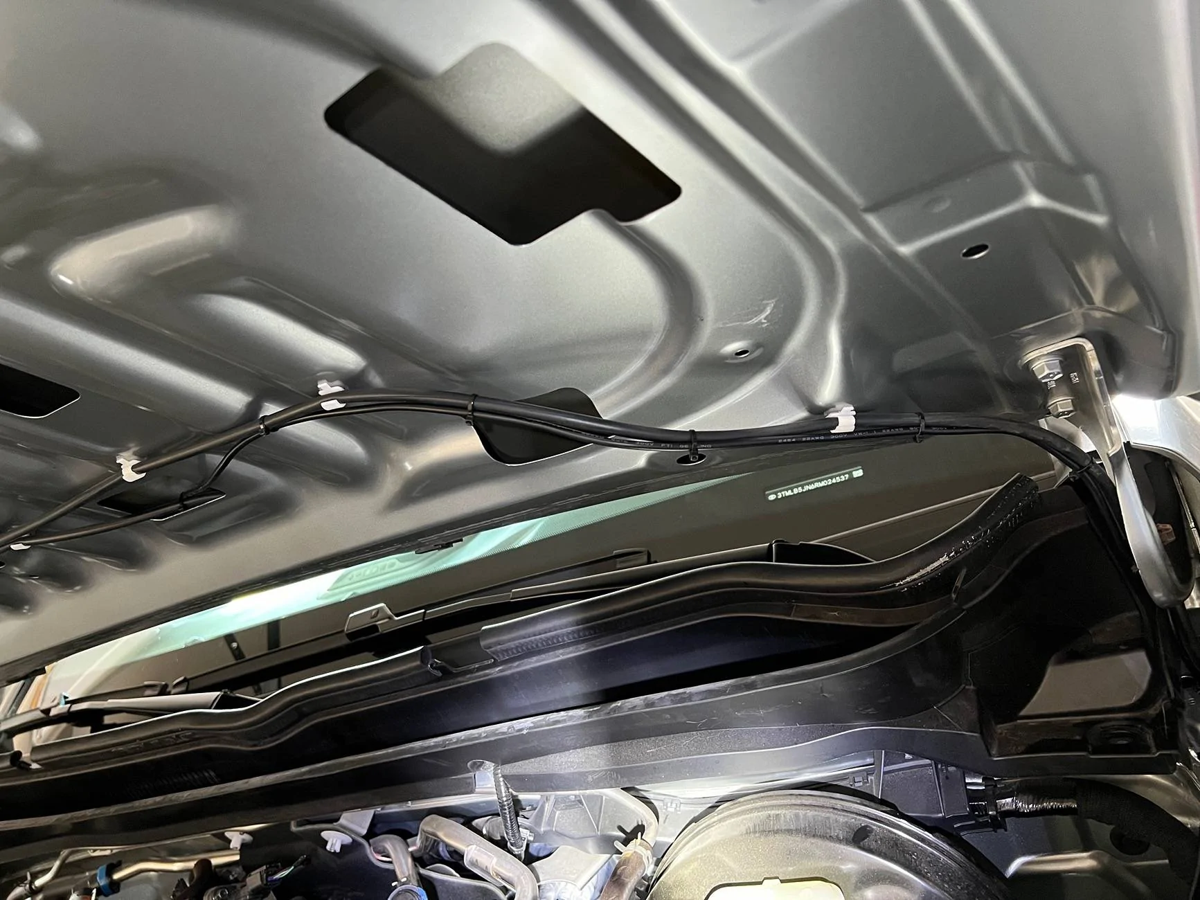

Step 9: Secure the wire to the route you need it to take. I used zip ties to run it parallel to the windshield wiper fluid lines.

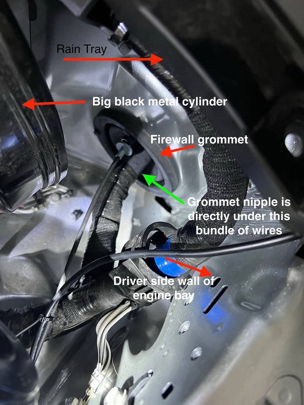

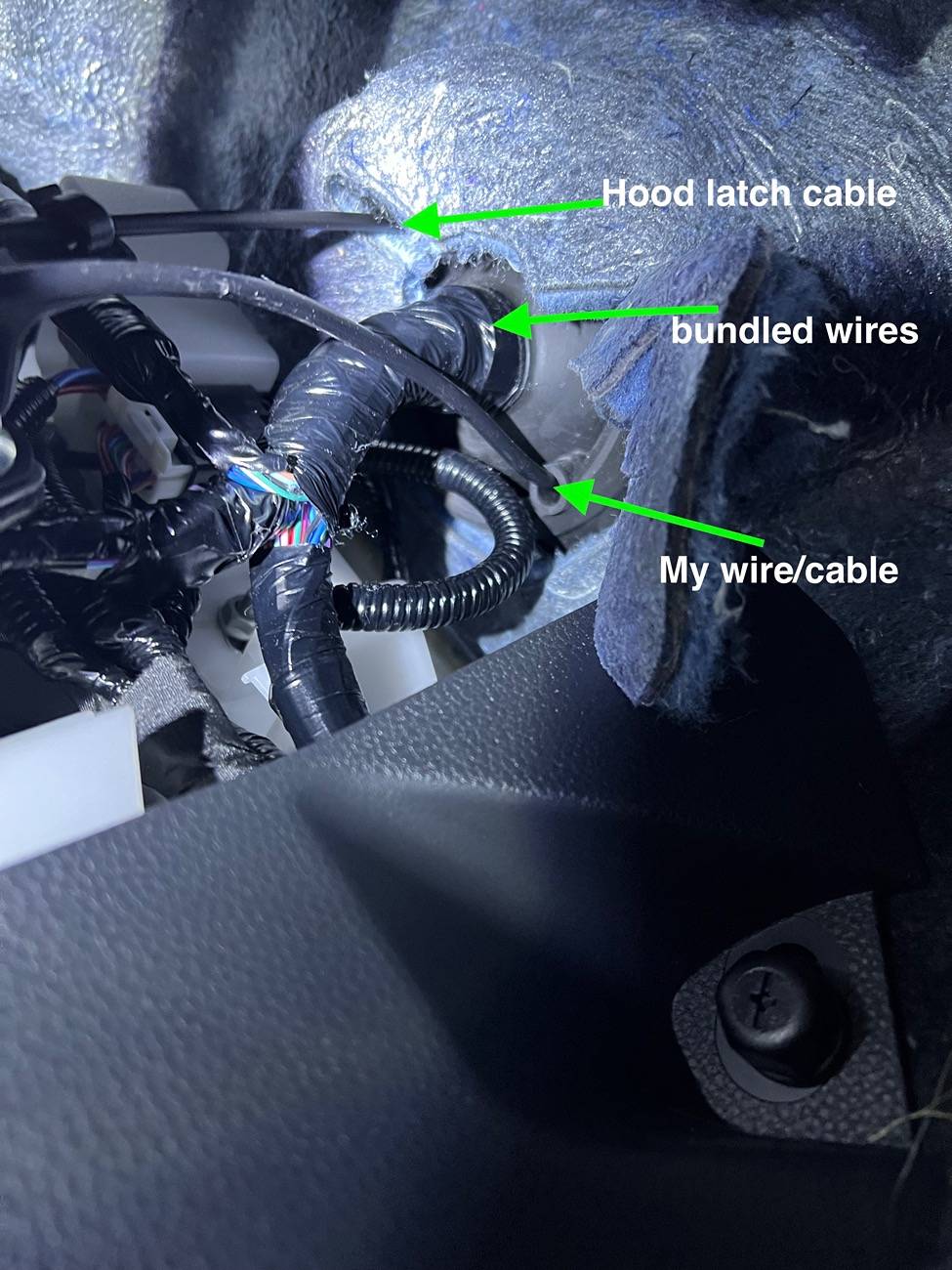

Step 11: Run the wire through the firewall of the truck. There are multiple places one can do this, I chose the driver side as I could easily get access from the inside from the footwell. There is a large grommet fairly low in the engine bay with a nice thick bundle of wire coming out of the middle, and a smaller cable coming out on top, with a little blue stopper on it (I believe it's the hood latch cable). Under the thicker bundle is a little nipple similar to the one the hood latch cable is coming out of, but it's domed over - ie not open into the cabin of the truck. Cut the tip off and you now have a passage through the fire wall (there is a little line about a quarter of an inch from the tip that appears to be an indicator of where it needs to be cut to be used). Run your wire through that passage.
2024 Tacoma Hood Scoop LED Lights -- DIY install how-to (instructions w/ photos) IMG_4104

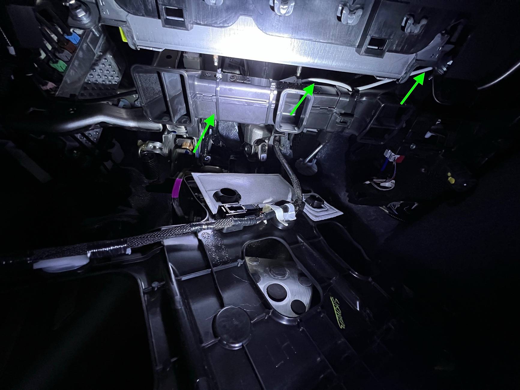

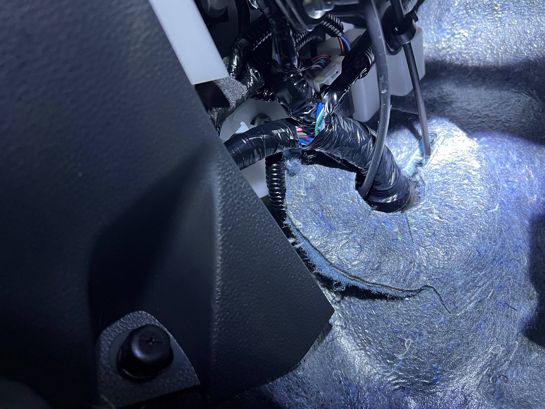

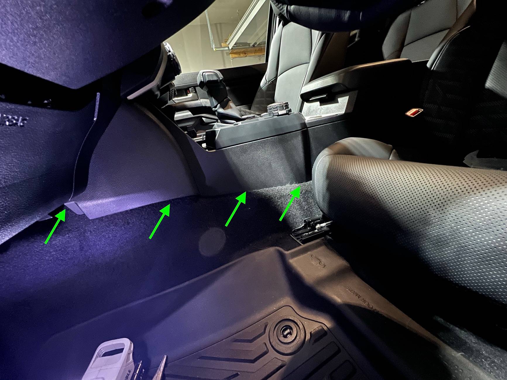

Step 12: Locate the wire in the driver side footwell. There is padding that will be covering where the wire comes through, it is already cut and loose, then just pushed over the grommet. Just pull it back and you should see your wire. Pull your wire through. There is another auxiliary port just to the left of where this grommet is, inside the cabin. This is another option for the power source (again refer to the manual for exact location).
2024 Tacoma Hood Scoop LED Lights -- DIY install how-to (instructions w/ photos) IMG_4127
2024 Tacoma Hood Scoop LED Lights -- DIY install how-to (instructions w/ photos) IMG_4128

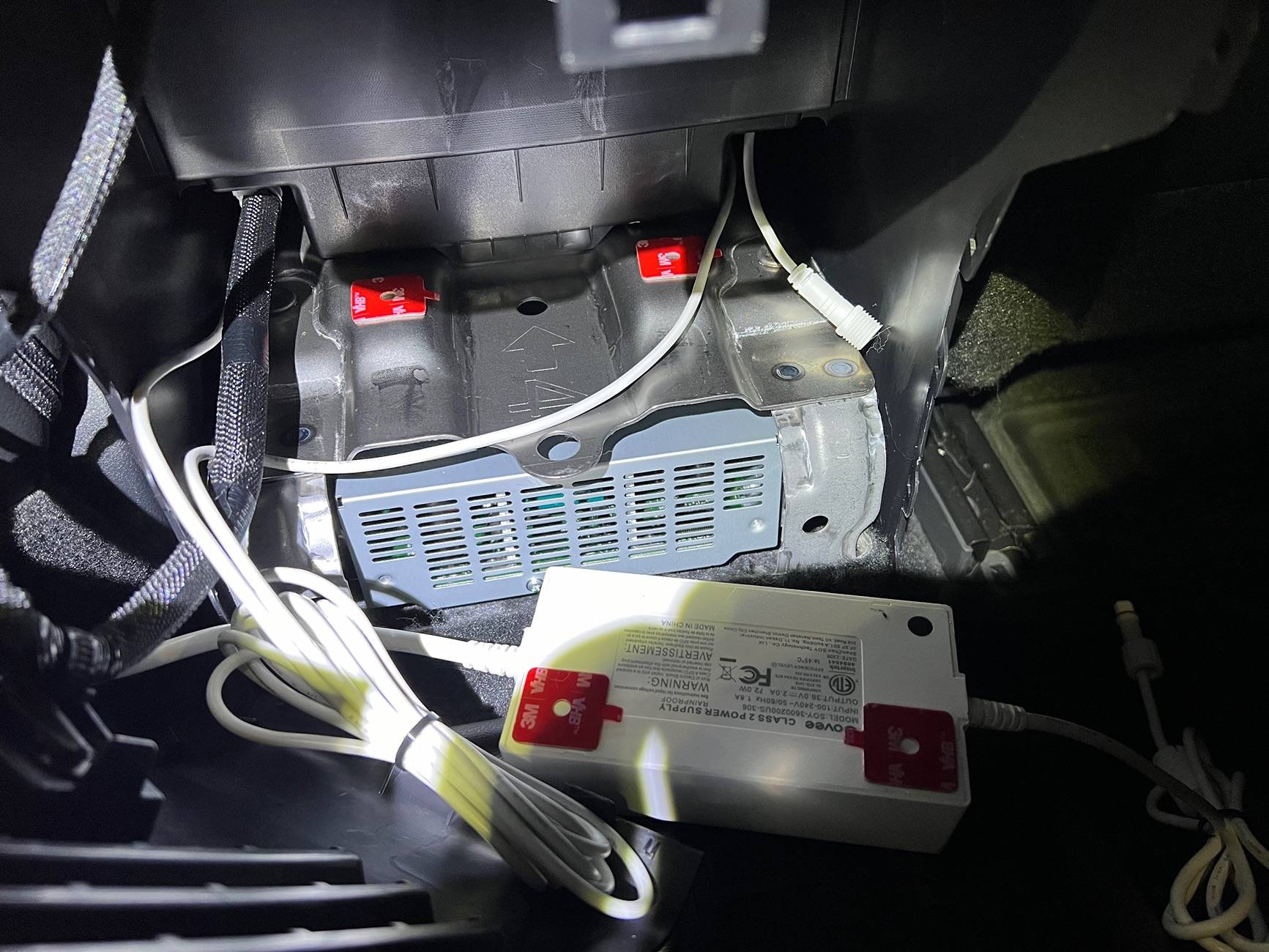

This is where I began to tear the interior of the truck apart trying to find a good spot for an inverter... I couldn't find one. The only reasonable place, out of site, was under the back seat, but would have required running a lot of extension cable from the pigtail to the inverter for power, which seemed to defeat the purpose of these pre installed power sources. So, I decided to ditch the inverter and use the existing 120v power supply that Toyota kindly provided behind the center console.
Step 13: Remove the dash piece from under the steering wheel, in the driver side footwell, and run your cable towards the center of the truck (at this point I had to splice the power plug onto the end of my cable as it has a very specific plug that connects into the controller for the lights, which in turn has a specific plug to connect into the power box needed for the lights). I ran my cable along the A/C duct and zip tied it, then tucked the cable under the edge of the center console to the rear of the vehicle
2024 Tacoma Hood Scoop LED Lights -- DIY install how-to (instructions w/ photos) IMG_4129
2024 Tacoma Hood Scoop LED Lights -- DIY install how-to (instructions w/ photos) IMG_4131

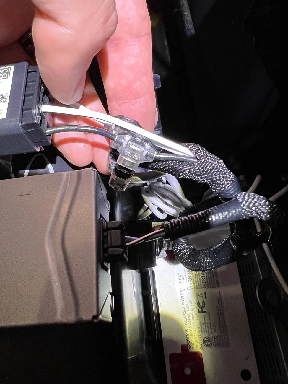

Step 14: Disconnect your battery! You will now be working with wires that may have electricity running through them. To access the 120V cables, pop the housing off the back of the center console. Locate the wires going to the 120v plug. Tap in to these. I used inline T-taps to prevent having to cut the actual existing wires, and make it easy to put back to OEM if I decide to ever get rid of the set up. I then bundles the excess cable with zip ties, and affixed the power block with more 3m VHB pads. Then affixed my extractable bundle to the existing cable bundle, and put the cover back on (if pops off pretty easily). I also ran some cable from the controller that's mounted in the center console storage but that's not really pertinent to the overall process for most people.

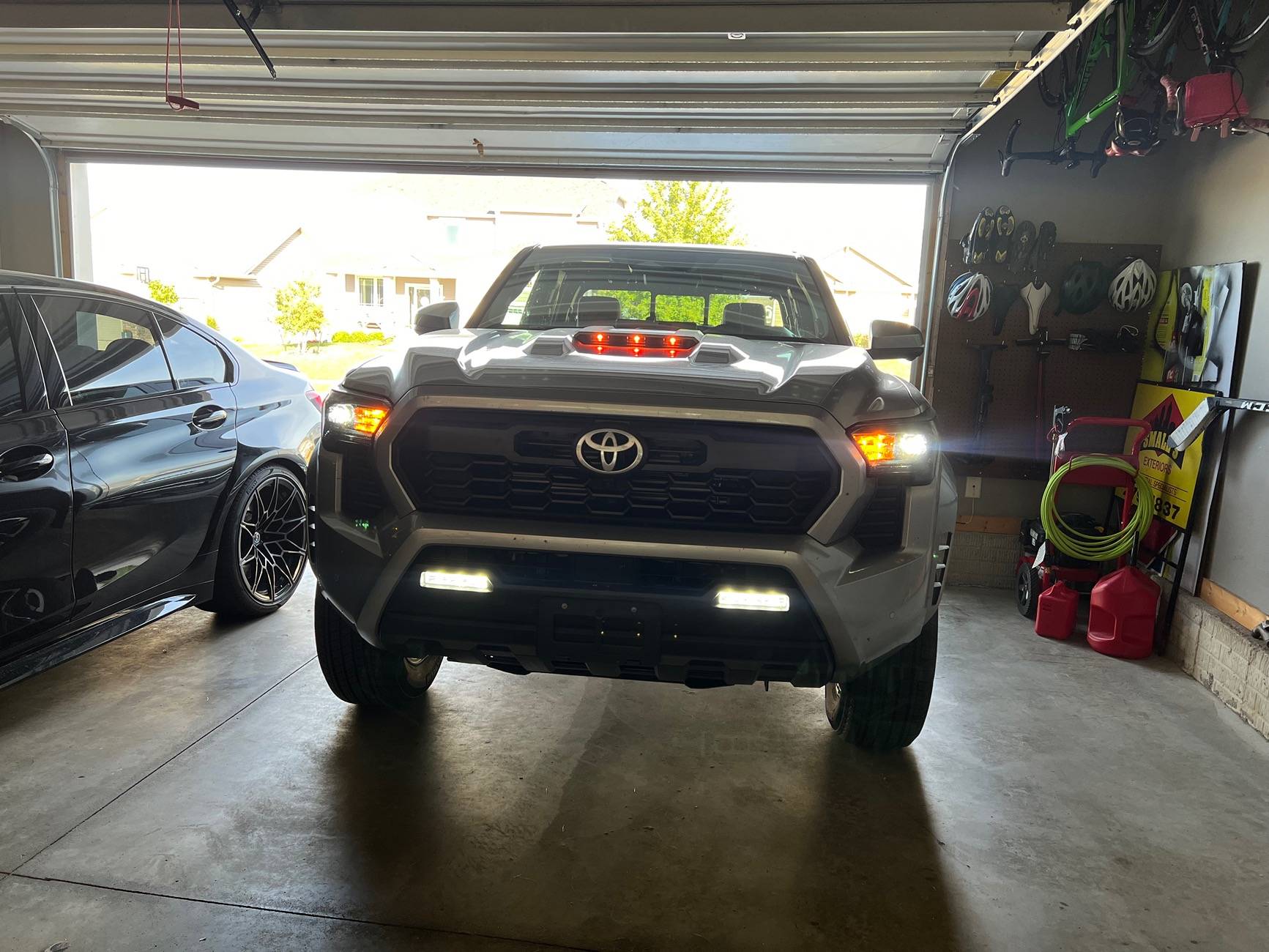

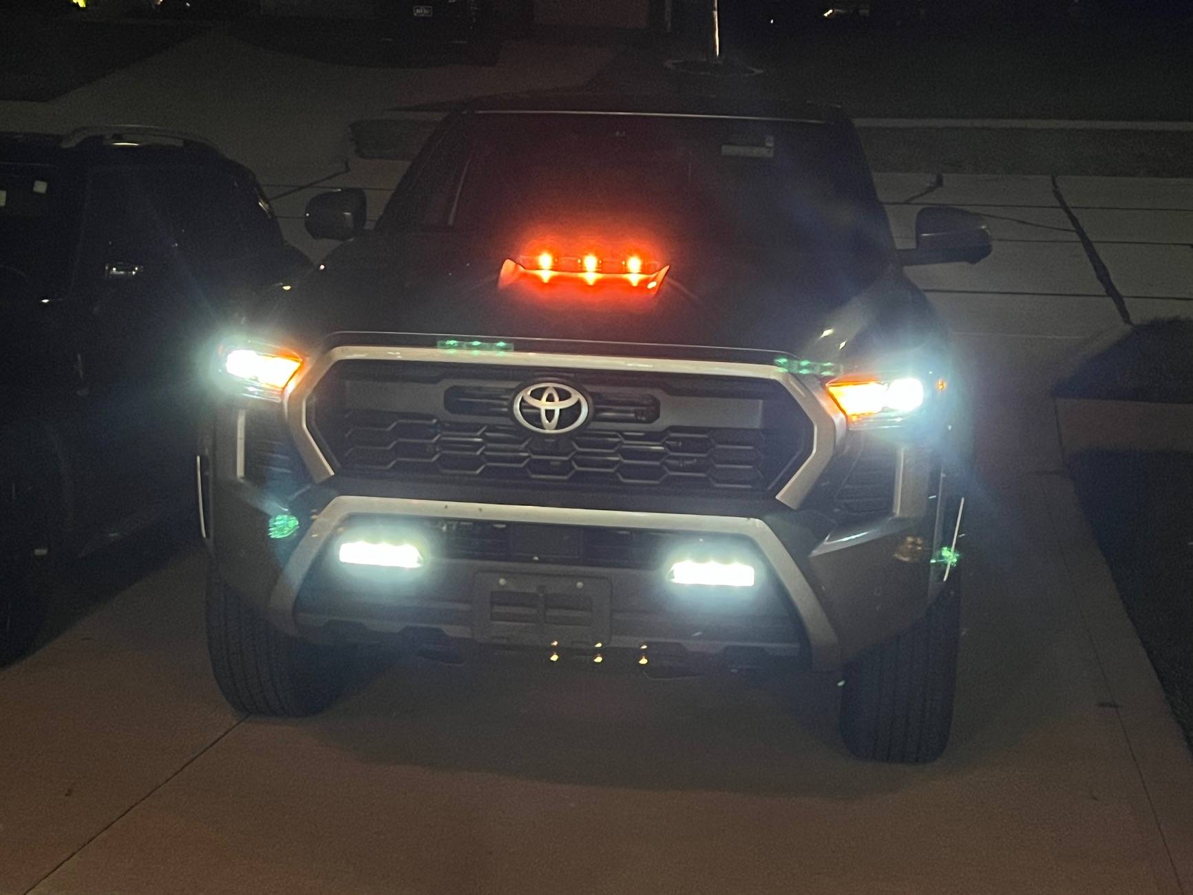

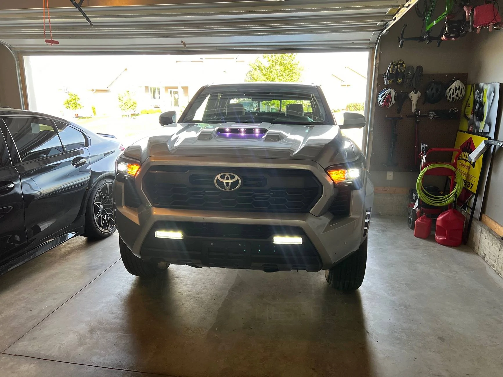

Step 16: Enjoy the fruits of your labor
I will have to snap some better night pictures, and probably day as well, but it gives an idea of what it looks like. The colors match the white and orange of the stock lights much better than what the pictures would lead you to believe, I think them being angled differently and at different heights is throwing the camera off. Overall I am very happy with the results, the only downside of this route (using the 120V power source) is the button has to be turned on manually every time I get into the vehicle. Not a big issue, but the auxiliary stay on until turned off which is nice.
