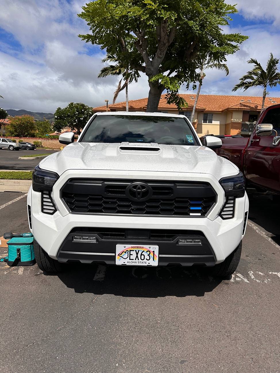

This is how I originally did the install. Tried to upload video but was too long. I rerouted the red wire to the ign fuse with add a fuse. It works perfect.
2024 Tacoma Fang Lights LED installation on 2024 Tacoma Sport IMG_2995
2024 Tacoma Fang Lights LED installation on 2024 Tacoma Sport IMG_2894
Looks clean and fierce! I wonder how many Tacos in Hawaii will start installing these fang lights to their 4G? You might start a trend on the big island... ;)

I only know of one other guy on Oahu that has this on his oxide color truck.

What brand fang light did you install? Looks great!
UPDATE: this pic/video was testing phase. Attach black wire (ground) to engine frame, red (power)to ign fuse in fuse box with add a fuse 10amp, yellow (turn signal)tap into beige/pink wire(driver side) blue on passenger side) and white tape off not necessary.

What was your trick to get the old fake vent covers off?
