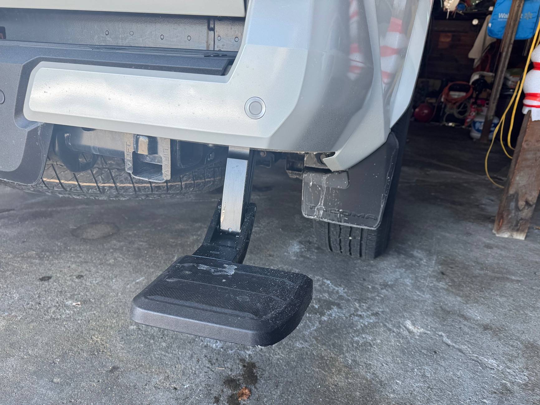

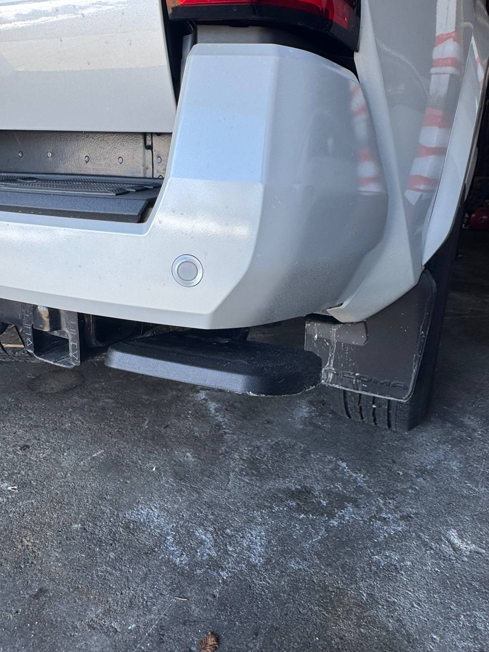

got my tailgate matt installed while i was there , looks great

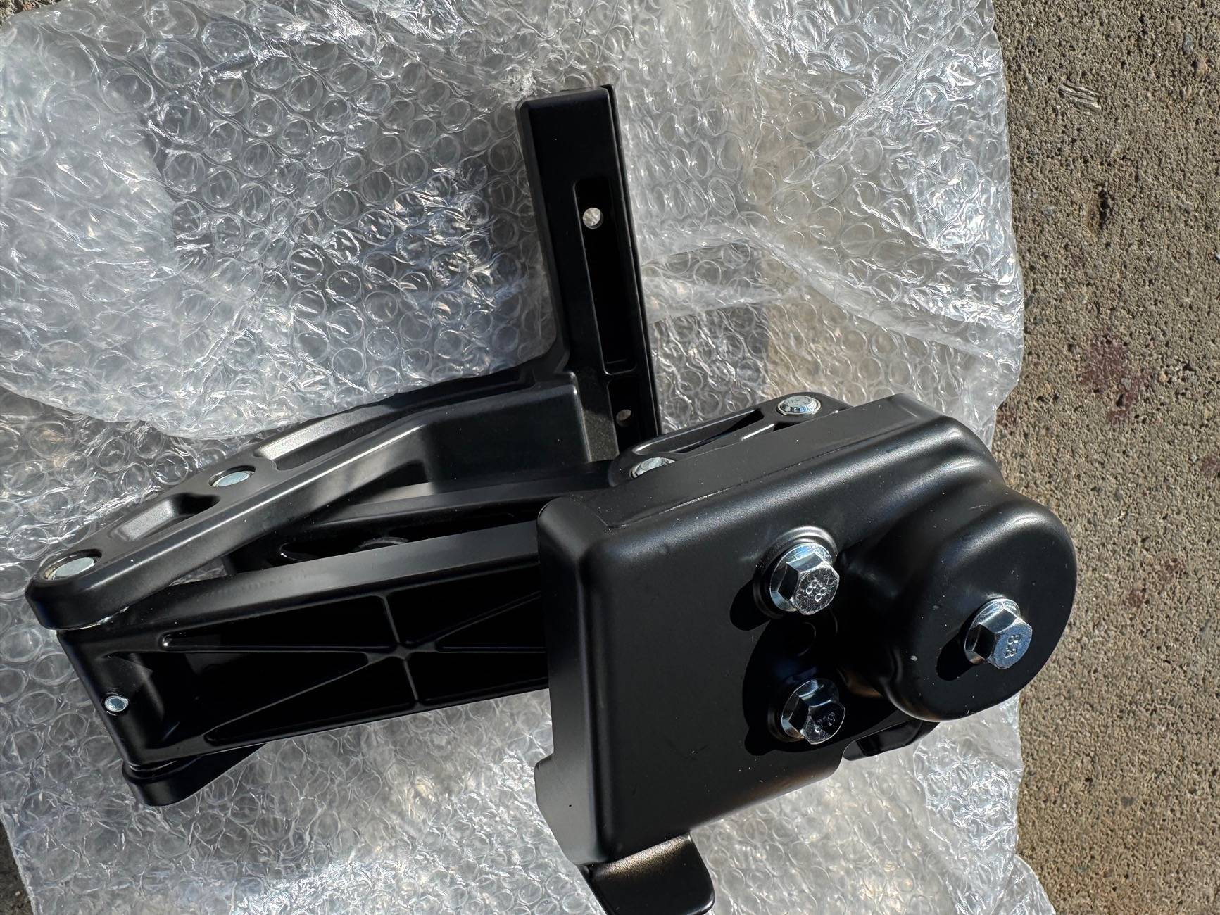

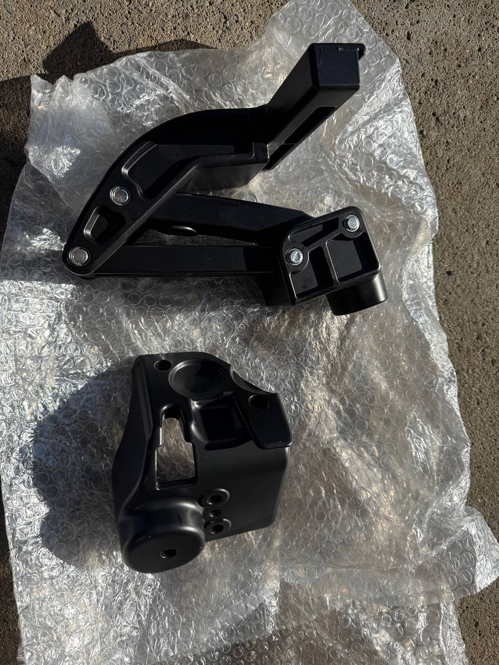

They baked too much paint in the threads. Borrowed a friend's m10 1.25 tap and die and it took maybe 5 minutes to fix the hole and bolt and 5 minutes to do the actual install.

Tried to install mine tonight. Need to go buy a tap and die set, one of the frame holes isn't fully threaded 😅.
There's probably paint in the hole. You definitely DON'T want to tap that hole... It will cut away some metal with the paint. You need a thread chaser.
