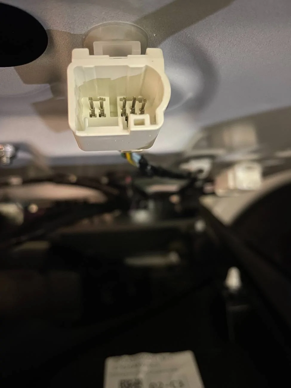

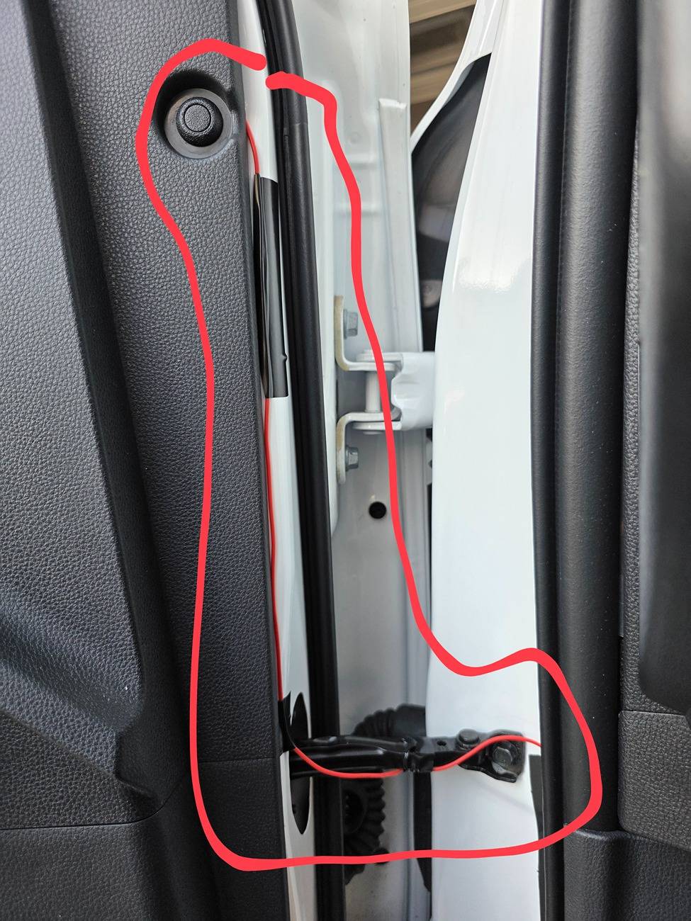

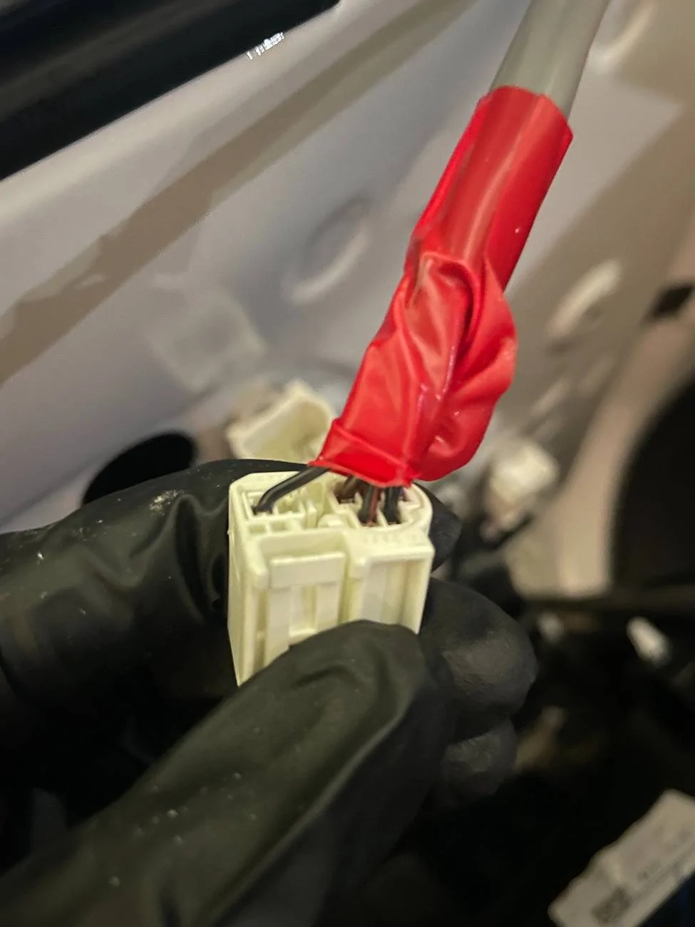

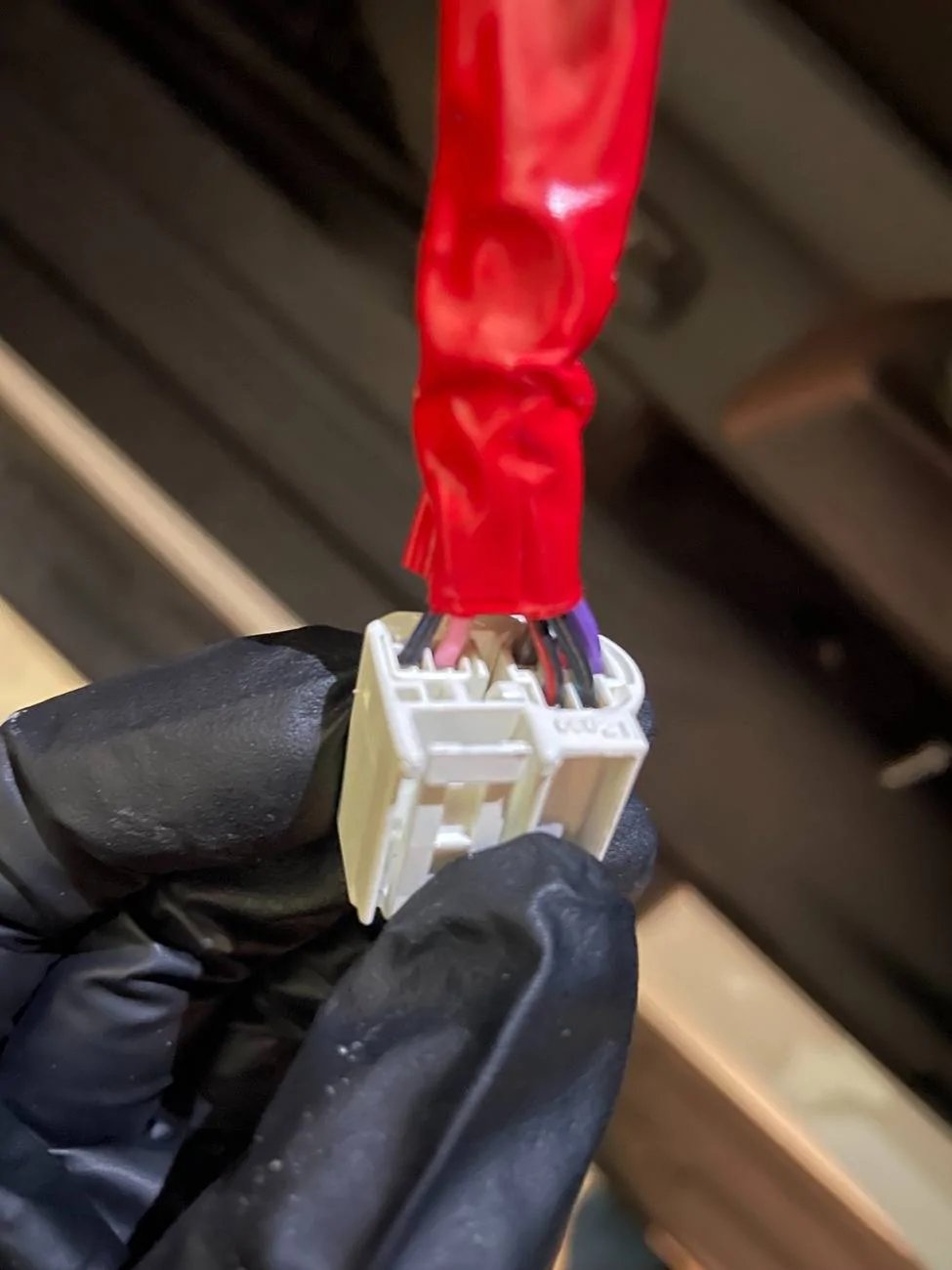

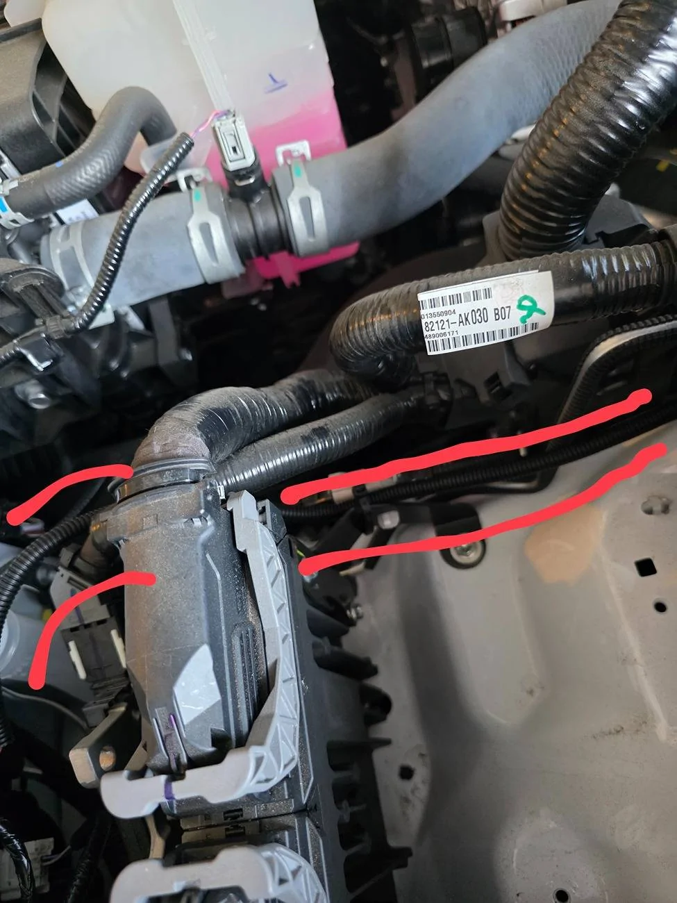

I recently received an order of OEM integrated turn signal mirrors hoping they would be plug and play for my SR5 but they are not. It does look like the wire for the turn signal is already there in the door harness (pink next to black on the mirror assembly, sky blue next to black/white on the door harness. Pic of original SR5 mirror assembly plug included to show the missing pink wire) but when I plug them in they don't light up. I've tried both sides in case of a faulty mirror assembly but no dice. After doing some googles it doesn't seem like there is a missing separate fuse or anything for integrated turn signals in either the cabin or engine boxes.
I came across a few YouTube/forum posts about 3G owners trying to do this and finding that their door harnesses were not prewired for the turn signals. Those folks tapped into the front turn signal lamps. Given that all the pins/wires are present in the 4G SR5 harness, I am hoping that this is a different situation and that an easier/cleaner solution will present itself. I haven't been able to find any success stories online (please ridicule and forgive me if I am missing a post from this forum).
I am as ignorant and inexperienced as they come when it comes to cars/electronics so I'm a bit stuck on where to look next. Any advice would be greatly appreciated. Thank you very much for your time!
