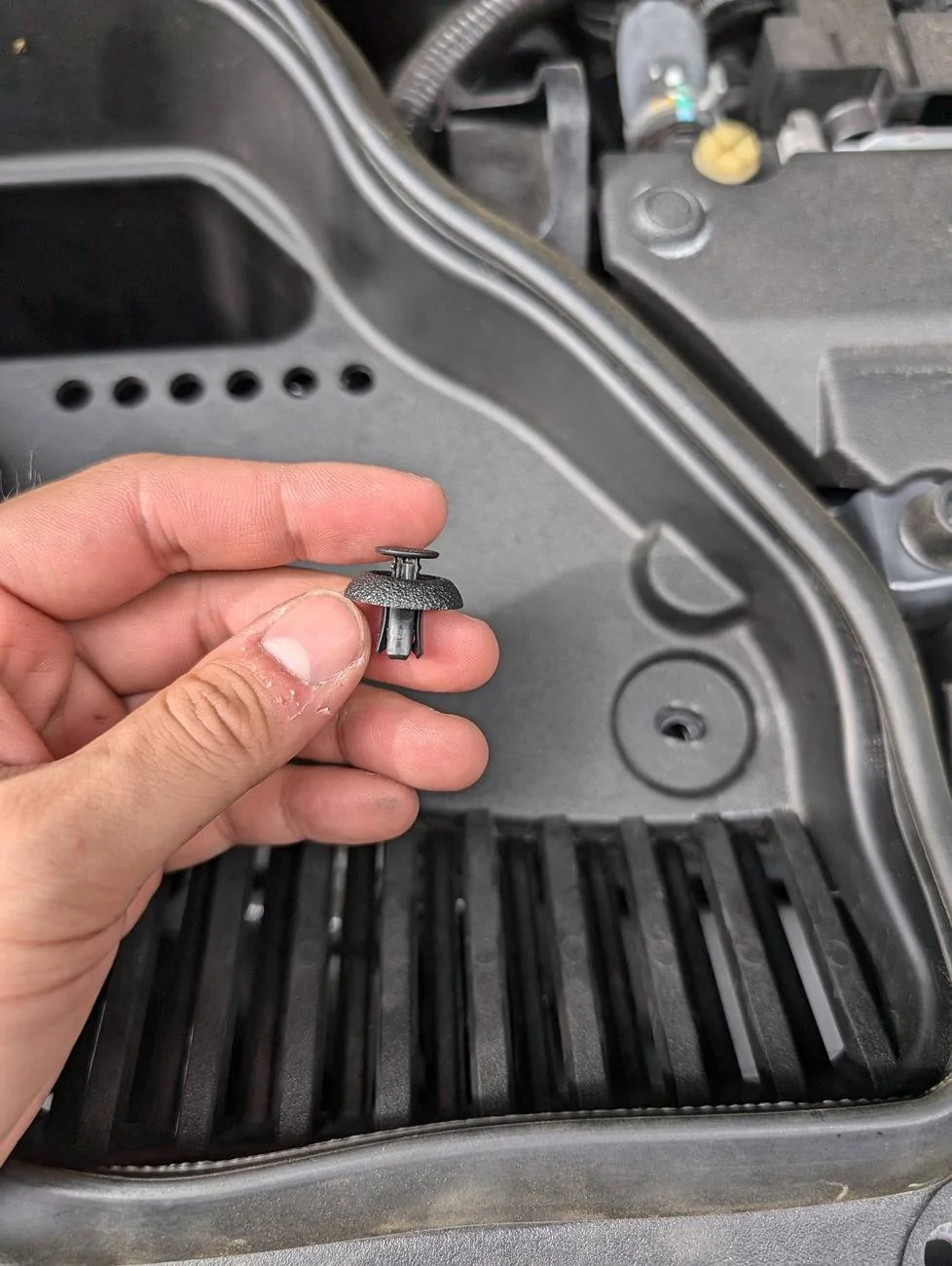

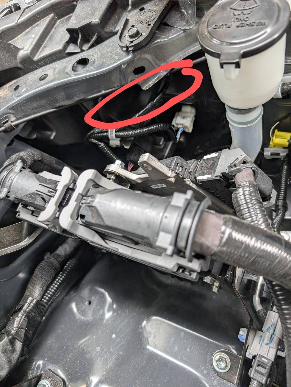

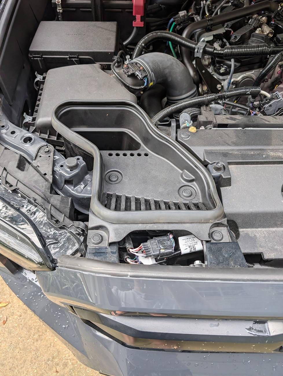

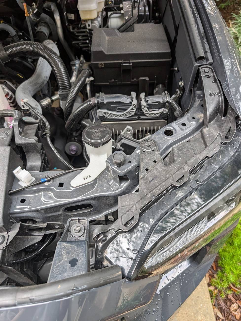

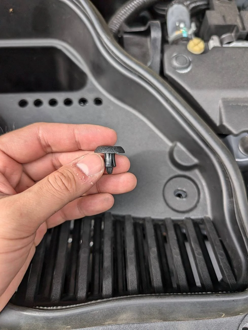

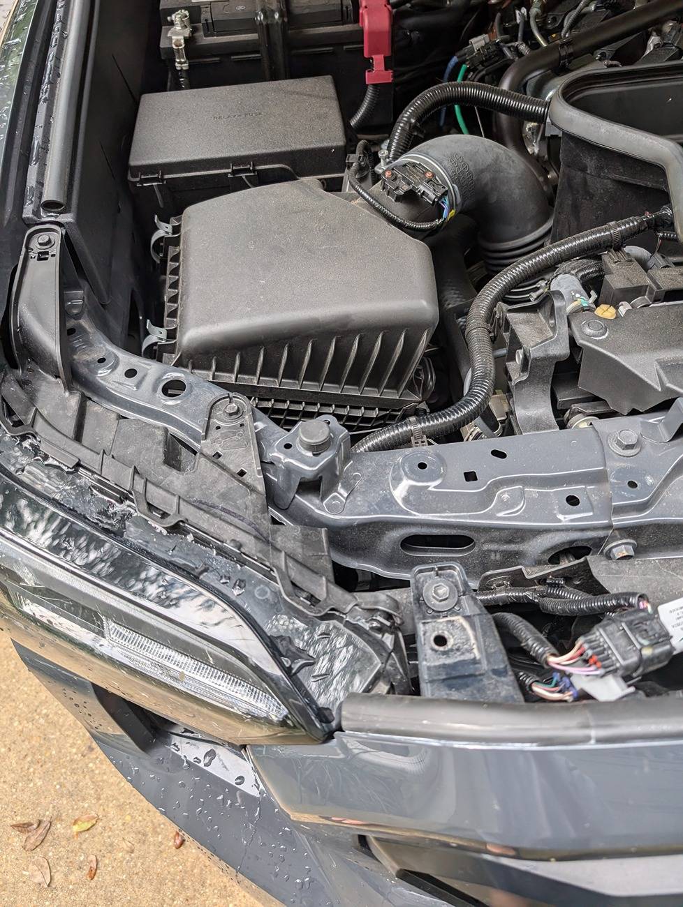

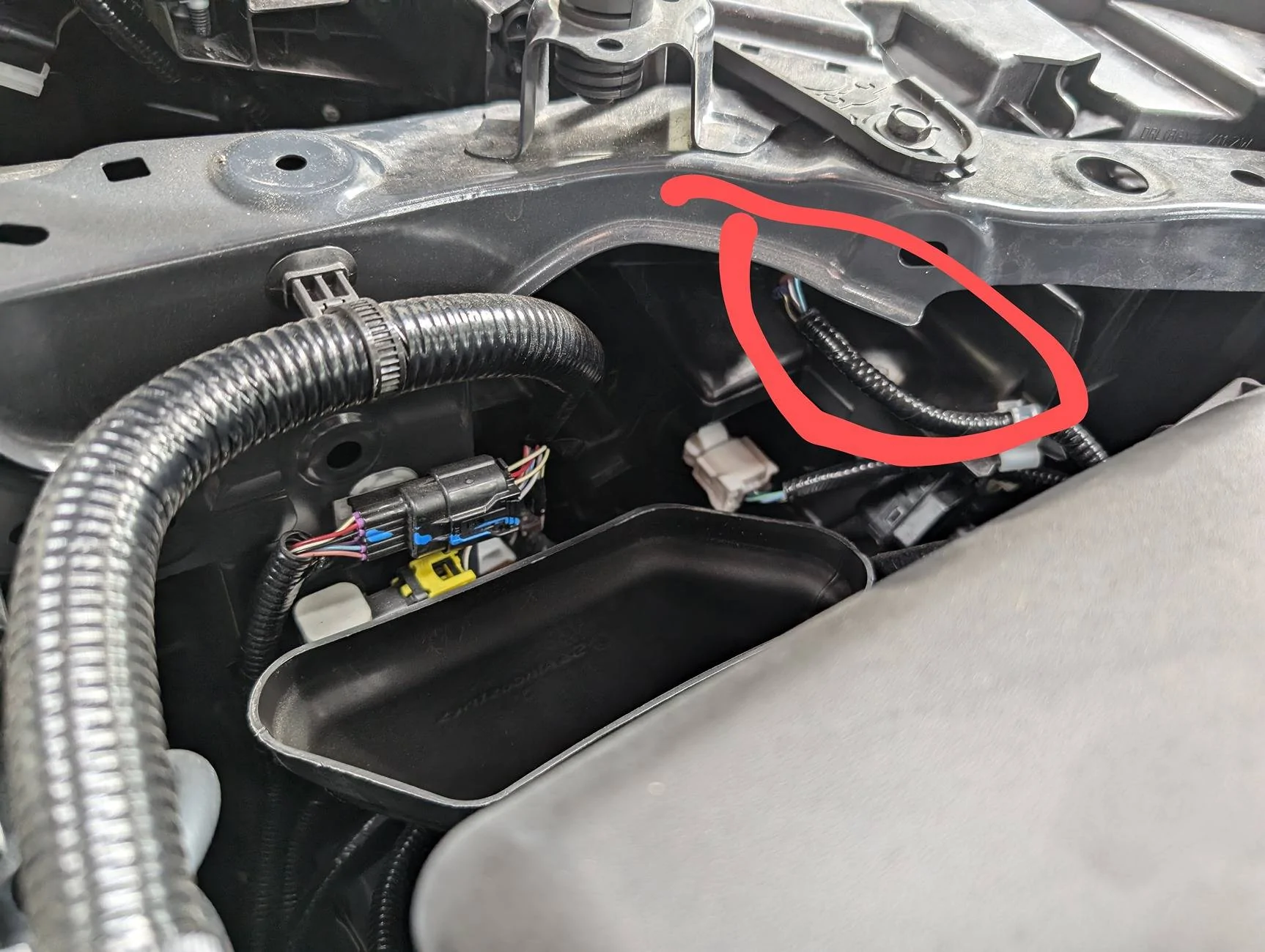

I just bought the lasfit switchback LED lights for the front turn signal and daytime running lights. I was surprised to see that toyota uses new body clips that don't require screwdrivers or extractor tools.
The driver's side was easier. You just twist the light housing counterclockwise about 90 degrees and it pops out. Twist it 90 degrees clockwise to put it back in.

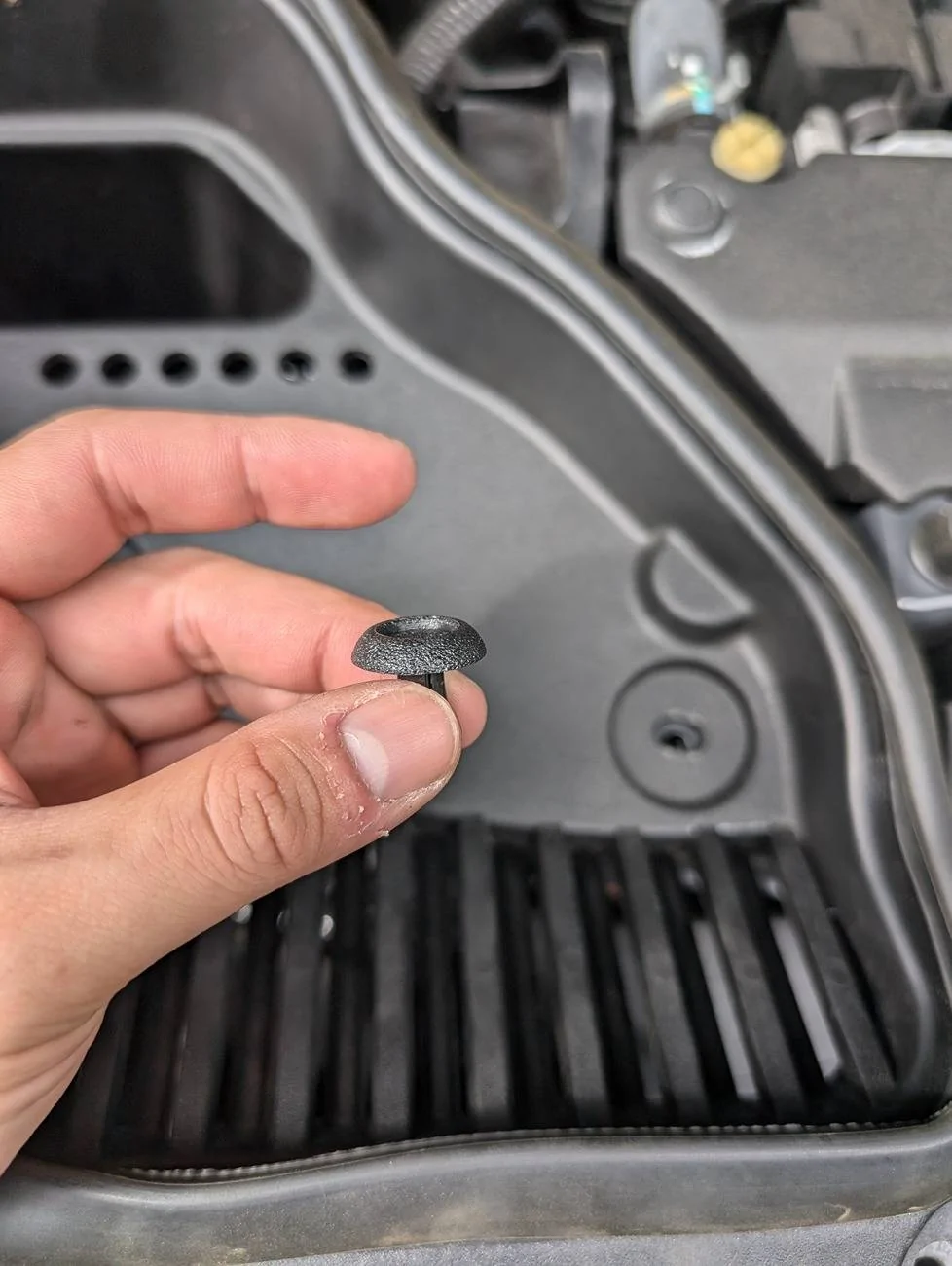

The passenger's side requires you to remove the body clips holding the air intake in place. These are new body clips that I've never seen before. They have 3 settings (out, flush, and in). Push the middle of the clip in and it releases the clip. Do this for all 4 clips. Then find the turn signal housing and replace the bulb. Reset the body clips to the out setting and put into the holes. Push them down only to the flush setting.
I've uploaded some pictures but the website has a better how to video.
