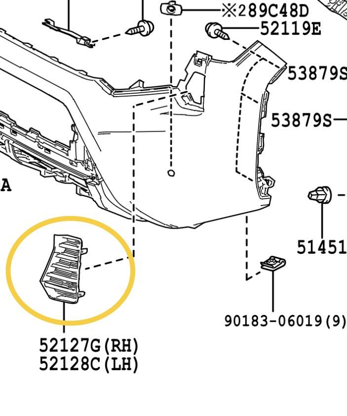

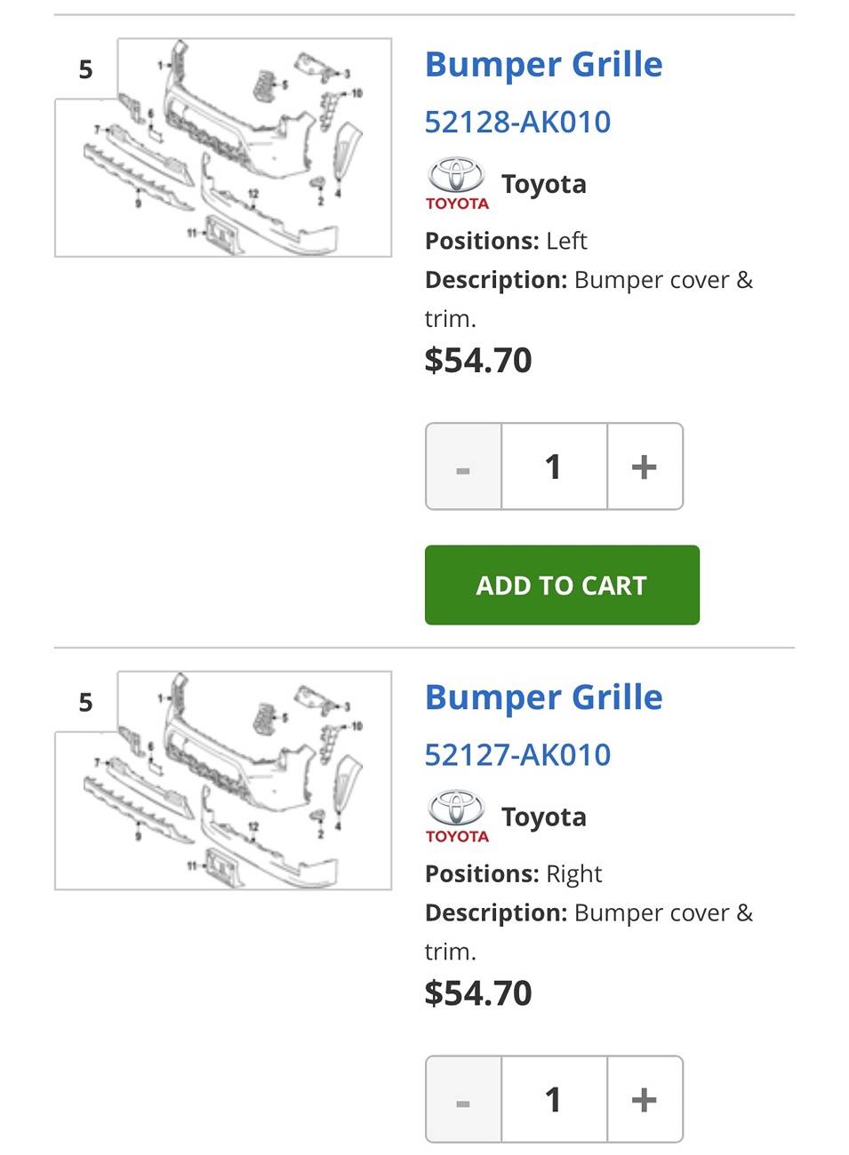

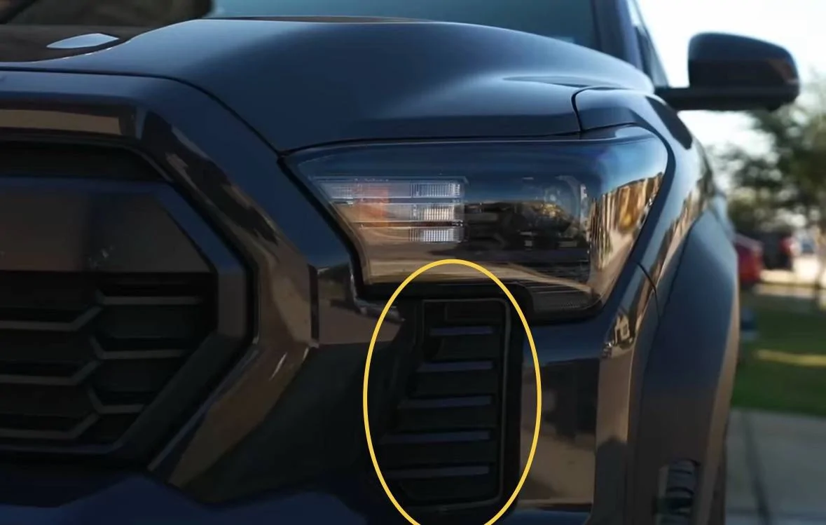

Im thinking about making my own set of “Fang Lights” (maybe Feniex emergency lights or Baja Squadrons). I was going to order another set of covers to create some sort of housing. $54 each isn’t too crazy but it’s not great either. Does anyone know how to get parts like this cheaper? Just curious.

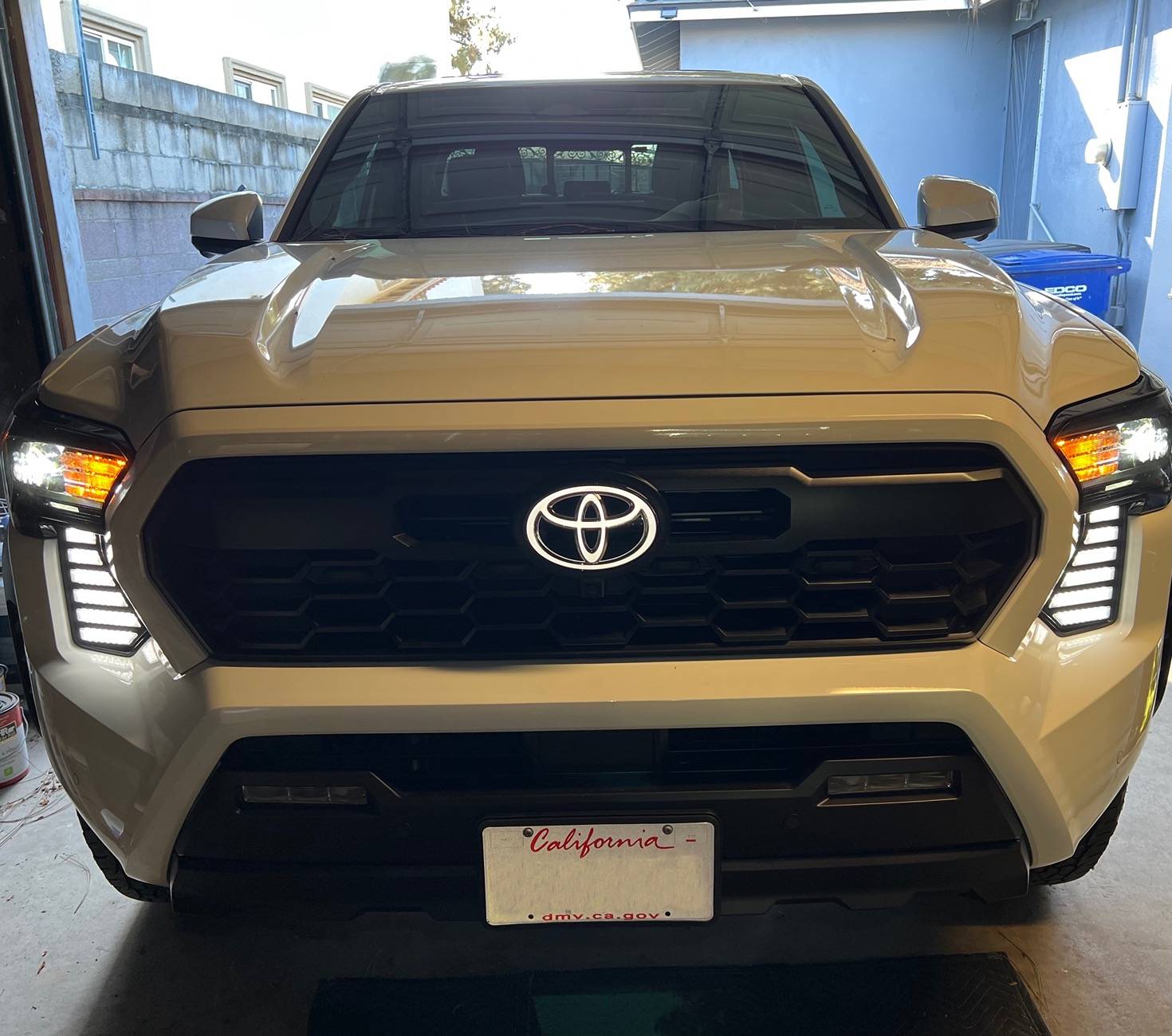

***I am not mechanically inclined. I have a career in healthcare and I do not have any experience working on cars. I am very good at watching videos and googling.***
I ordered them (Amazon) and installed them. Initially was gonna try to just get the OEM part out without taking off the bumper, but it was just too difficult. I ended up watching a Diode Dynamics video as reference and it was easy enough to remove. I did have to buy a 10mm socket, socket extensions, and a moving blanket to complete the task.
The lights didn’t come with any instructions, but I did find the Trumgeta video on YouTube and used it as reference for wiring it up. Take screen shots of the install points. It helps.
I didn’t like the how bright white the LED portions of the lights looked. They stood out way too much. So I ended up tinting them with plastidip (smoke). Looks more OEM and doesn’t really affect light output. Looks like the version from Tacoma Lifestyle version, just without the $150 (+tax) price. Possibly half the price, if you source your materials right or have tools on hand.
I used wire loom, zip ties, and adhesive cable mounts to clean it all up. Also, some liquid electrical tape (basically a bottle of plastidip) for the wire install points.
I’m pretty happy with the resulting outcome. I’m seeing more 4th gen Tacomas on the road and would rather somewhat individualize mine and this definitely helps.

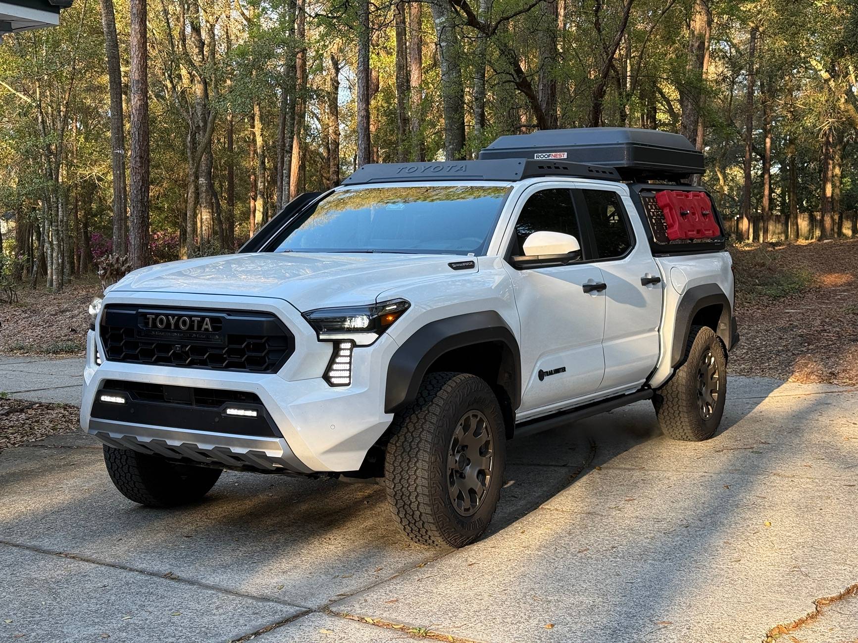

I bought mine from Tacoma Lifestyle $149 and had Yotamafia install them. Turn signal or hazard they sequence amber (video below), when driving they are solid white
