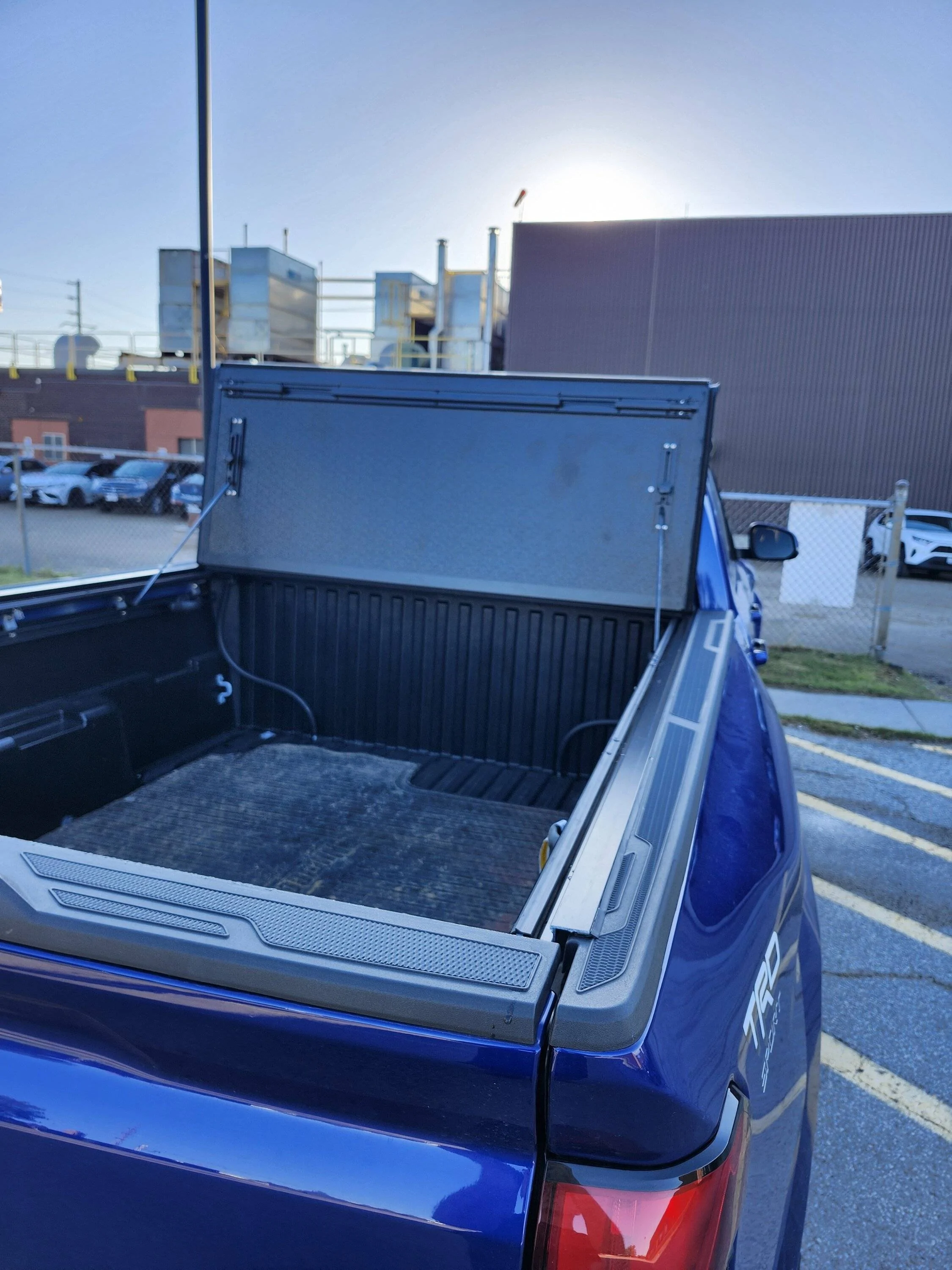

One thing though - I had to fully open the cover the other day, and it appears the prop rods are too long - anyone else have this issue? I suppose I can just cut them off a little?
I guess I'll grab a couple of fittings to try and run the drain hoses into those little holes as well. @Blue Crush Taco that seems to be working ok for you?
Hi there, the prop rods are definitely too long with this kit. Some people cut the rods abit. I unscrewed the bottom brackets and moved them back a bit. ( you would of course have to drill some tiny holes for the brackets) then I put a touch of silicone in the old holes. I'm happy with the cover so far at this price point.

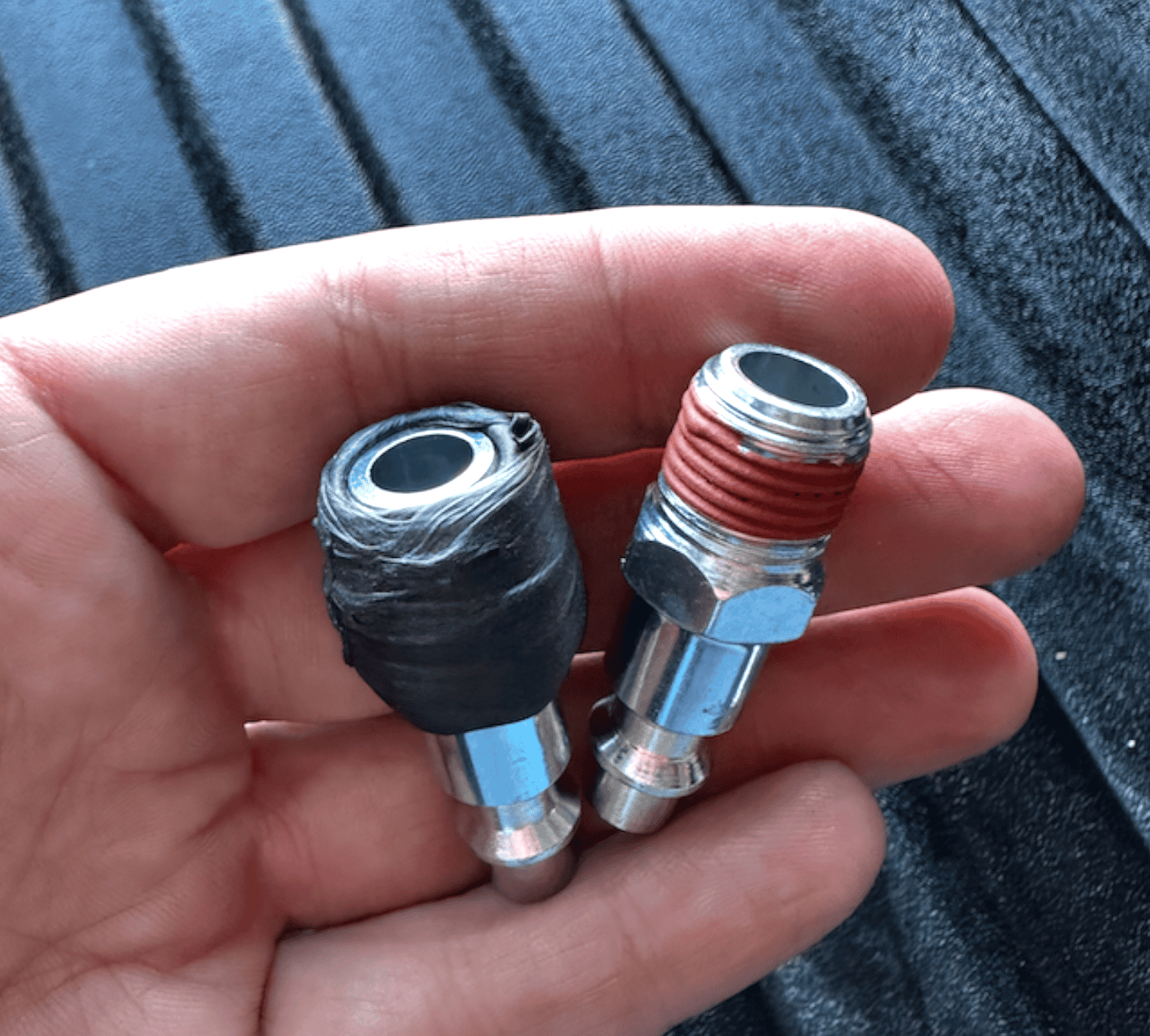

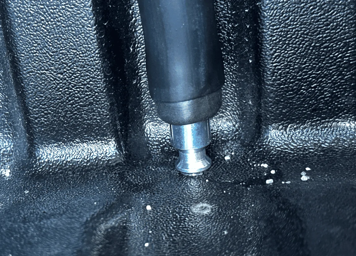

I had a couple 1/4 inch air fittings that I machined down a bit on my hobby lathe to fit existing holes( I think the holes are 6mm) the other end of the fitting fit snuggly in the drain hose end.
Oh man, pro tip there. Thanks!
This made me hunt through my garage to see if I had any air fittings and I found some! I just wrapped the threads in rubber tape and it's a snug fit to the rubber drain hoses. Sweet.

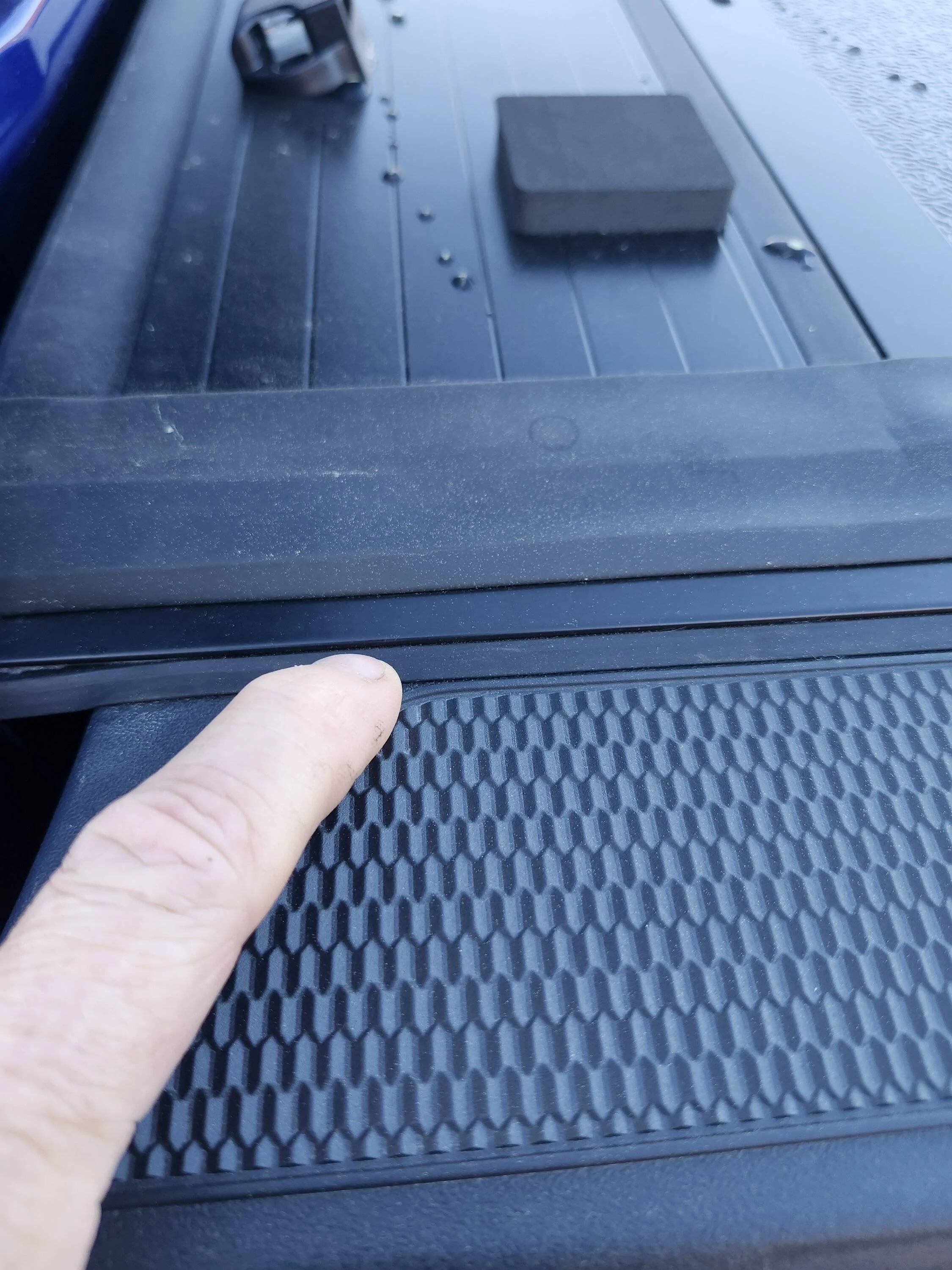

wondering where you applied the weather seal? along the cab side? and how far from the edge?

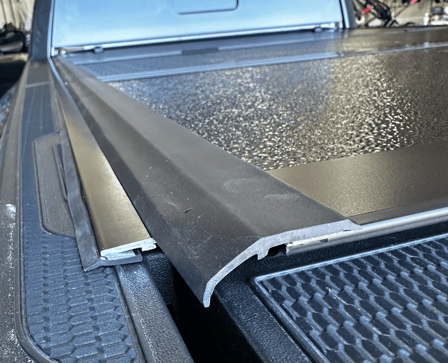

Is this how your S-brackets came? I got the same cover and mine have these little metal pieces what seem to be double sided taped on.
