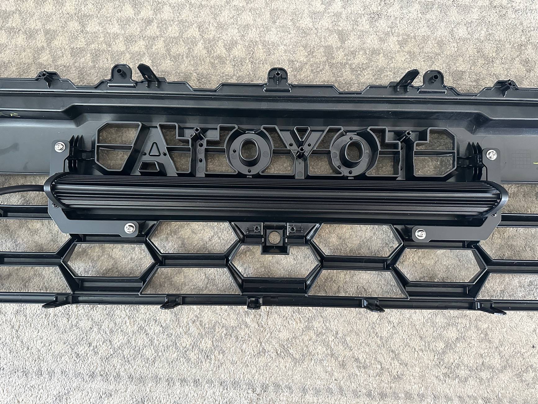

so to fit the bar I had to get creative with the mounting solution
2024 Tacoma Cali Raised LED 20” light bar install on heritage grille IMG_8556.JPG
So the light bar is just a bit too wide and if you wanted to use to mounting holes you would need to notch the grille. I wanted to avoid tampering with the grille, and I wanted to make sure you could not see any parts of the mount from the front (OCD yeah).
So this allows you to mount it now to the holes on the grille using the second part of the bracket.
2024 Tacoma Cali Raised LED 20” light bar install on heritage grille IMG_8555.JPG
The "L" style tabs I'm going to print high res from PA6-CF which is a carbon fiber filled nylon. This will be able to handle heat and have a high enough tensile strength that I won't be worried about it breaking on me as long as its printed correctly with proper adhesion.
From the front, this light bar does sit pretty well inside the grille.
2024 Tacoma Cali Raised LED 20” light bar install on heritage grille IMG_8553.JPG
I'm going to use send cut send to make the larger bracket portion from stainless and have it powder coated and then I can mount it up and make sure this thing clears the grille shutters.
If anyone is interested in going this route I'll probably sell the brackets and L tabs to anyone that wants for 35-40 just depends what price I get the stainless powder coated brackets for.

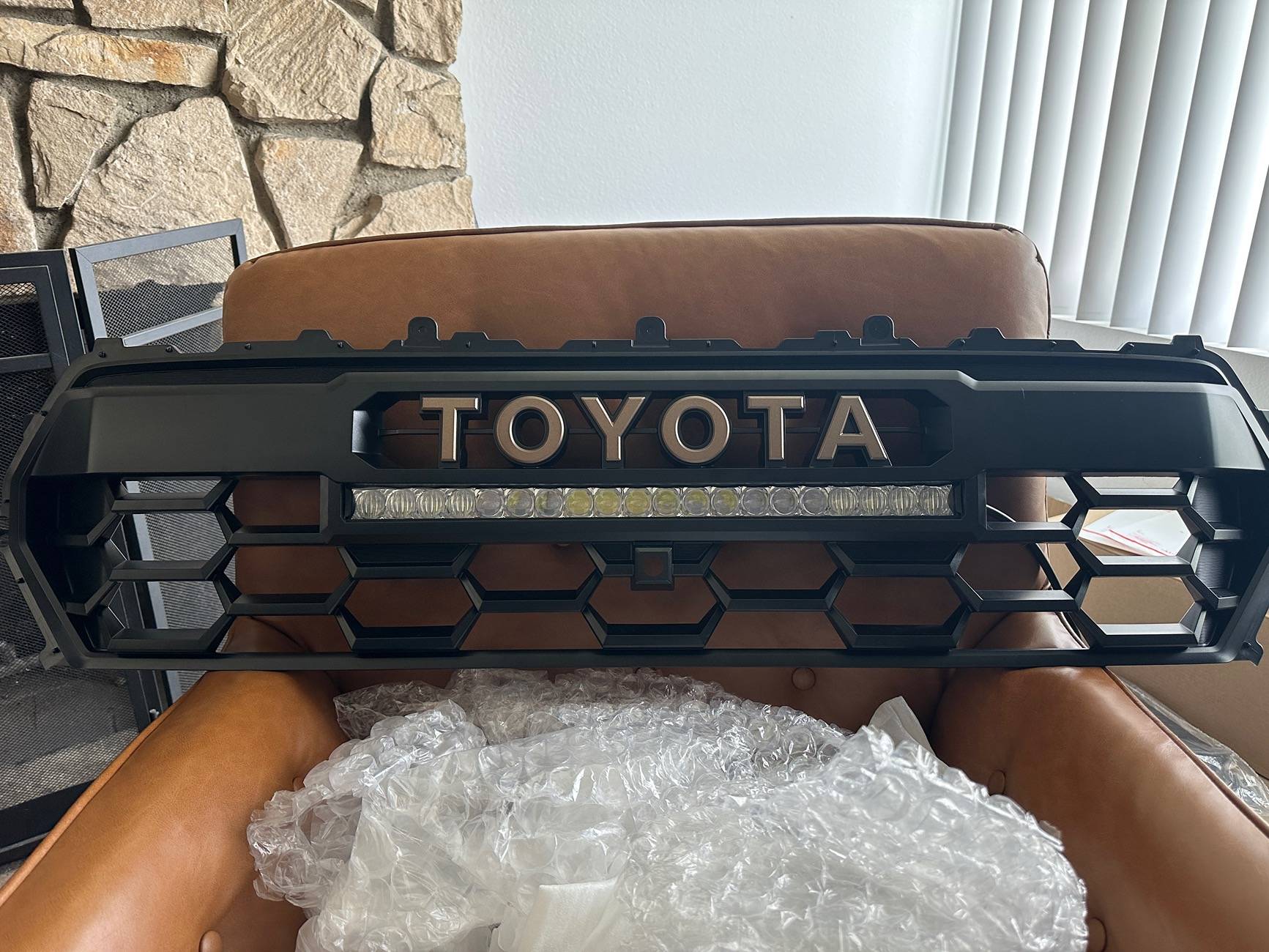

got the brackets and they fit well
2024 Tacoma Cali Raised LED 20” light bar install on heritage grille IMG_8643
Can’t see them from the front

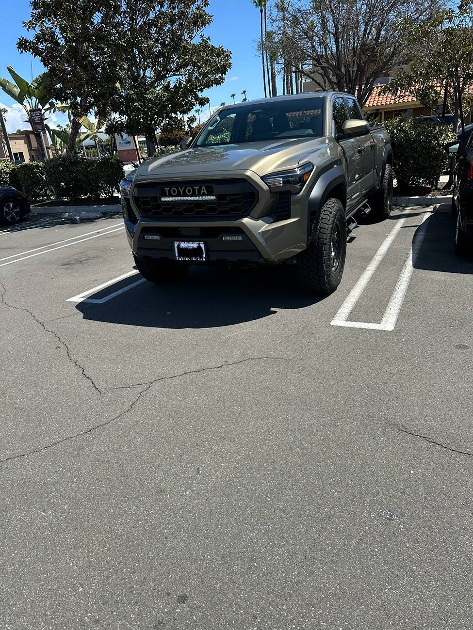

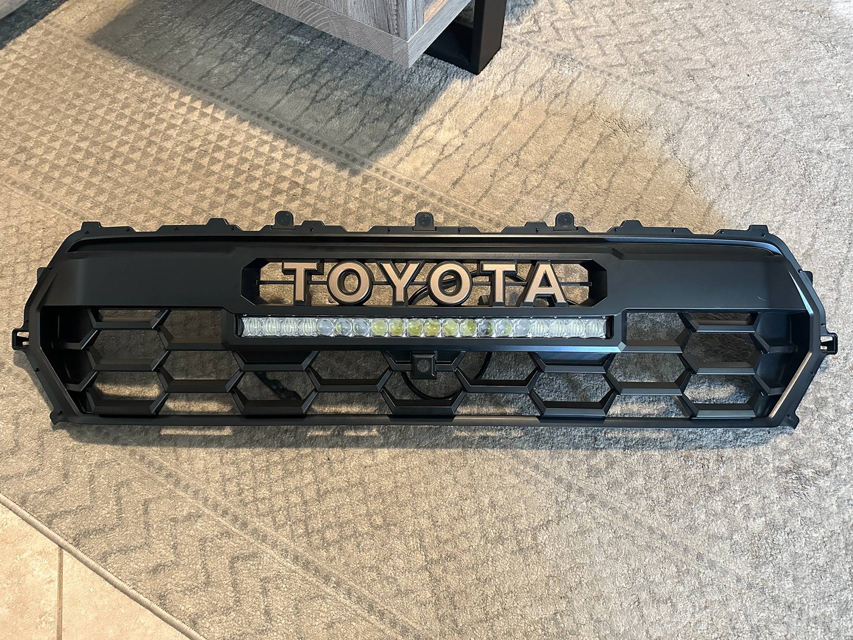

Got it installed today. The grille shutters seem extremely close to the outter back edge of the light bar. They close upward so I’m thinking it won’t interfere, but I won’t know until a situation arises where the shutters actually close. So far no error codes just not sure when they typically activate.
2024 Tacoma Cali Raised LED 20” light bar install on heritage grille IMG_8682
Really stoked on this. It’s a very decent light bar, and fits the opening perfectly. Light was 207$ and comes with the harness, brackets 40$ and then I spent maybe 6$ on hardware. I ordered the OEM trail hunter light bar/fog switch combo to use as a switch so I’ll see how wiring that up goes but that was another 24$ + 7$ for the connector to the back of the switch from alibaba.
Will update when I finish up the wiring.
