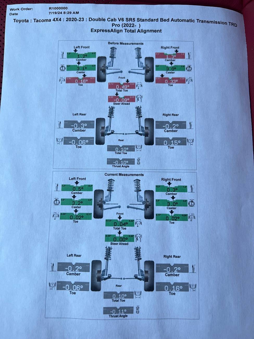

Took it to the dealer for the alignment today. Here’s the before and after…
Well I guess I'm adding this to the list of things I want the master tech to check before I pick the truck up

@Wighty So it was definitely way too much positive camber in the front, as it appeared. That will save you some front tire wear.
Another good thing to know about and check on a new TRD Pro.
