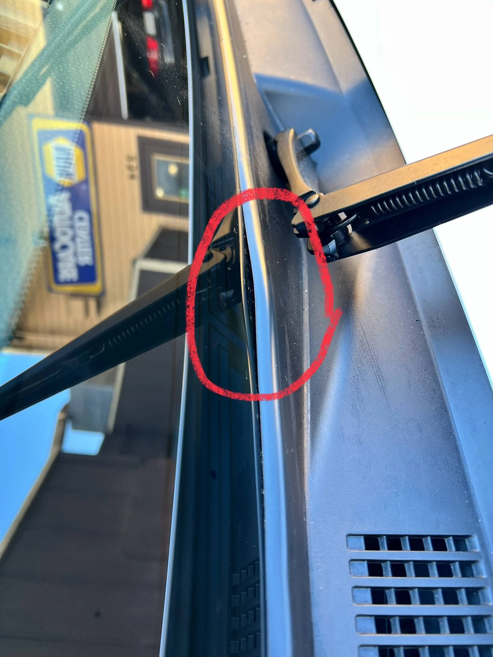

141 miles later and the check engine light is on again. I think it’s the same code which was for the cylinder 1 fuel injector. So back to the dealer. I also noticed that the cowling at the base of the windshield is warping. I was my truck myself every week and hadn’t noticed this until today when I was cleaning the windshield. I live in a very mild climate so it’s definitely not heat related.

Mine also has warped cowling and is apparently quite common (vehicles have the same area warping). I forget which forum, but there was a thread dedicated to the issue. Update if your dealer takes care of this for you, I plan to have them address the issue on my first service interval.
