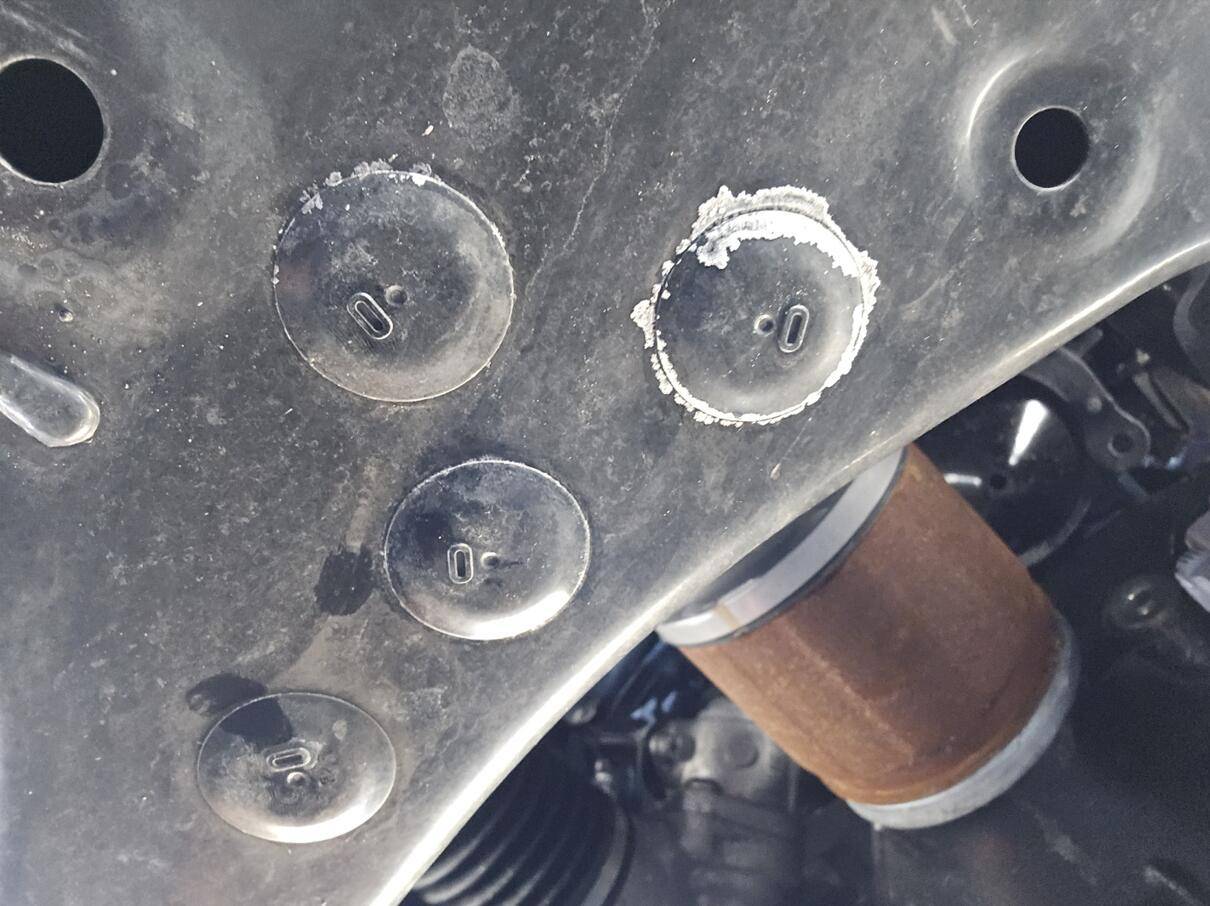

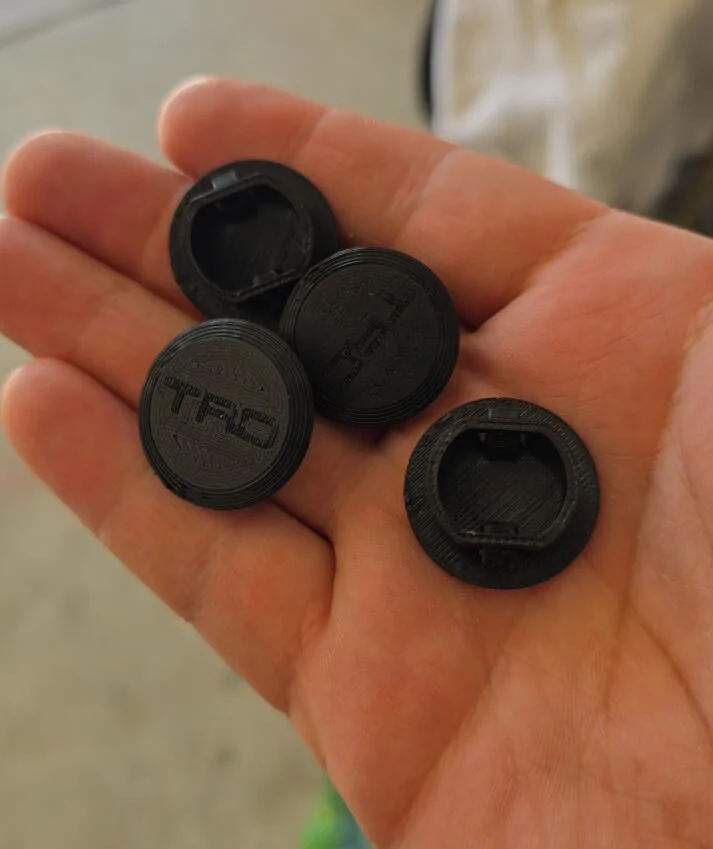

So I printed my own plugs to proactively plug my control arms holes. But when i went under there they were already plugged!? Does Toyota do this as an option from the factory? My truck was newly purchased from a dealer lot with 30 miles on it. However it never had an air dam on it. Just has my brain wondering now?

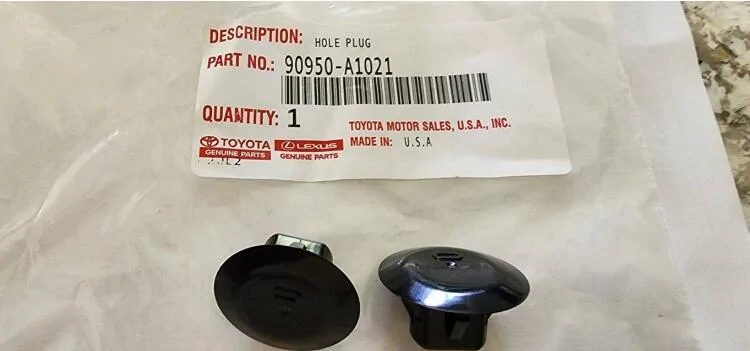

Quick google appears there is an OEM part specifically for this action of air dam removal?
Yeah, and the list price is $3.82 each. So, if you have a 3d printer...
(I'd have gone to a parts store or Amazon and found something cheaper).
Yes, some trucks come with them already installed.

Seems to be that the models that came without the airdam i.e. Off:Road, TRD Pro, and Trailhunter. Came with the hole plugged. Looks like Toyota must have come across the sound during testing and plugged them from the factory.
