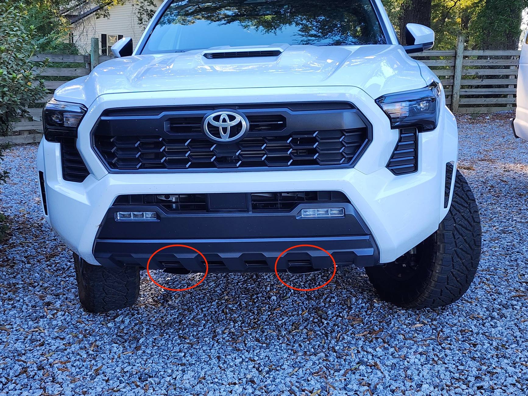

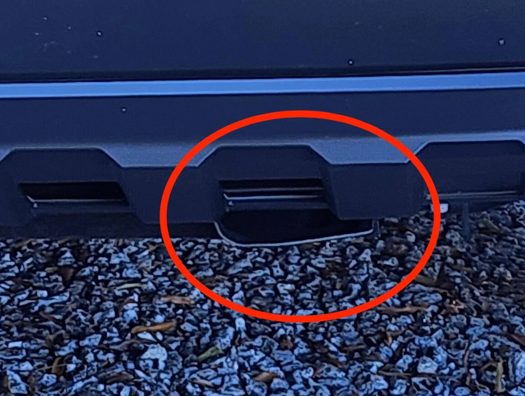

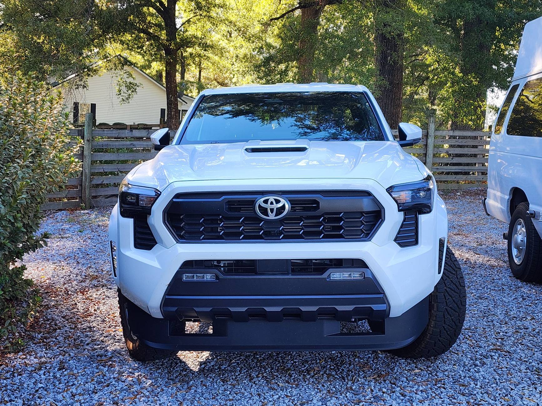

Well, I took off the ugly air dam from my 2024 Tacoma Sport. Looks better already, but not perfect. See before / after pictures. I have circled in red the felt-ish material that is now exposed without the air dam. With those 2 wind-catchers, I am definately getting a howling sound (starting around 35 mph). I have purchased a TRD skid-plate, but am still waiting for the NYTOP Front Frame Cross Member to arrive. I'll update this thread with new

pictures once installed, and update you re: if the howling noise goes away (which kinda sounds like wind blowing through a cave).

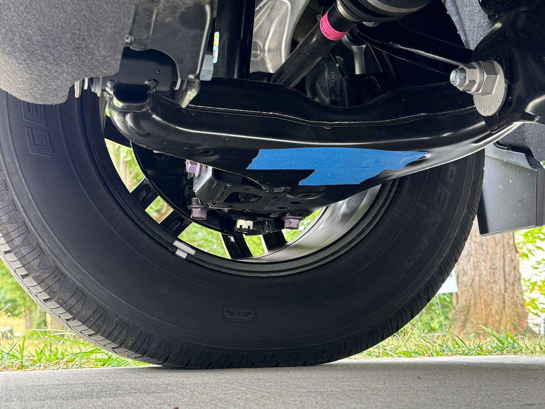

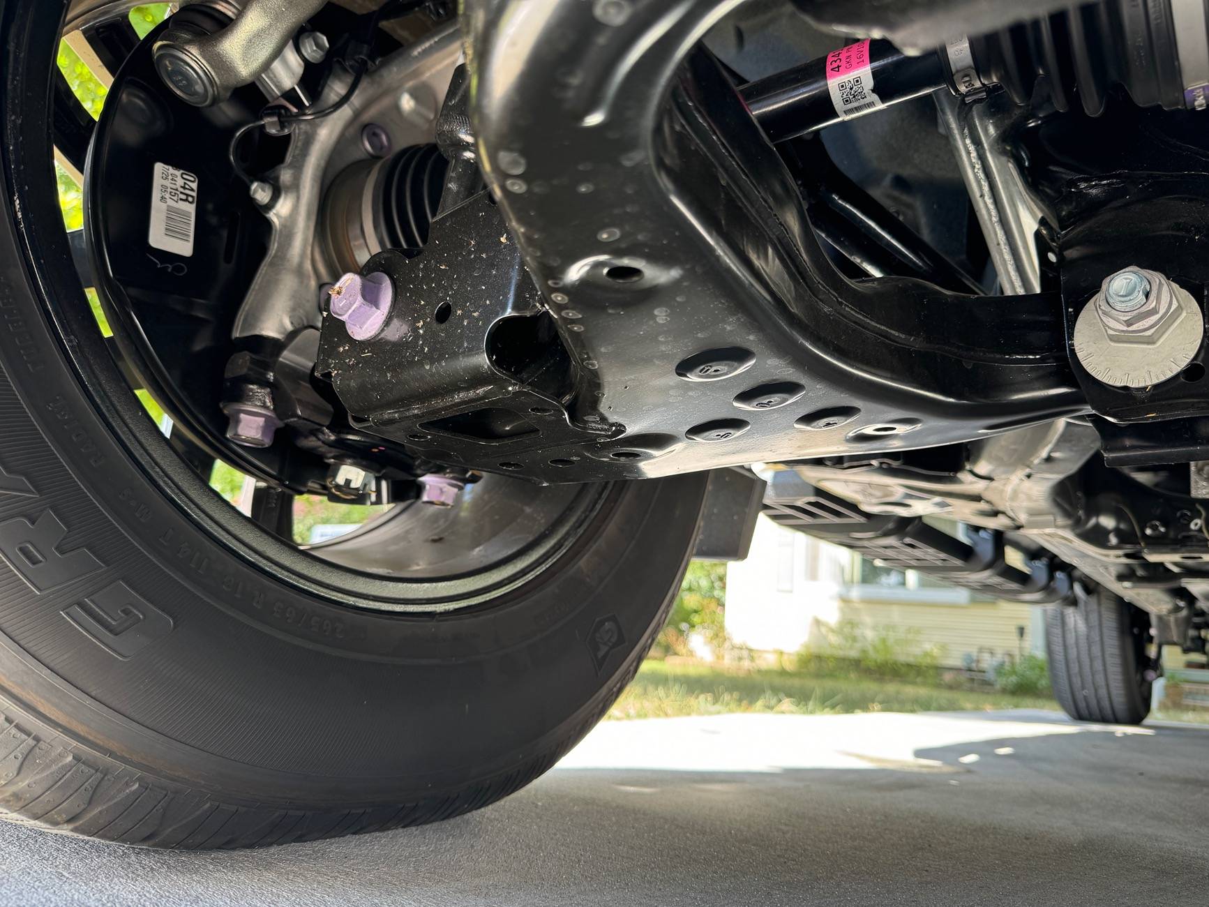

The howling noise is not from those areas, it is coming from the holes that do not have the plugs. You need to purchase the plugs but until you get them just cover the holes with blue painters tape.
Oh, ok. Thanks! I'll look into trying to get those. The would have been super frustrating after getting the skid plate on and still having the noise. Thanks again, Mark

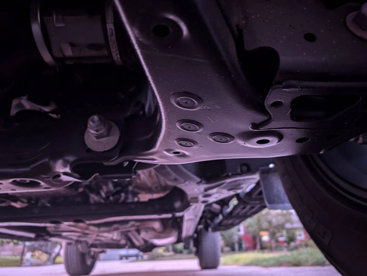

I ordered (on amazon canada, but im sure you can find an equiv)

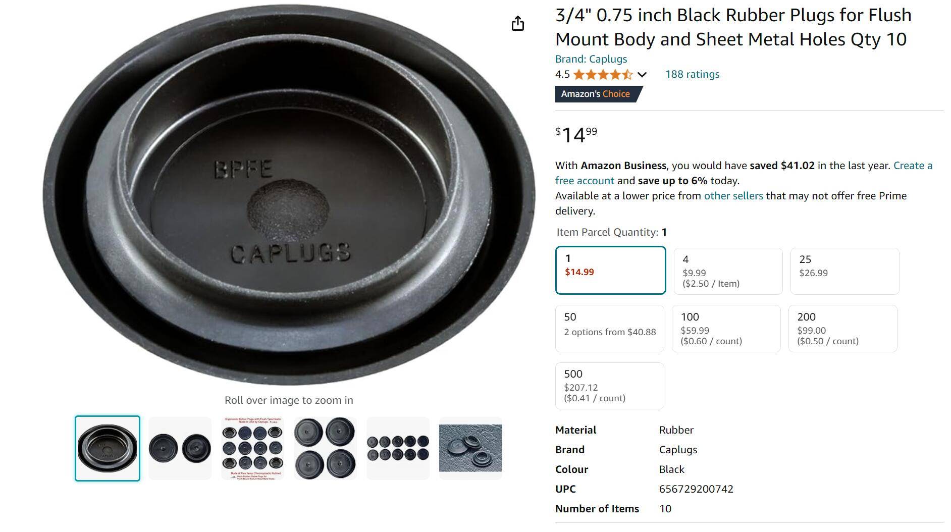

Are these plugs actually rubber or plastic? I purchased this same brand at a local auto parts store and they are plastic. They dont seem to snap in the hole very securely.
do a google search for this and you should find on Amazon for $6.94 3/4" 0.75 inch Black Rubber Plugs for Flush Mount Body and Sheet Metal Holes Qty 10
