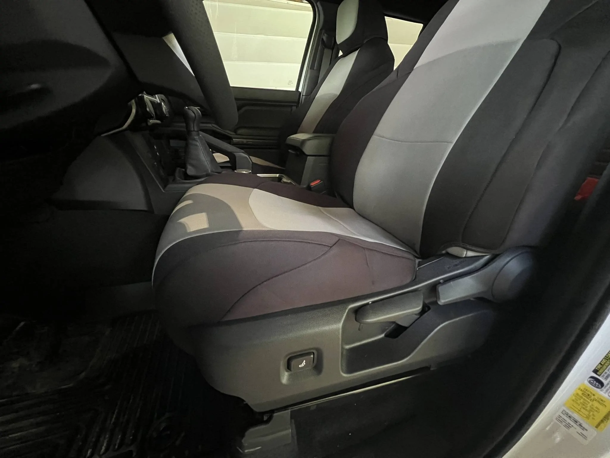

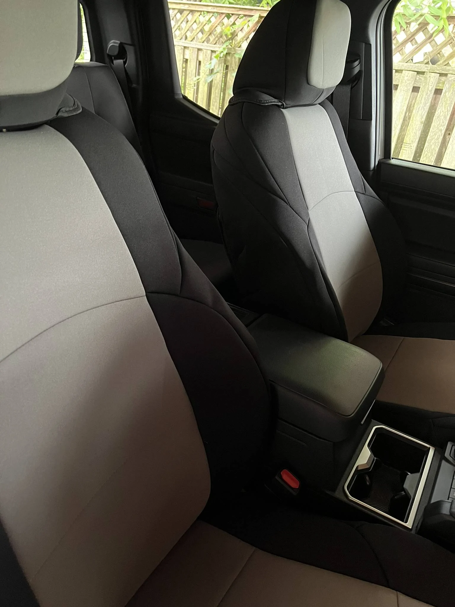

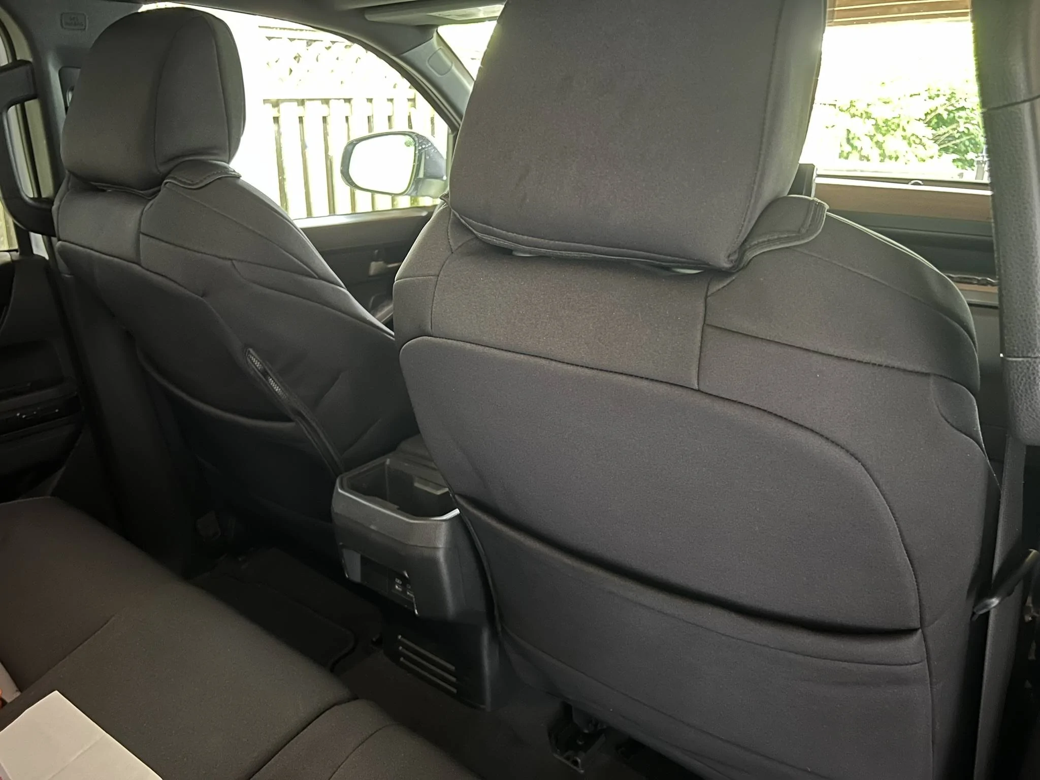

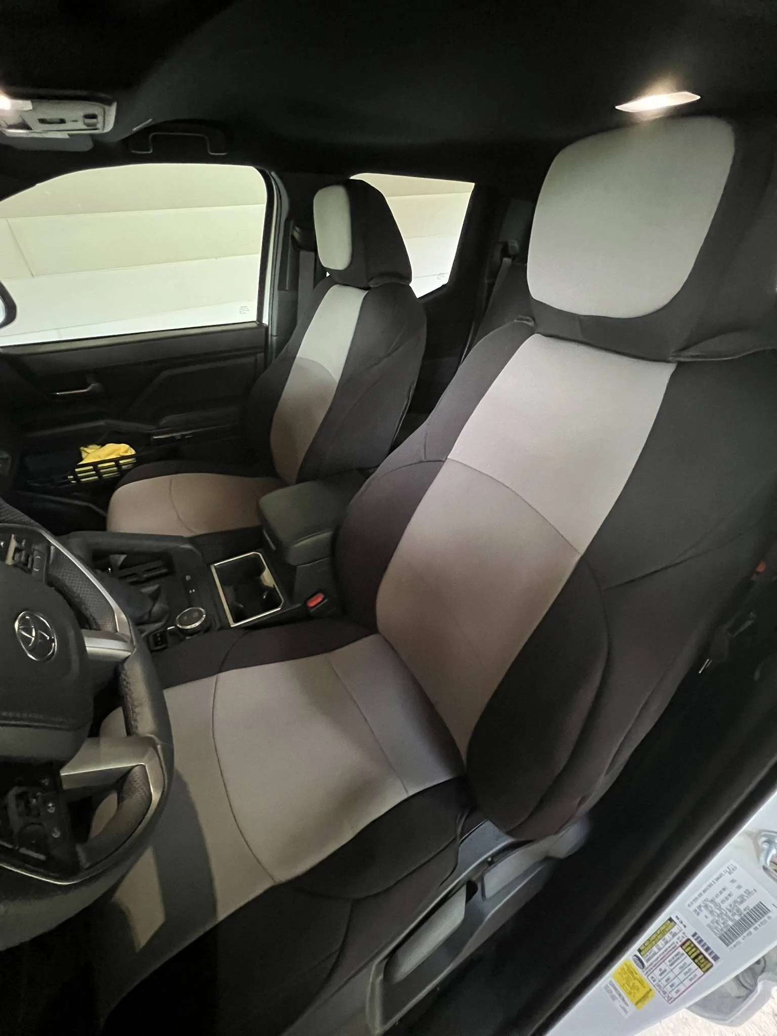

I just installed my front seat covers today. My truck has cloth seats and I have dogs, so I went for the expensive Neoprene covers. The trick I used to get the straps between the seat cushions was to remove the buckles from the straps, but it might not be necessary (the gap between the cushions was really tight on my driver's seat).
I slid the seat and the back forward as far as possible to give myself some room to work behind the seat. On the back of the seat, there is a cover which kind of obstructs the gap between the cushions, so keep this in mind as you push the strap through using the little tool that came with the covers. Once I got the straps through, I did my best to make sure they weren't twisted by kind of shimmying the strap back and forth (then I had to put the buckles back on lol), and at this point I pulled the straps through fairly firmly to help pull the cover in between the cushions a bit. Then I slid the seats back and tilted it back a bit to put the non-slip pad on the seat cushion and position the bottom of the cover. At this point, I also shoved the cover's seam between the cushions and the plastic side panel where the seat levers are with the handy little tool. After I was comfortable with the position of the seat cover, again, I tilted the seat back forward and slid it forward as far as possible. This next part was the trickiest part, for me. This is where you have to make sure you're not pinching any electric connectors or air tubes (for lumbar support) with the straps, and keeping the straps as close to the bottom of the cushion as possible, connect the buckles and tighten them down. There's another bungie hook on the side of the cover closest to your center console, and I'm not even sure this one does anything, but you have to fish it around the felt hanging between the seat and try to find a good piece of metal under the seat to connect that hook too.
You have to kind of man-handle your seats to get these covers on there, and they probably won't be perfect, but push and pull on them to get them how you want 'em and continue to tighten the main straps as you do this. Hopefully, the rear seat covers will be a bit easier!

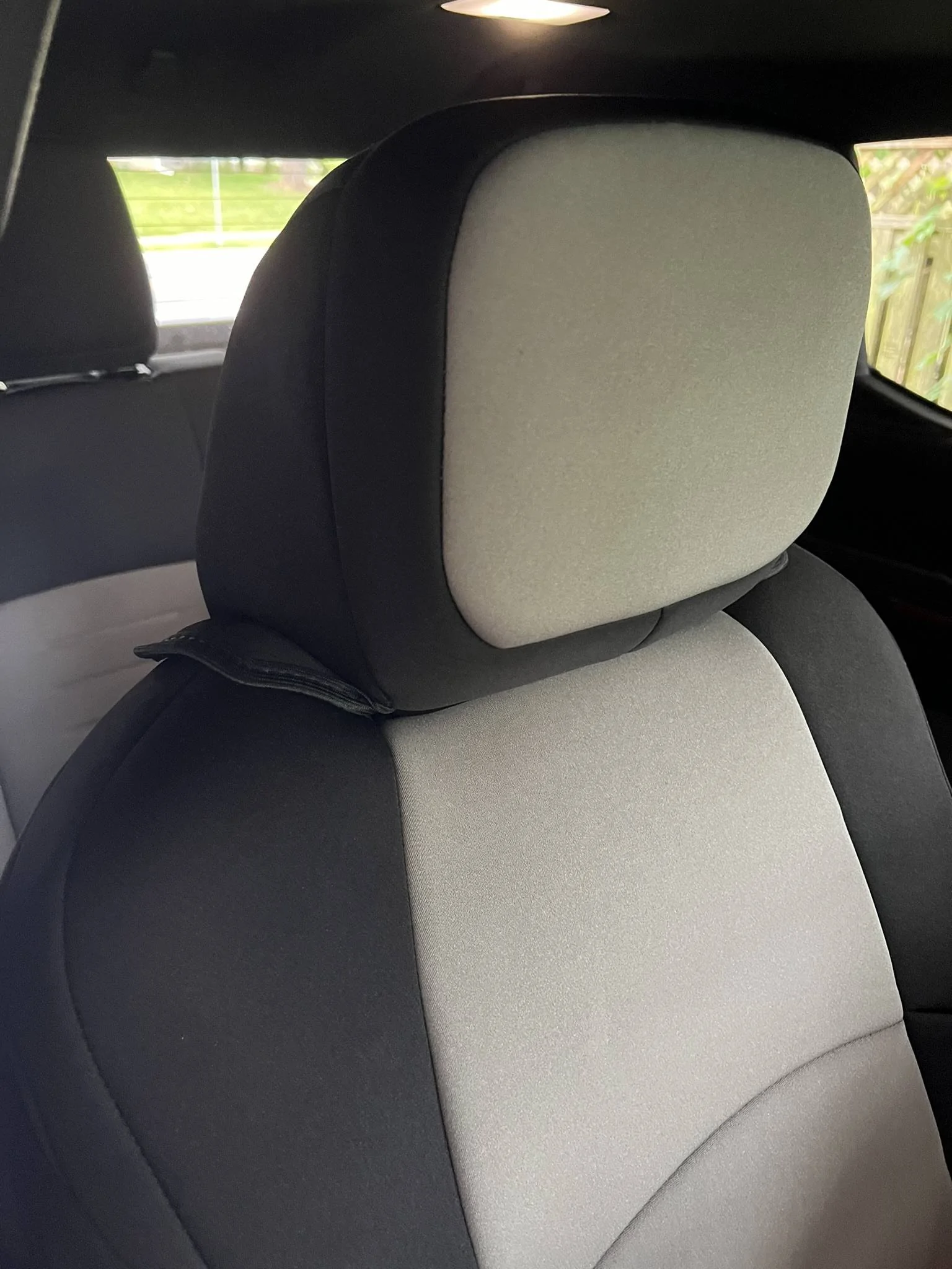

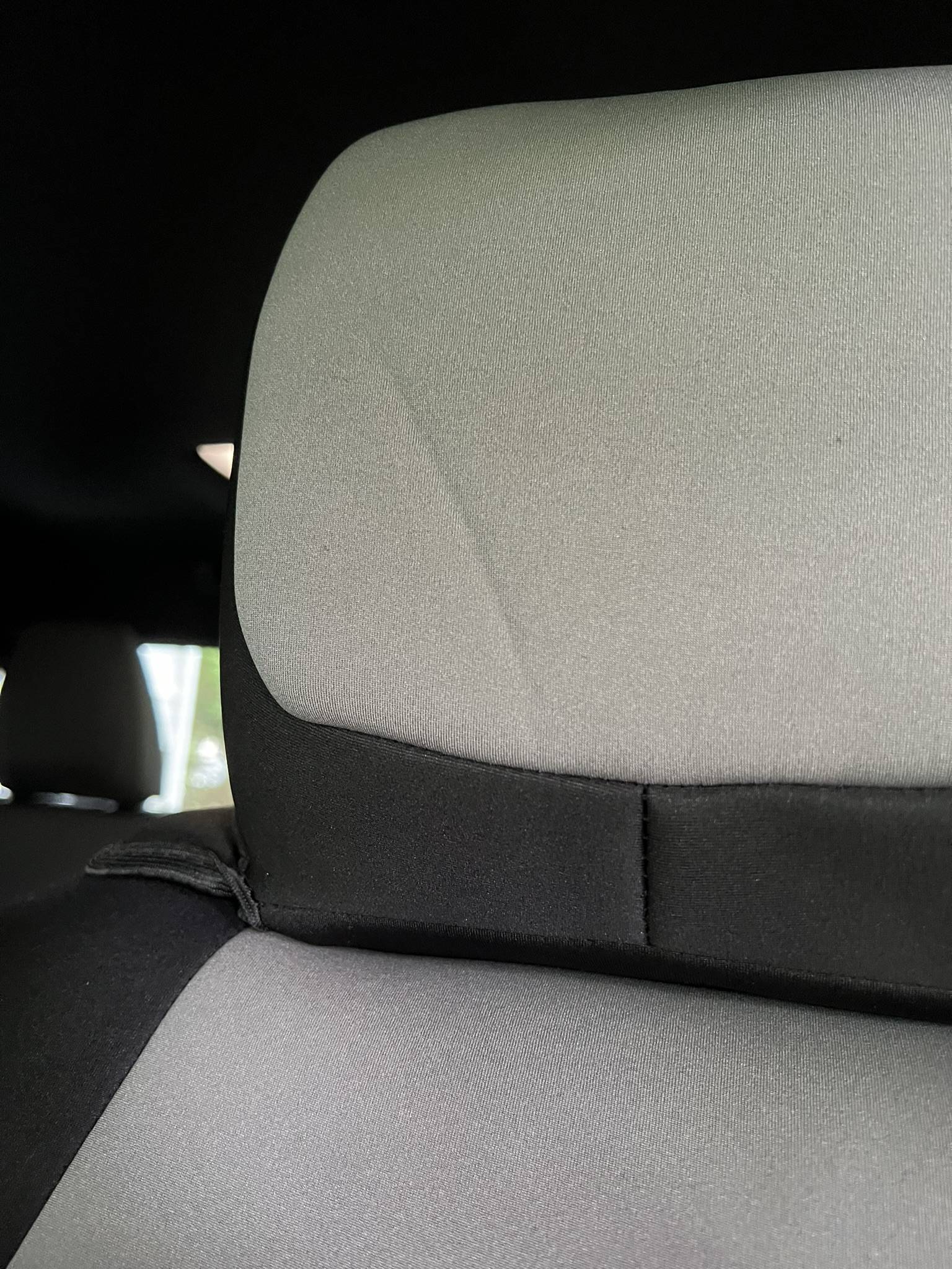

In my opinion, right now, the head rest covers are the most "disappointing" because of the extra flaps that seem unnecessary. There was no way to hide them and be able to lower the head rest all the way down, so I kind of left them hanging as a sort of collar for my seats lol. I'm really hoping these covers will adjust themselves with usage, but I don't know if this material is capable of doing that (my gut tells me it's not). The big crease on the front of the head rest in the last photo, and the fairly substantial bagginess around the bolsters on the side of the seats was not expected for something that I paid about $700 for!
I got a road trip coming up to give them a real chance. I will consider returning them for something else afterwards unless they really impress me lol. They are comfortable, and they will protect my seats; I'm 100% sure of that, but for a product this expensive and "custom," they should surely fit better. Sorry about the rant, but thought I'd share if anyone here was interested!
