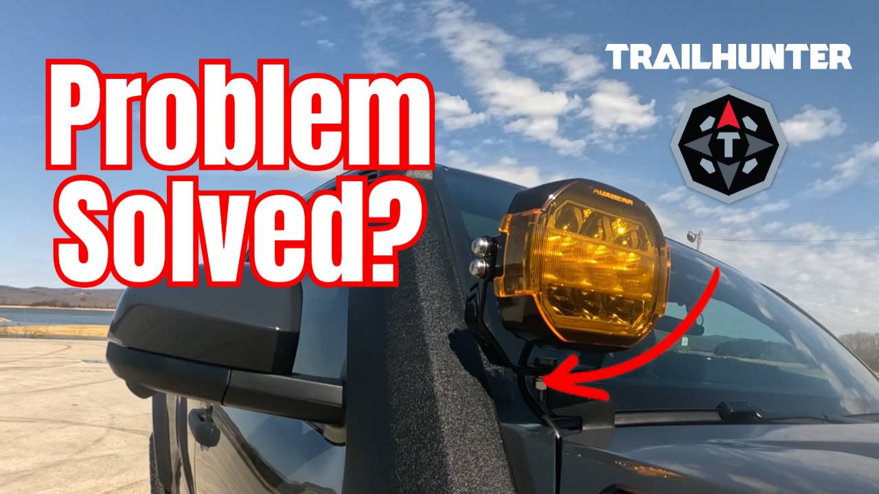

Does the snorkel present a problem for ditch lights on a Trailhunter?
It does and I have a solution on installing these 5 inch LED Driving Pods with Ditch Light Side Shooters, what I'm calling hulked out ditch lights!
2025 Tacoma Trailhunter Ditch Light Problem SOLVED!
2024 Tacoma Does the snorkel present a problem for ditch lights on a Trailhunter? 2025 Tacoma Trailhunter Ditch Light Problem SOLVED!

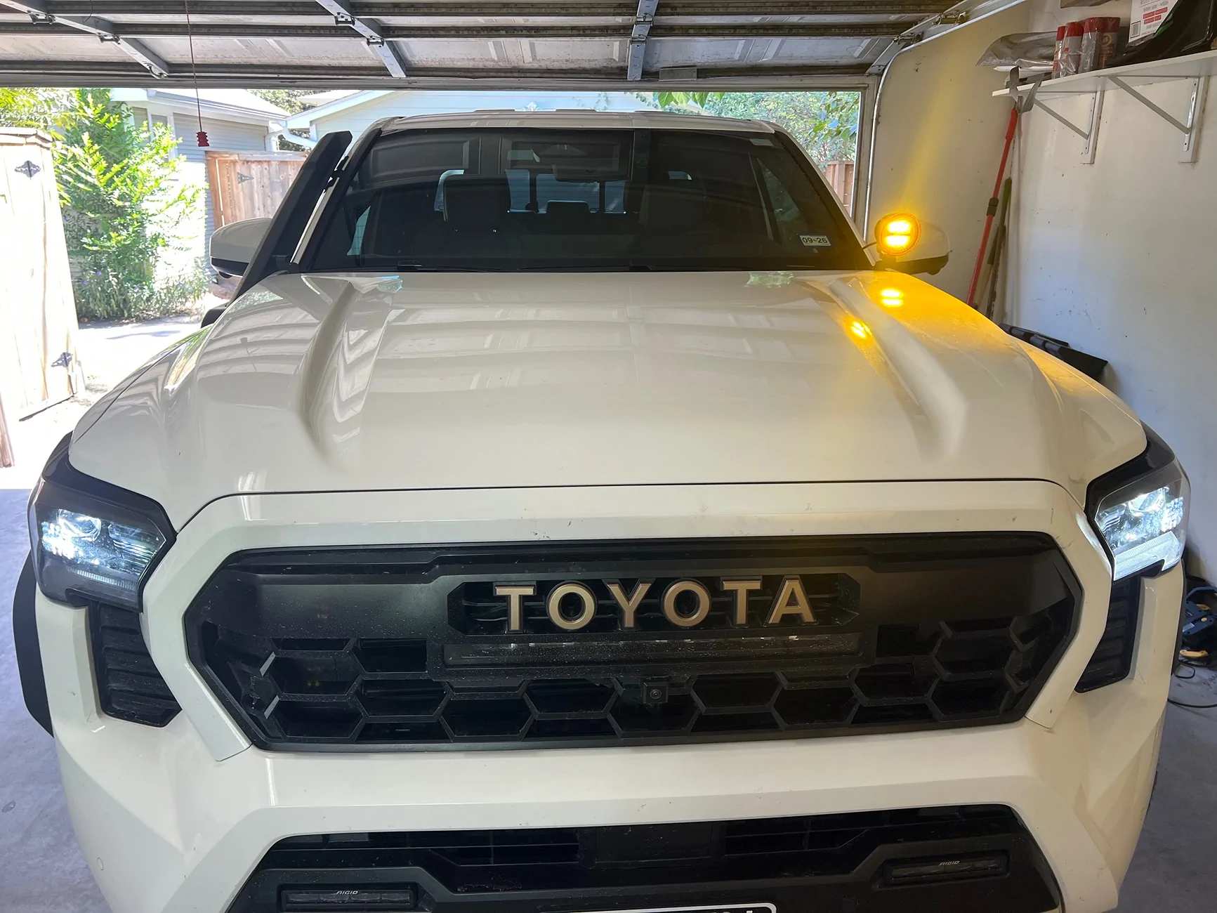

I installed Rigid mounts and white(marine) Rigid pods, SPV harness connected to aux2. To open the hood I have to turn the right pod facing the left pod for clearance at the back of the pod when close to the snorkel with the hood up. I carry a small box wrench in the truck to loosen and tighten the pod to turn.

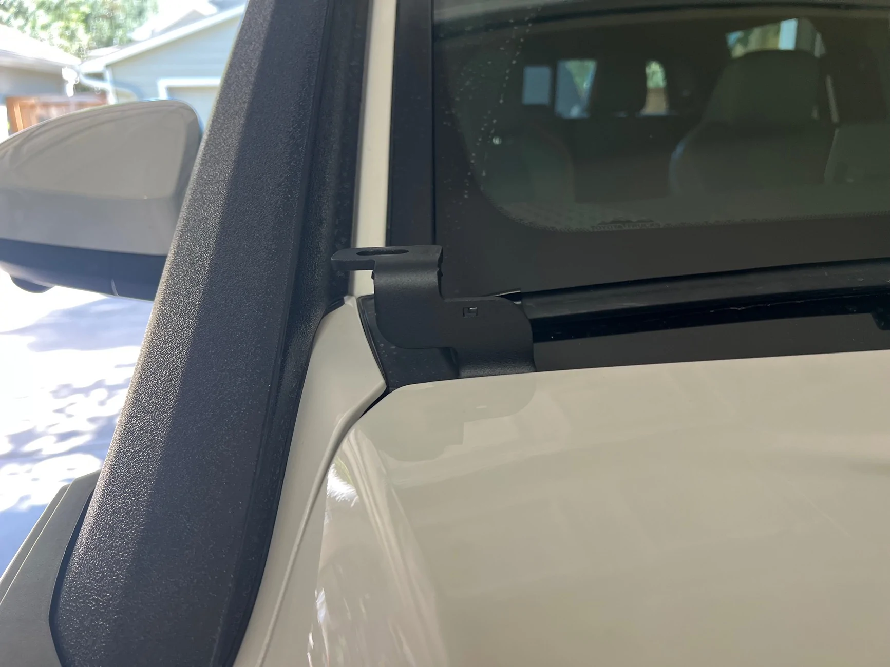

For me.
Rigid D-SS Pro lights and Rigid A-Pillar bracket did not clear snorkel.
But D-SS Pro lights and Cali Raised Ditch Light bracket did clear.
