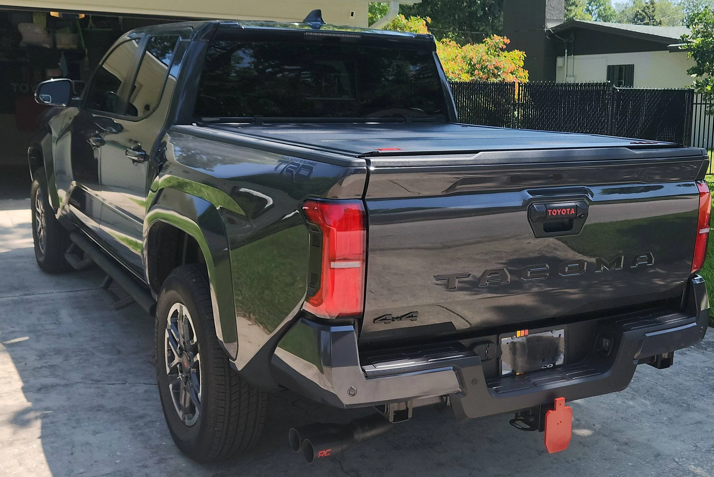

This is quite a long shot but does anyone know of an exhaust flange I can buy that'll fit the exhaust flange where the resonator attaches to the muffler in the rear?
I want to axel dump my Tacoma but being in Canada trying to order the OEM downpipe from the trailhunter or anything after market it's costing me more on shipping than it is for the actual part, plus a 30 day lead time in some cases. If I could find what flange would work, even relatively well I'd be able to buy a downpipe and get the flange and a universal exhaust hangers welded at a fraction of the cost of the OEM part, much less the insane shipping costs.
My second option is throwing my hands up in the air and getting my sawzall out but I want to avoid that as much as I can.
I'm not sure what an "axel dump" is (😆 Canadian thing?) but I used my sawzall and cut the belled end/flange off of my tailpipe and modified a Rough Country dual exhaust tip ($64.00 I think, cheaper than the black chrome OEM Toyota tip)(their website said it would fit a 24 Taco...it didn't!) to fit. I think it looks a lot better than the galvanized colored tailpipe and it's definitely a one of a kind mod for the 2024's.
Sorry this probably didn't answer your question but maybe it will give you the courage to start cutting things off your brand new truck lol.
