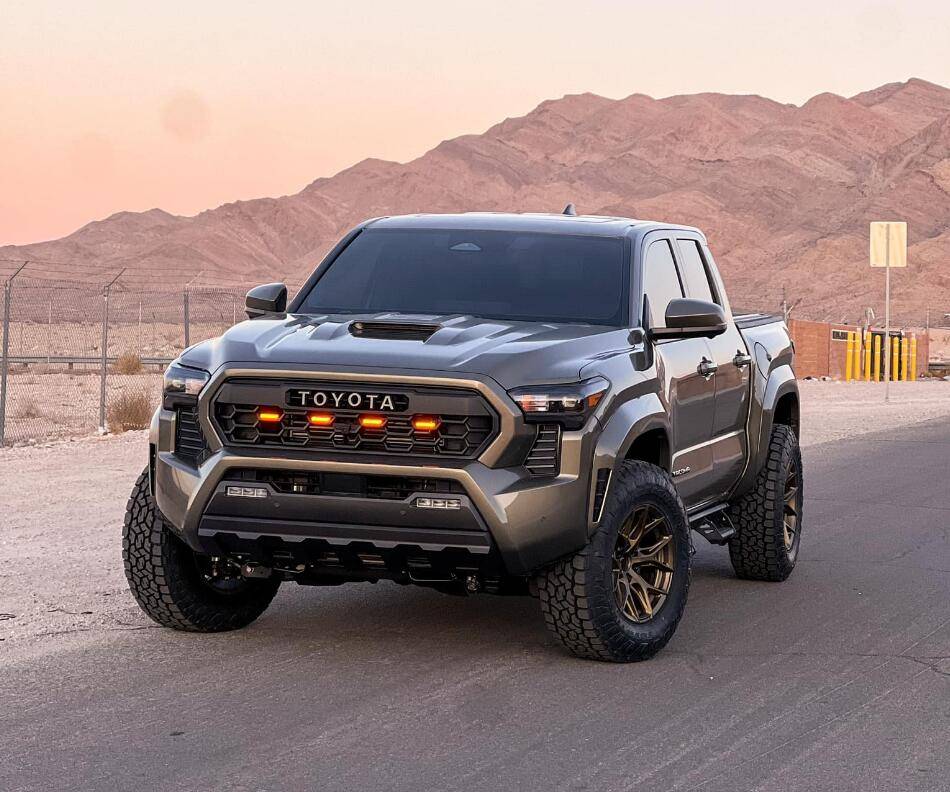

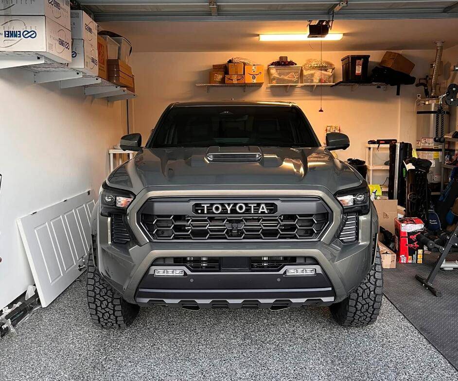

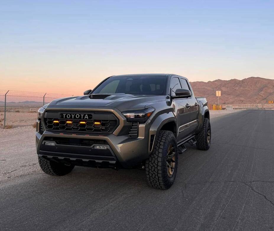

Maybe this will help with my questions\topics. Theres tons of +25 offset examples already(i started a +25 specific thread) of a 285\70\17 on a 17x8.5 wheel.
Here is specifically going smaller in tire size( Toyo Open Country AT3 275/70R17) but also bigger in wheel width(Vossen HF6-4 17x9 +0mm). It definitely doesnt look abnormal or anything to my eyes. But whats the pro\con\value or purpose of doing this in this context?

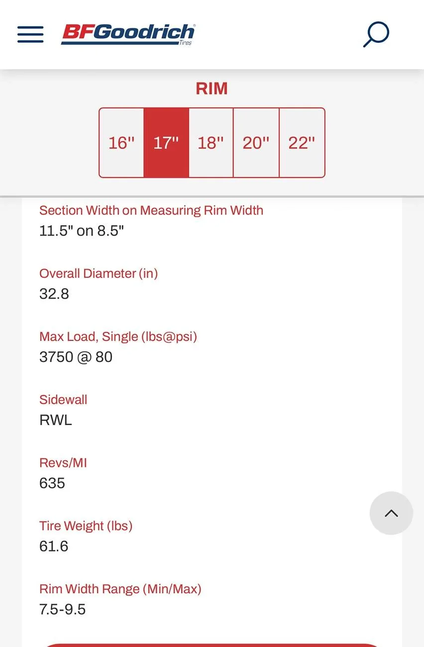

THank you. How do you know if thats going to be the case? Like how do you know the algorith or formula to know your safe\buffer range between the tire width and wheel width?
Easy. Every tire has a spec sheet usually found on its website. The spec sheet lists all specs for all sizes of that the particular tires that’s available. In these, you’ll find the recommended, as well as, the tested rim widths.
