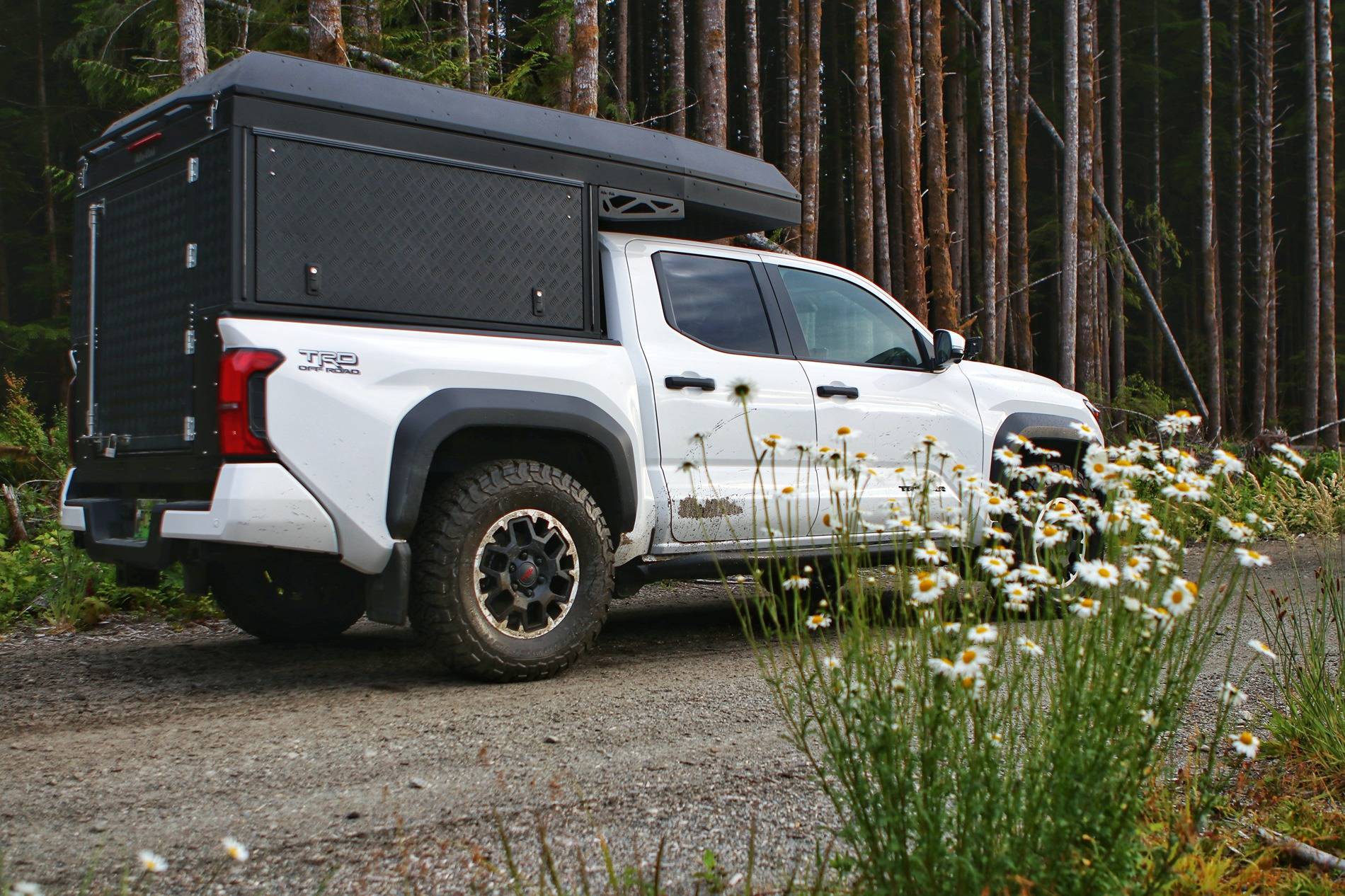

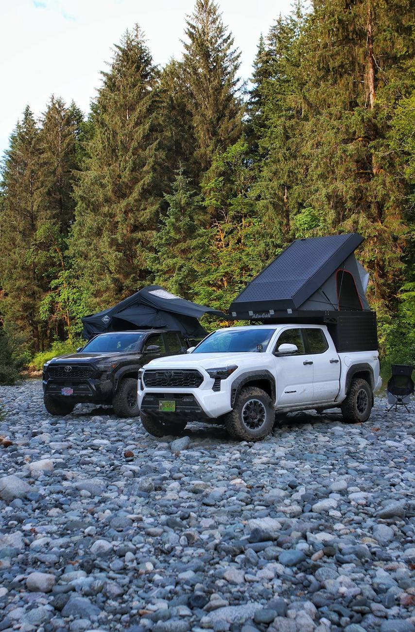

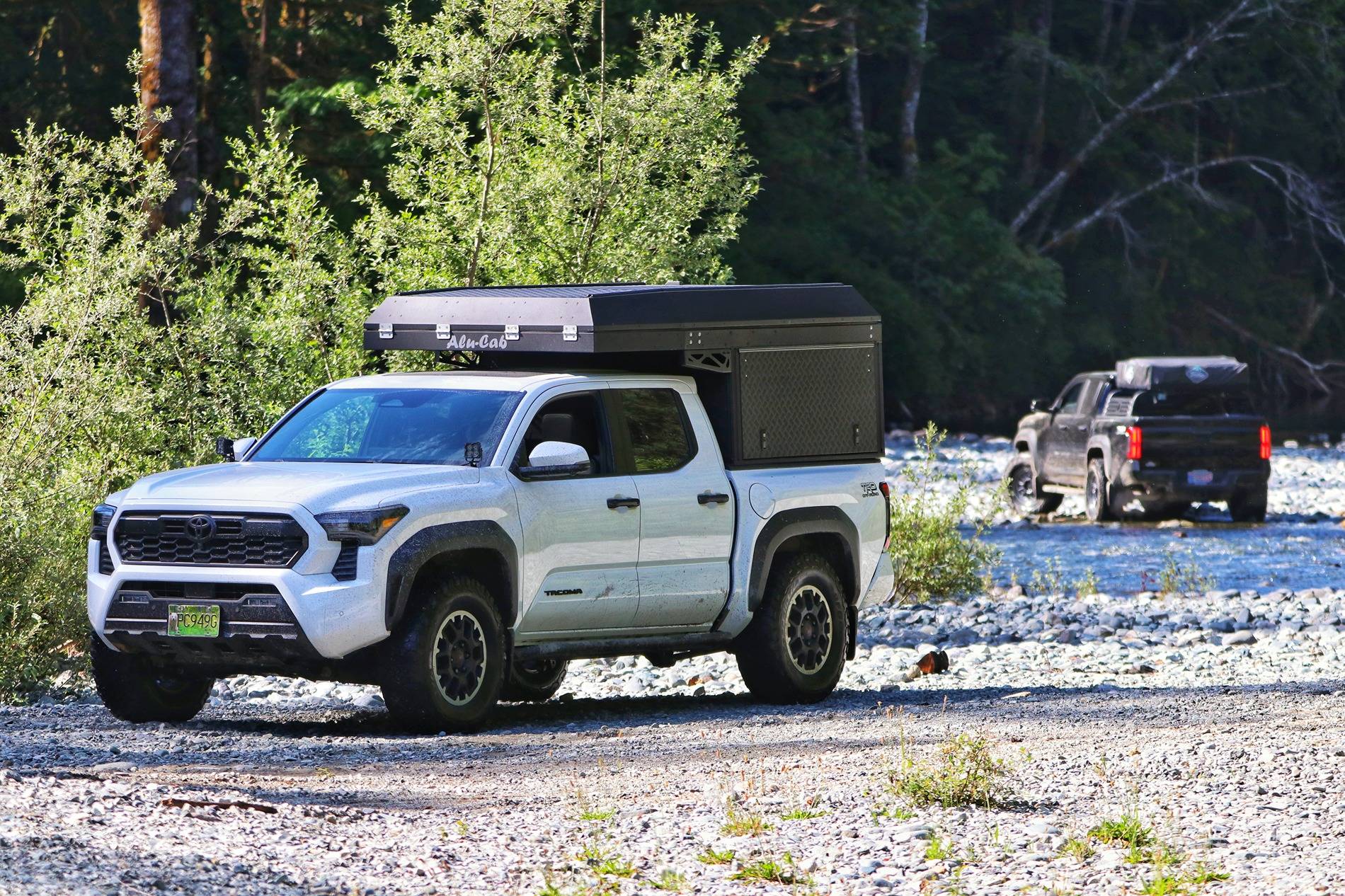

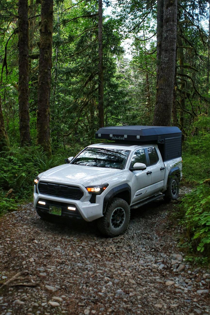

I believe I have the world's first alucab on a 4th gen Tacoma as they haven't made the fitment kit yet and I custom made one.
Pretty stoked, haven't done any suspension mods yet, Interior of the camper isn't built out yet so I will likely need some airbags or stiffer springs once I am fully weighted down..
@greatislandadventures on instagram if you want to see more or follow the build!

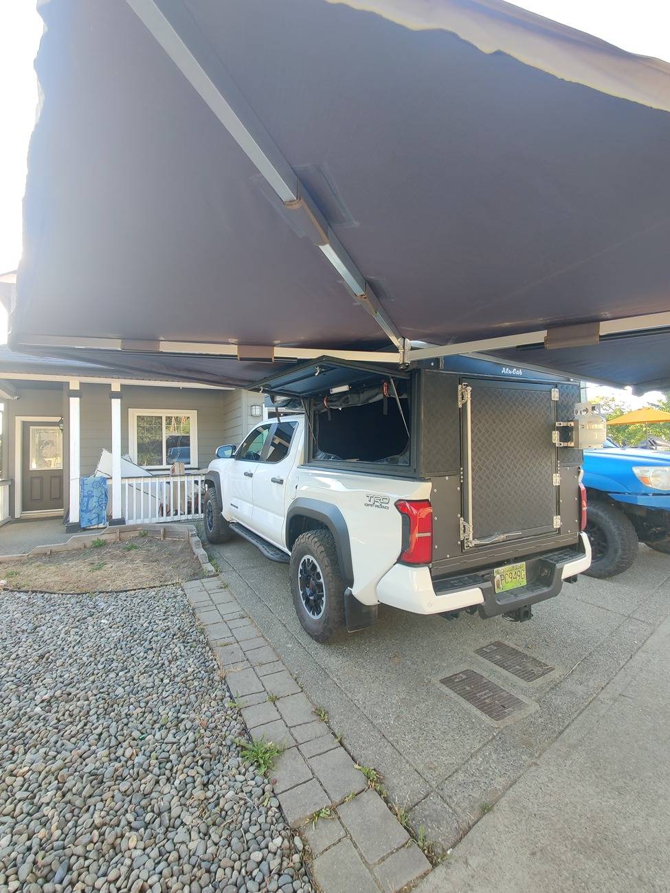

Made progress on the interior and got awning/propane on.
Gotta buy some more material for the tops and then work on plumbing and wiring in the battery.
