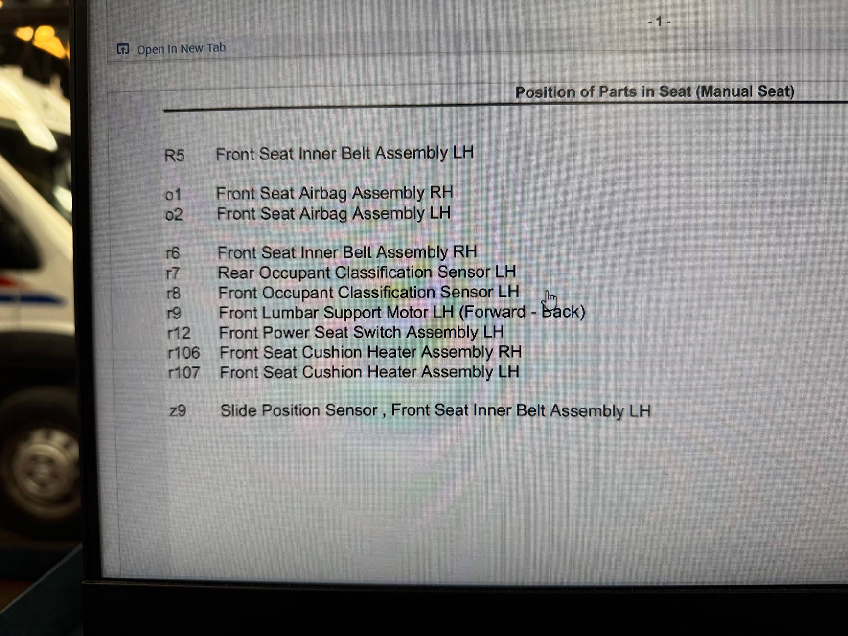

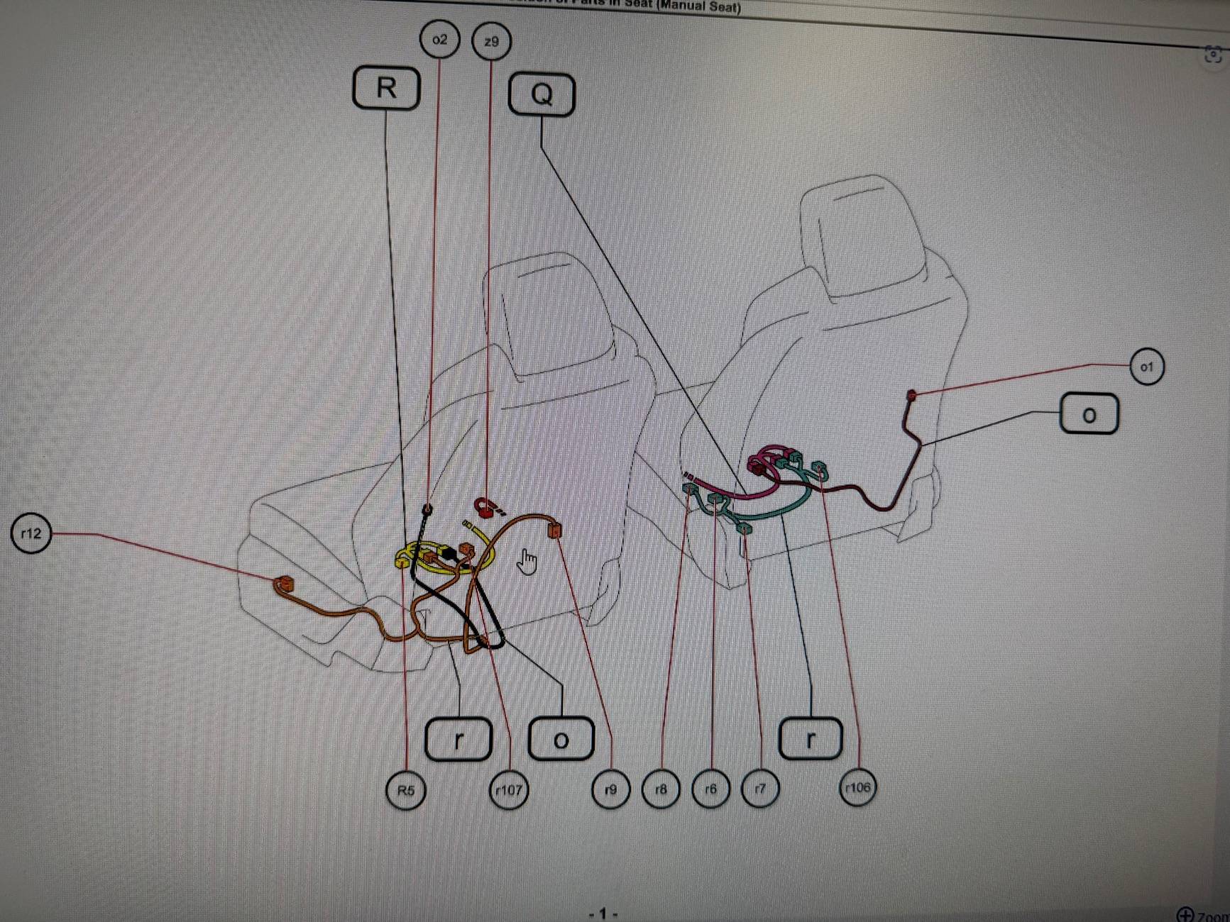

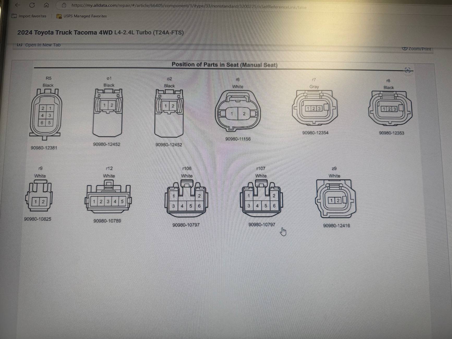

My 24 Tacoma didn’t come with heated seats so I bought a kit and want to add them. The thing that bugs me is I cant find square switches that fit in the existing locations that have labeling for heated seats. I bought a climate control display with the factory heated seat switches but need to figure out how that gets wired to the factory heated seats. I only have three plugs in mine - Airbag, Lumbar, and seat belt so it is not prewired from the factory. Any help would be greatly appreciated.
