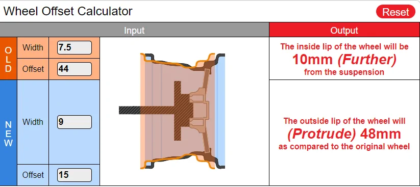

The offset of the wheels can be either positive or negative or zero. If you are asking about a positive 60mm wheel, that brings the assembly inward. A negative 60mm sets the assembly outward, although 60 is not a common offset. The positive 15mm wheel you are looking at will poke approximately 2 inches. The hub bore on the gen 4 is 95.1, so a larger 106.1 will fit over the hub. If factory is +44 then the +15 would look like this.
Thank you, that helps a lot! I have no idea where I read that those wheels were 60 mm offset!
