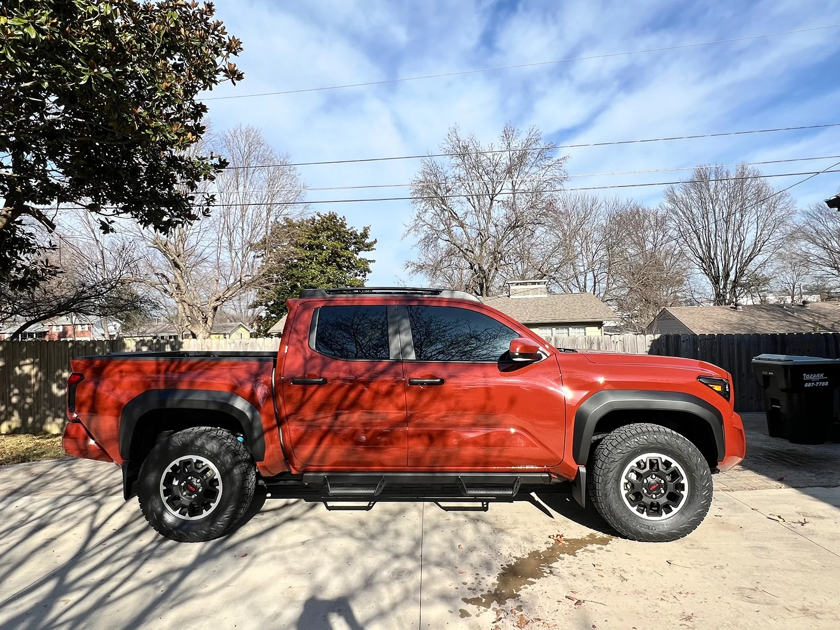

2024 TRD OffRoad, stock suspension
Going by wheel well opening, i have 37" in the rear and 35 1/2" in front
If you measure the lip on the bottom of the rocker panel, i have 16 1/2" rear measurement and 15 15/16" in the front.
So if i did a 1 1/2" front lift, it would even out the wheel well openings but in my opinion it makes it look nose high if you go by body lines and bottom of rockers/cab
