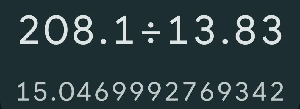

What’s the gallon amount after you refill back up?
Hey I finally just filled up, been since Christmas I last filled up. Put about 14 gallons in and my estimated range was I want to say 330
yoyotaco
yoyotaco
Dec 8, 2024
seattle
2024 trd off road hybrid
damn so 4 gallons left after your light turned on

My normal estimated range is also in the 220-230 range consistently. I frequently run it down to about 20 miles or less left, and then fill up in the 15 gallon range.

Light didn’t come on, it was estimated to be 50 miles left and was solidly at a quarter tank by the gauge, I try to fill up around there every time
