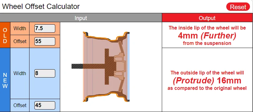

The TRD wheels would be 18X8 with a 45mm offset.
Thank you! Do you know the weight of these?
Also between the stock vs the TRD wheels and the slight wheel width and offset, would the TRD wheels have slightly wider stance? And would the stock Limited rim have a slightly higher stance being only 7.5” vs 8.0”?

Wider stance yes. 8” is the width. Wouldn’t effect height.

These wheels show to be 28lbs. The offset and width will give you a greater stance.
