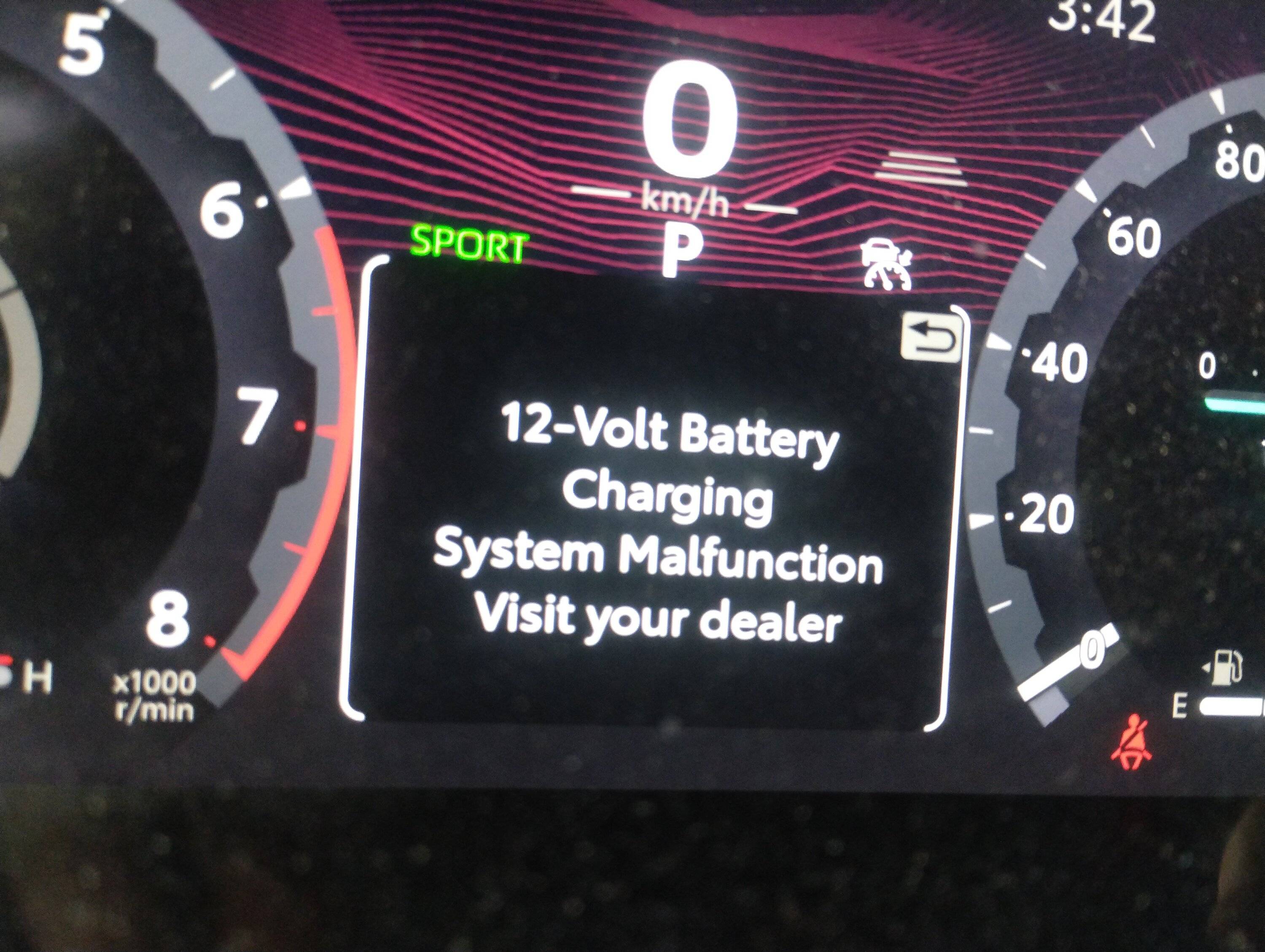

Loose battery cables was cause of error message "12-Volt Battery Charging System Malfunction"
Crzn
Ben
Apr 14, 2024
Today I was driving my 2024 Tacoma and the 12V charging system malfunction light came on. When I went to put a multimeter on the battery to see if it was charging the negative was just swinging in the breeze. Figured I'd let you guys know just to check your own.
