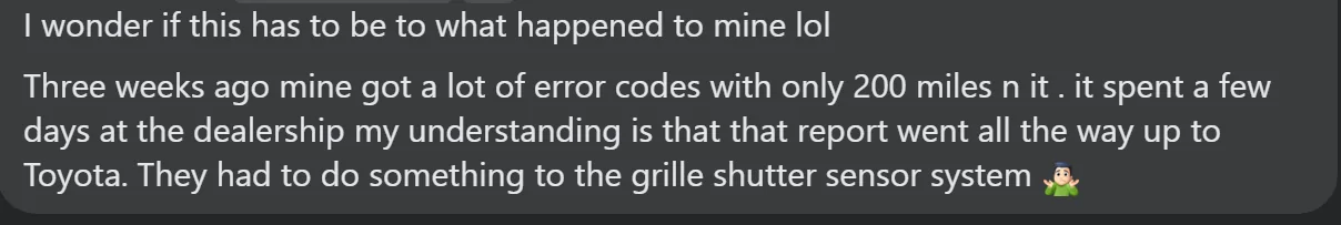

Not sure you all saw this discussion on FB. Same issue!... Not sure if these folks are on this forum...
sorry, but in what way does this post suggest these are being held for the same issue?
