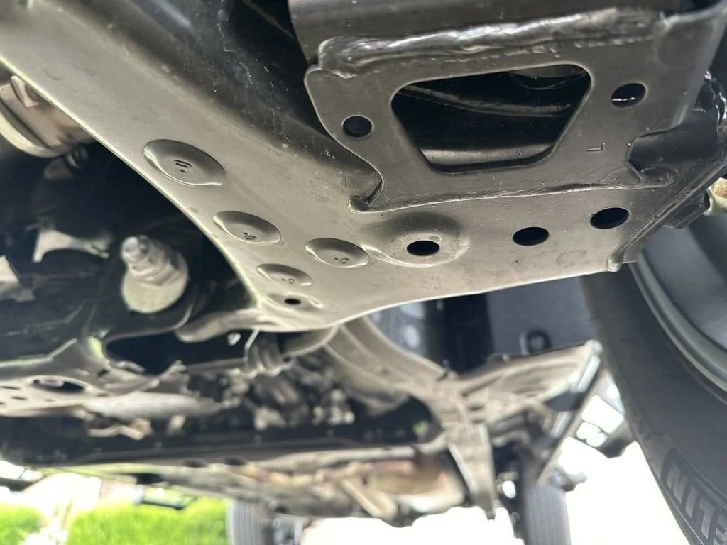

The 4 holes that need to be plugged on the lower A-Arm are angled slightly down and the main drain hole on the bottom is where all the draining will occur.

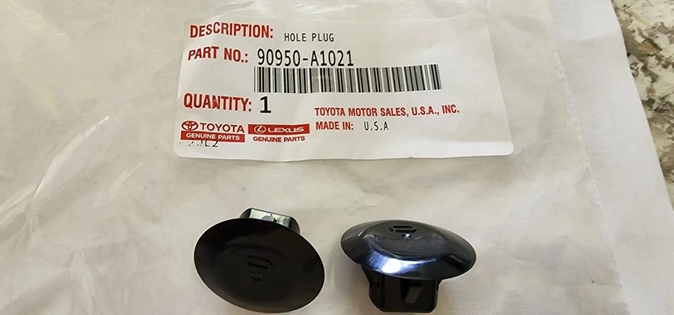

Do you have a link for purchasing the plugs? Thanks in advance...
No link but here is the part number you can order at whatever place has them... you'll need 8
2024 Tacoma Lower Control Arm Plugs After Removing Air Dam Lower A-ARM Plug Part Numbers
