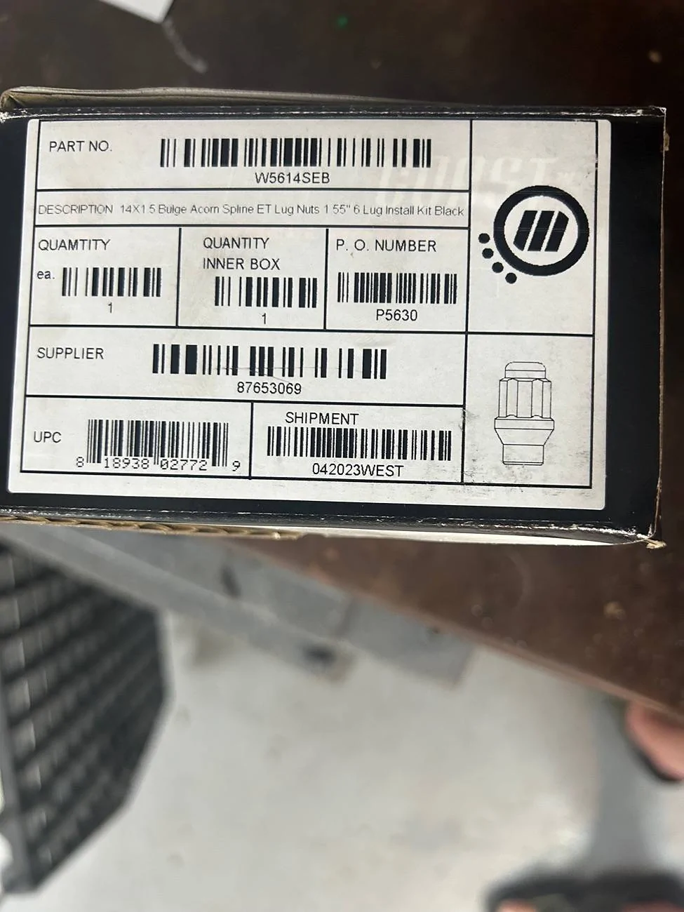

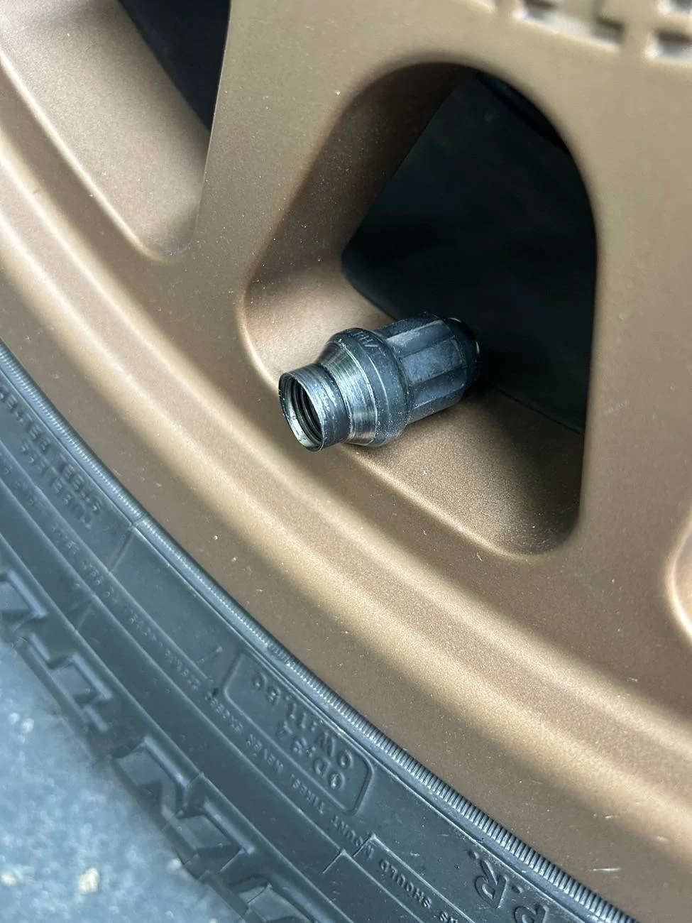

The lug centric nuts that I ordered with the 703 Method wheels have an 11 thread (11 rotations) contact.
2024 Tacoma Method wheels lug nut question IMG_6832
2024 Tacoma Method wheels lug nut question IMG_6834
2024 Tacoma Method wheels lug nut question IMG_6833
