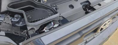

hey all,
got a tacoma from auction and came with the whole front disassembled while putting it together l see there is one plug l got no where to plug into.
can yall help?its the connector right next to the intake,
2024 Tacoma missing connector? 1745262116652-w

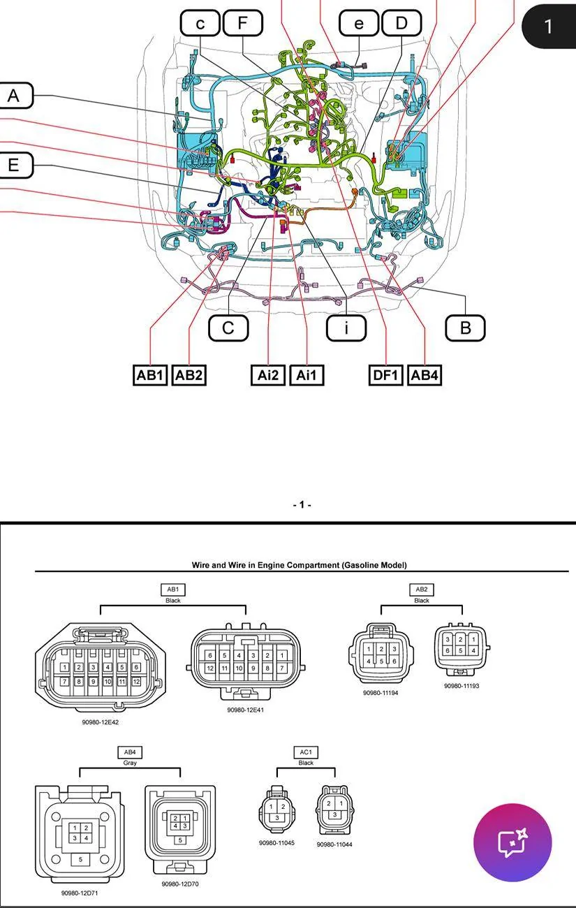

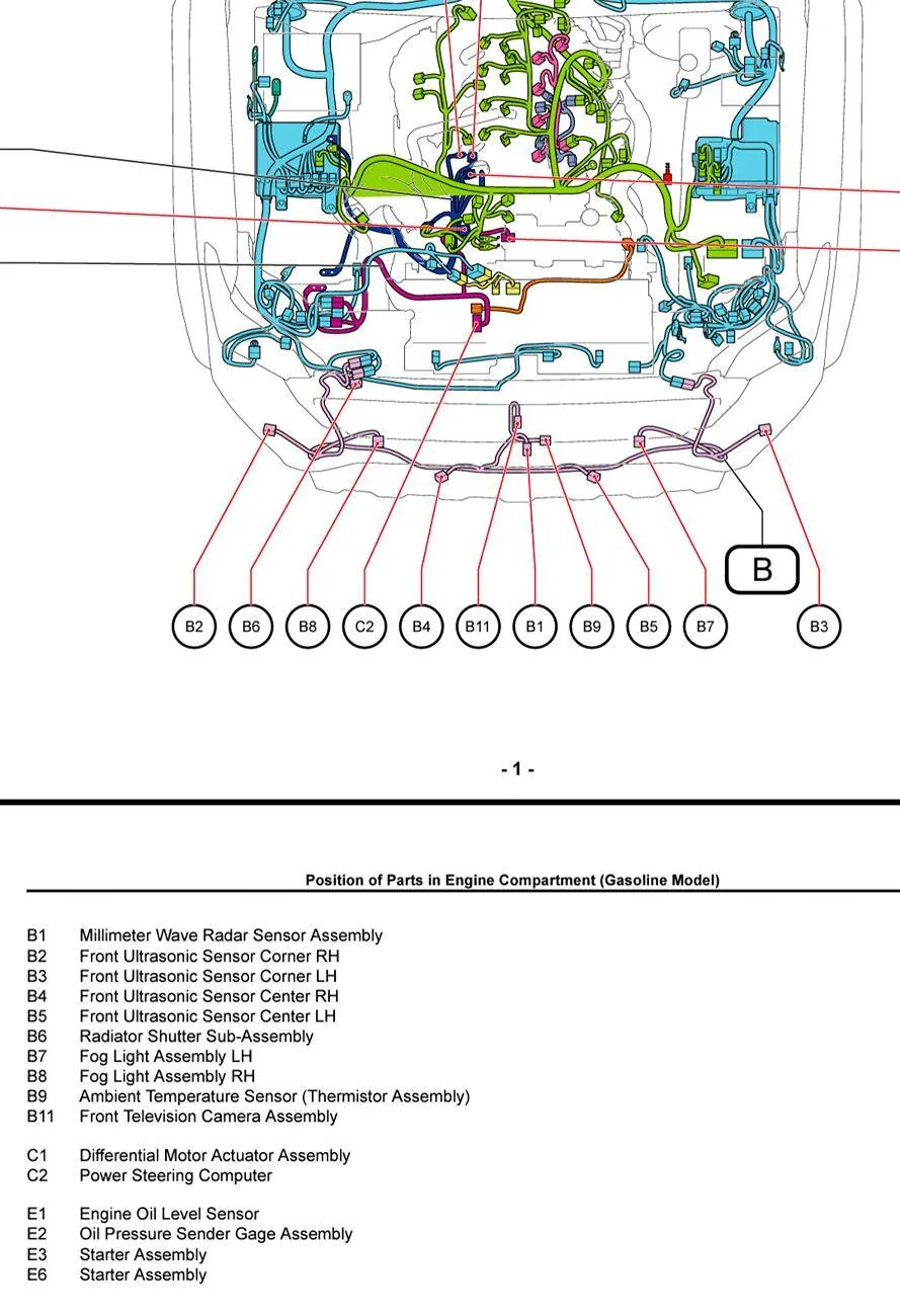

Going from memory, but I thought there were the plugs right there feeding to the face: front camera, radar array, fog lamps.
Everything you'd need to unclip for removal of the face assembly.
Do you have all three of those on your trim?

mine is the standard sr5 no upgrade package or anything

thank you, you the MAN!! l guess its between radiator shutter (makes sense l ordered one since the one it came with was broken)but when l assembled the front back l though it had just one connector close to the cruise control radar , once l get the grill shutter time to take another look at it.
