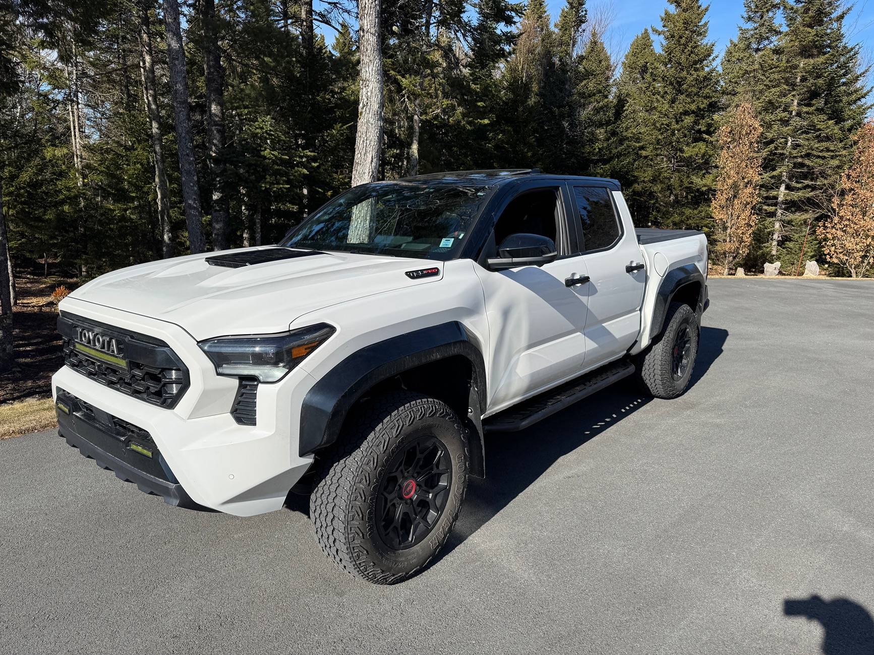

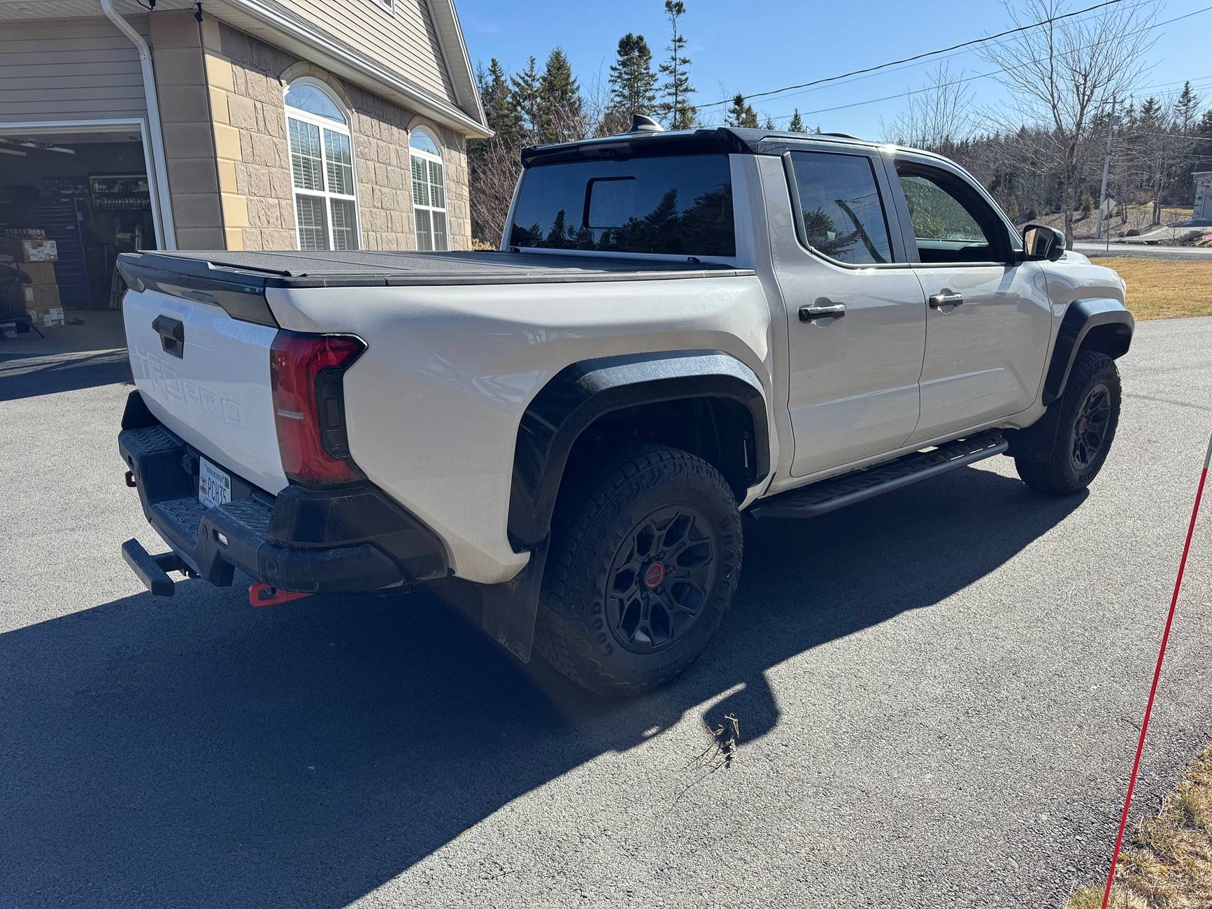

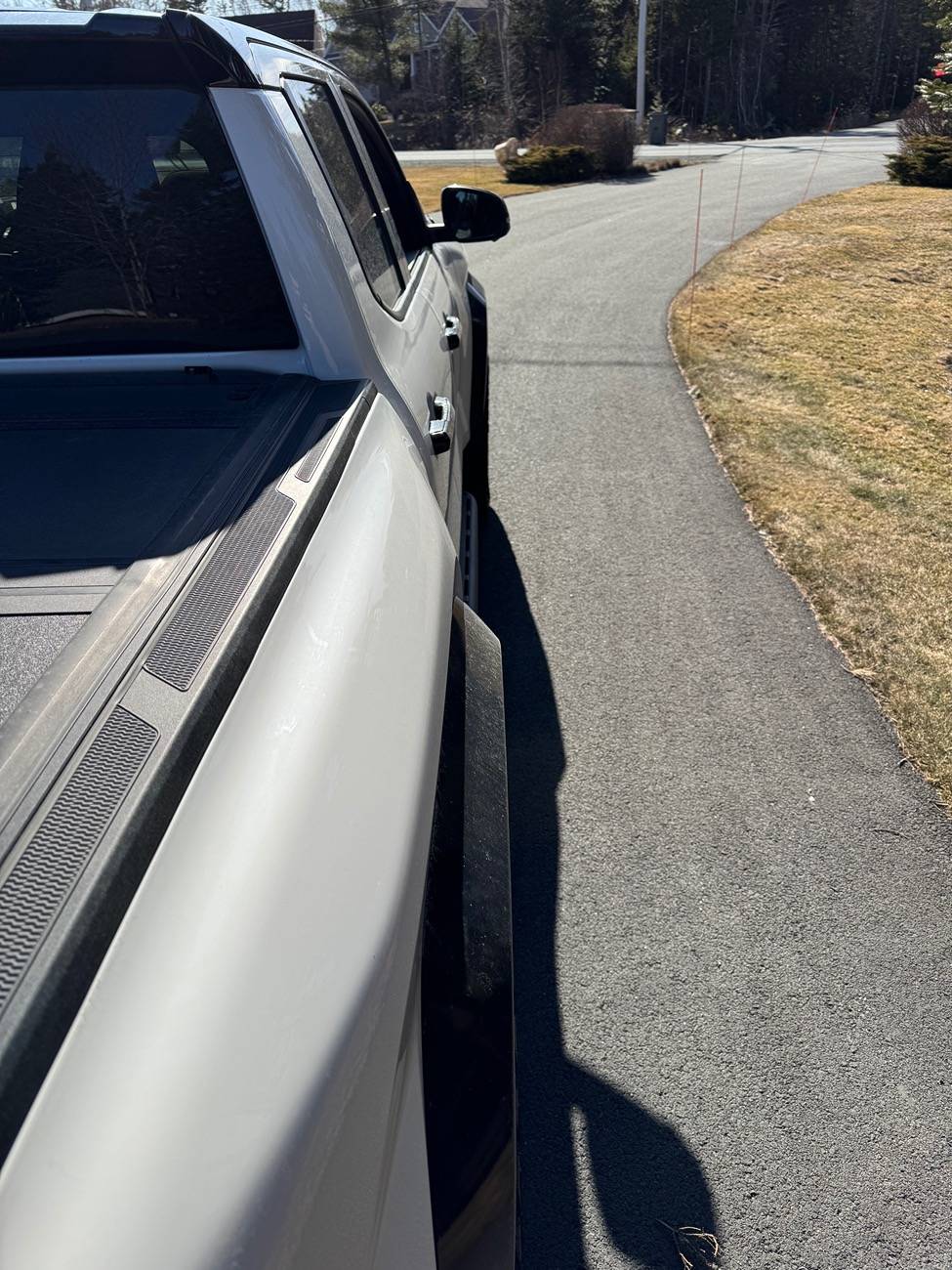

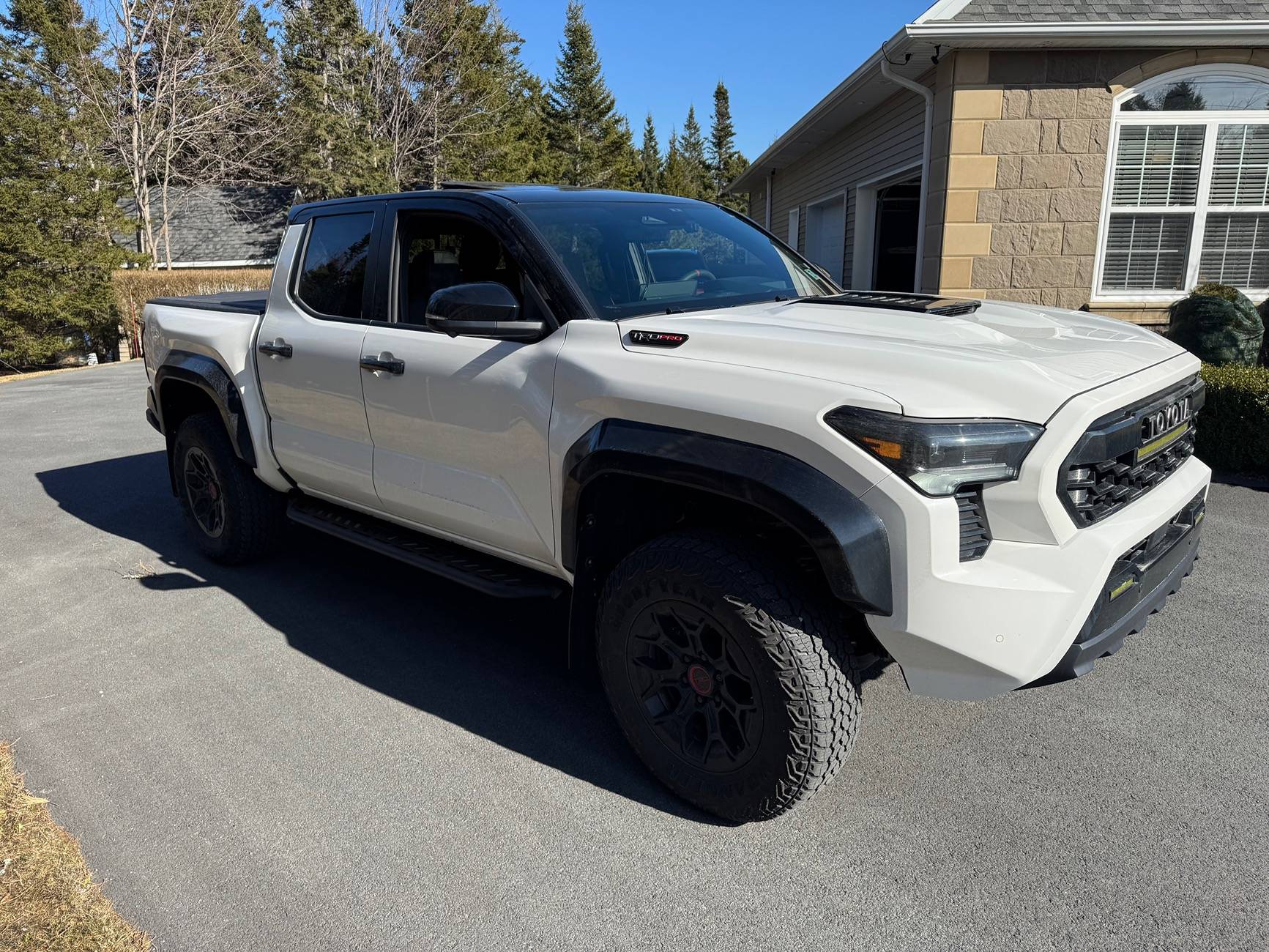

Things I’ve added but haven’t exclusively made a post about
rokblokz rally mudflaps
OEM tonneau cover
weathertech floor mats
screen protech kit
musolgy glove box organizer and centre console organizer
rigid industries ARB bumper lights from @SPV Parts
and now Greenlane Offroad aluminum rock sliders proudly made in beautiful British Columbia, Canada, no there isn’t enough room to install rock sliders without removing the factory rocker protectors , it was a question I’ve wondered
only other things I’m planning to do this year are some BFG KO3’s whenever I can decide on a size, and if I can afford new Rokblokz when they finally release the TRD Pro version those

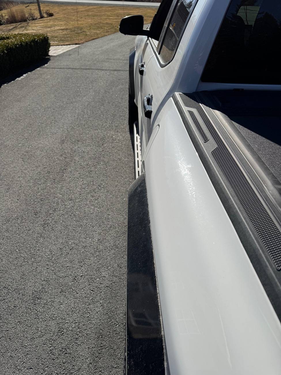

I like those Greenlane boards, my choice as well, currently waiting per the nice people there in shop, told me to check back, Concern was tariffs on Aluminum. They look great, nice and light ….truck looks great

Thanks I'm very happy with the fitment, I did NO modification, I'm a 14 year redseal welder/fabricator/weld supervisor and I'm impressed with the quality
I'm not sure what the tariffs are doing for your neck of the woods but I hope you can get a set, they're really worth it, I think mine took 7 weeks to arrive from order to delivery, they're on the complete other side of my country

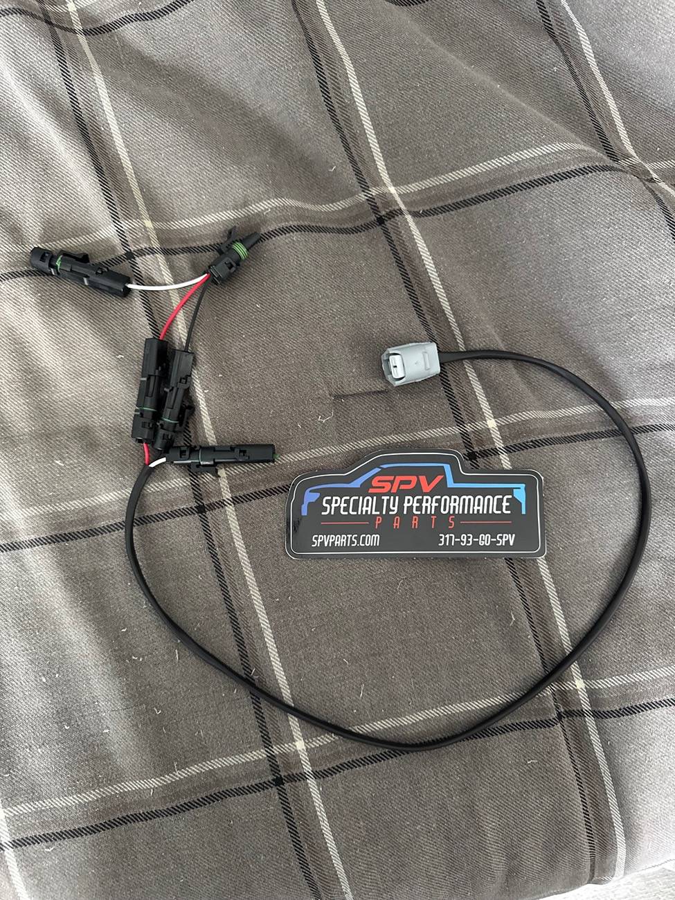

John thanks again for the fantastic customer service and sending me this new 2025 wiring harness for my Rigid lights, can’t wait to get this installed and tidied up

No problem.
So that is a pre-production one.
Basically what it allows is for you to choose to connect EITHER of the 2 switches that Toyota sends back there.
The red wire is switch 1. The white wire is switch 2.
If you have the tail light connector which powers the backlight automatically with the running lights and the white light with the reverse trigger. You can just plug in either switch 1 or 2 to power the white light with a switch.
If you don't have the tail light adapter and want to turn on say the red backlight with switch 1 and white with switch 2 or vice versa, you can plug in both.
I am working on replacement pig tails for the front as well, which will allow you to have all 3 or 4 switches come to one connector each and then a pig tail with the 2 single connectors (mating) that go to your pass through. This way you can plug any switch you want to them or none. The single connectors then also match all of our plug n play harnesses.

Thank you! I gotta check and make sure I have power to the rear this message solved my issue I was thinking from the email, sorry if you called earlier I was having an after work snooze ?

I finally got to mess around a bit more with this, I can only get aux 3 to work, and it’s the red halo lighting up, never the white flood light, on the little single connectors the white wire is hooked up and aux 3 fires the halo, with the red wire hooked up, nothing happens on any aux button, I’m at a loss
