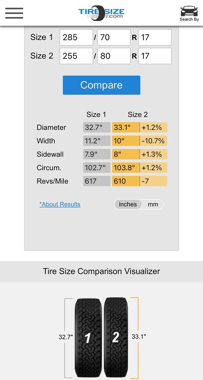

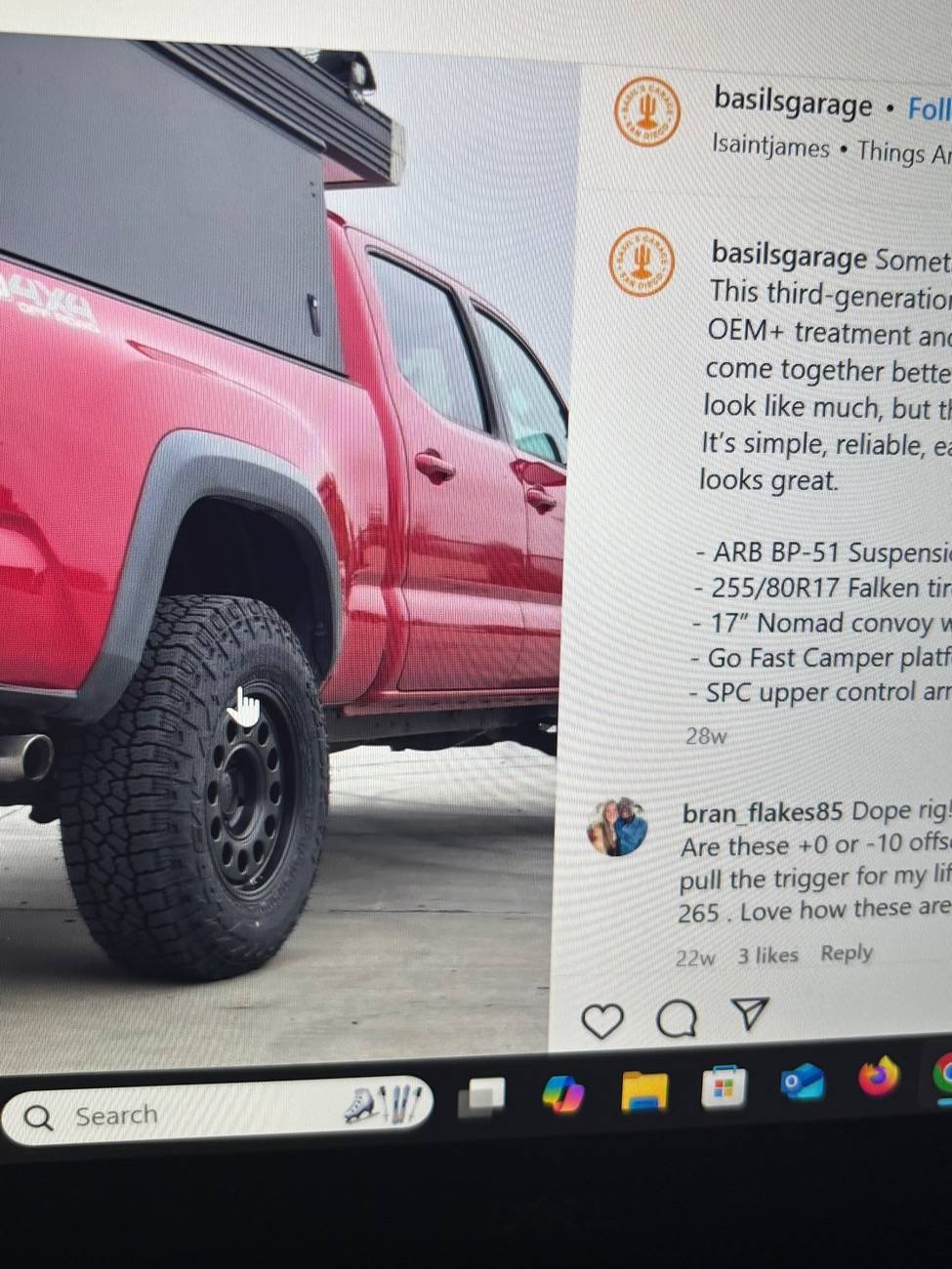

I love look of the Nomad Convoy Wheels ( Shop Now – Nomad Wheels ). They come in a +25 offset in 17" rims, but it's not clear whether that's going to be sufficient to mount a 255/80R17 on a stock TRD OR without any lift. I suspect it will, given how this works on the stock TRD OR rims. However, the offset on the stock rims is much greater than +25. These are fairly narrow tires, which would help mitigate rubbing on the inside of the wheelwell, but the diameter is a smidge larger than the 285/70R17s people are fitting.
Has anyone tried this combination?
