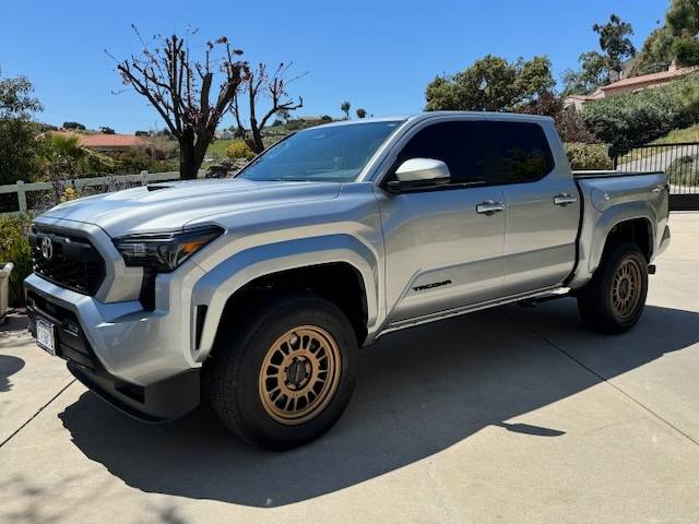

Method 318 +25 offset wheels w/ BFG KO3 = flush with fender flares

I think it’s just his angles were different than mine. Check out any of the westcott designs builds? He runs +35 and that is super pokey to me.
For me the +25 was the sweet spot with wider tires.
I’ll try to replicate one of his front angles and post updated photos.
Wouldn't +35 offset have less poke than +25 offset though? I thought stock was like +45.

The method 318 and KO3 are awesome- I can’t wait to try the new KO3s as I have nothing but positive experience with KO2s

That would be correct. The higher the positive number the less poke. :like:

awesome setup with your method 318 and +25 offset. You posted this in April 2024. It is now February 2025, 10 months after. Still no rubbing? How about now, do you recommend a 1.5 inch leveling kit? Any new thoughts after having it for 10 months? I just got my 2024 Tacoma and I'm leaning towards your setup or something similar. Thanks!!

No rubbing at all with a lot of wiggle room. No lift as of yet but leaning towards peak if I do decide. Very happy with the BF KO3. Still look new after 10k miles!
