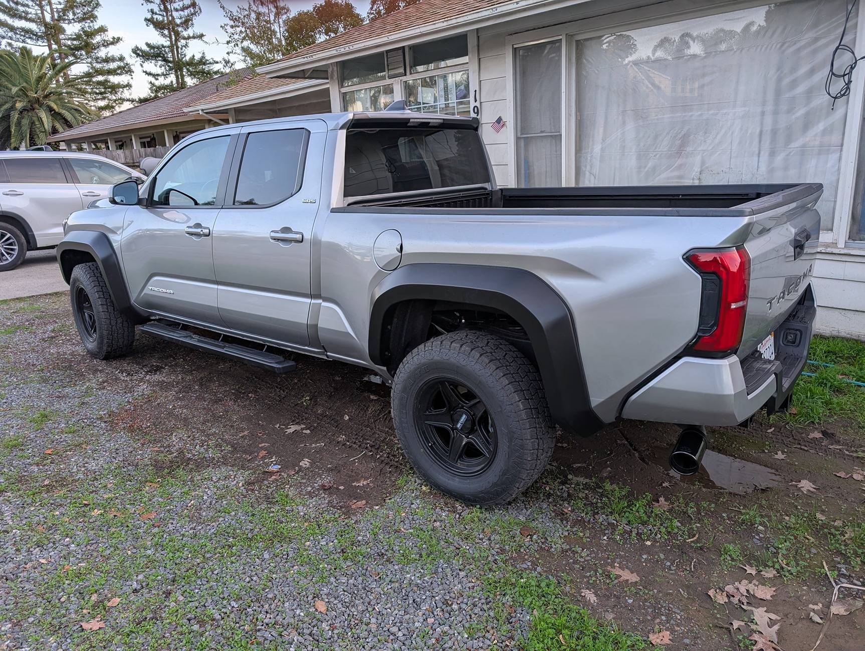

widest aftermarket flairs r the Rough Country from what i found , i got the black matt but $300 mo u can get them paint matched
2024 Tacoma Off Road VS PRO fender flares? PXL_20241231_004431740
I had a 1 1/2" Poke & these cover the tires great way way less mud on my sides now , i had yo lose the weathertech mud flaps but these look to give great coverage
