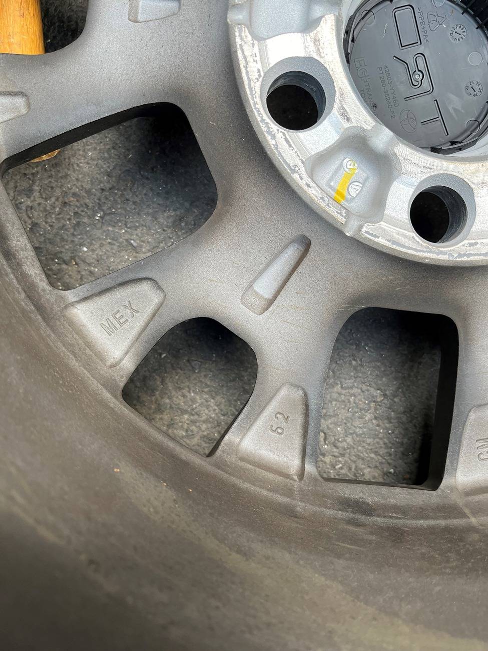

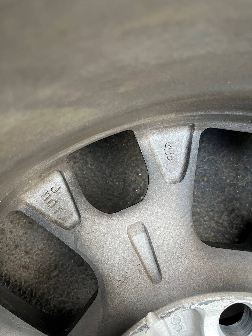

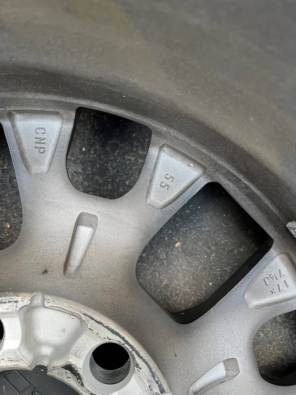

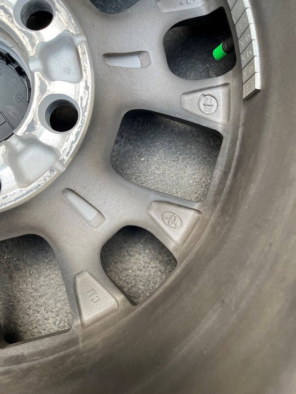

I have been trying to confirm my offset on a stock 2024 Tacoma off road.
I pulled the tire and have these markings on the inside. I have heard both 55 & 62 for the offset.
Markings are: 55, CNP, JDOT, Mex, 62 CM, 23/12, 7 x 7 1/2.
It has both 55 & 62...which is the offset"
