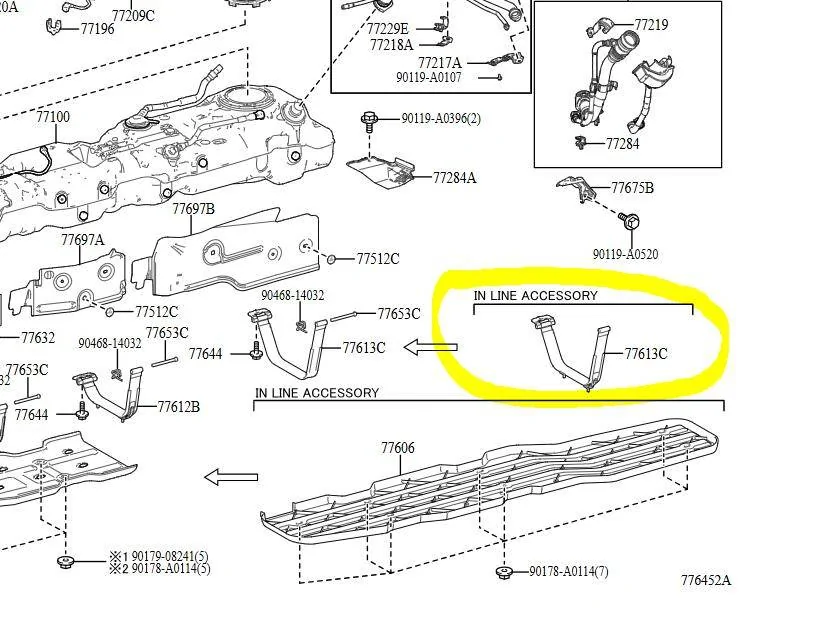

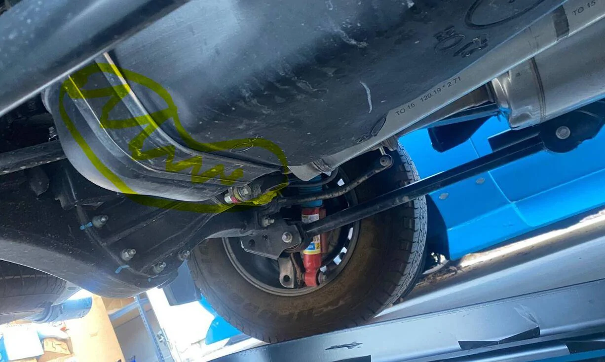

Hello, I recently received my OEM Fuel Tank Skid Plate (Part #PT938-35244) and when I went to install it, I found out that you either have to buy the rear most tank strap with the mounting studs separately or that Sparks Parts did not include it with the skid plate if it was supposed to be included. I have searched the internet for hours trying to find the actual part # for it to no avail, I believe someone with access to the Toyota TIS can help me. Attached are pictures of the mounting strap without studs on my truck, and the parts diagram that has the mounting studs but only a reference number not an actual part number. If Sparks Parts ever gets back to me, I will update the thread with the part number for the proper fuel tank strap with mounting studs to save future headache for people in this forum. You also need 2 nuts (part # 90179-08241 ) to mount the full length skid plate to the mounting strap with the studs.
2024 Tacoma Part # Help - OEM Fuel Tank Skid Plate Mounting Strap fuel tank stra
2024 Tacoma Part # Help - OEM Fuel Tank Skid Plate Mounting Strap fuel tank strap no studs

77613-17020?
only $10 may be worth a shot to try bc its so cheap? If it happens to be the exact same strap in the picture, maybe you can study how the front two look and then go to Lowes and try to make your own with the new strap?

I have experienced the exact same issue while fitting a set of Trailhunter underbody protection to a TRD OR. Ordered the fuel tank skid protector that goes on a Trailhunter, as stated, part # PT938-35244, but it requires a different rear fuel tank strap with attached studs and nuts, to secure the rear.
The part numbers for these are:
1) Rear fuel tank strap: 77603-04020
2) Nuts (2 needed): 90179-08241 (I have seen somewhere that these referred to as 90178-A0114, but this was a previous part # and has been superseded).
All were fitted this week, so I can confirm fitment. Nuts torqued to 27ftlbs.
I hope this helps others avoid 2 trips to the dealer.
