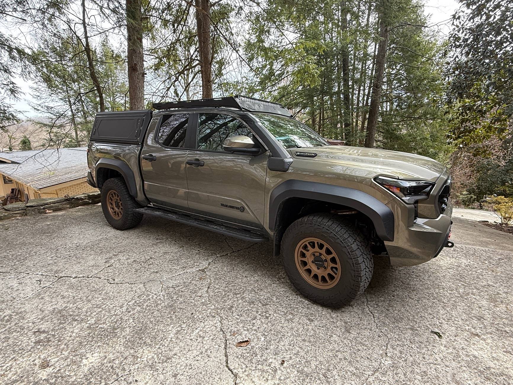

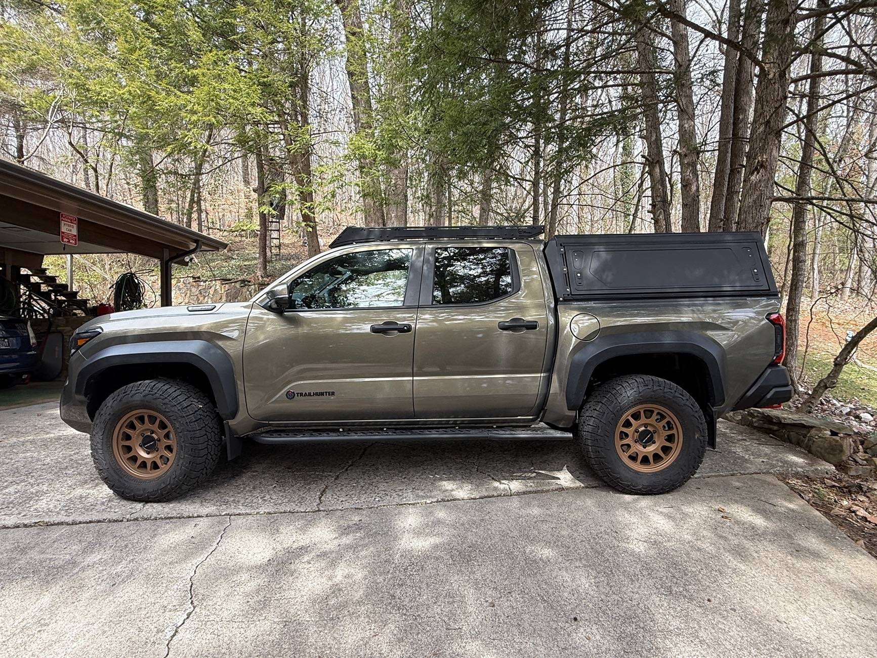

My TH has a Prinsu Pro rack with light cutouts and Rigid light bar.. Very happy so far.. Definitely more wind noise than naked roofline. Solidly built.. Have an AluCab Contour canopy on back and all fit together nicely.. Went with Alucab over SmartCap because of leaking issues with SmartCap..

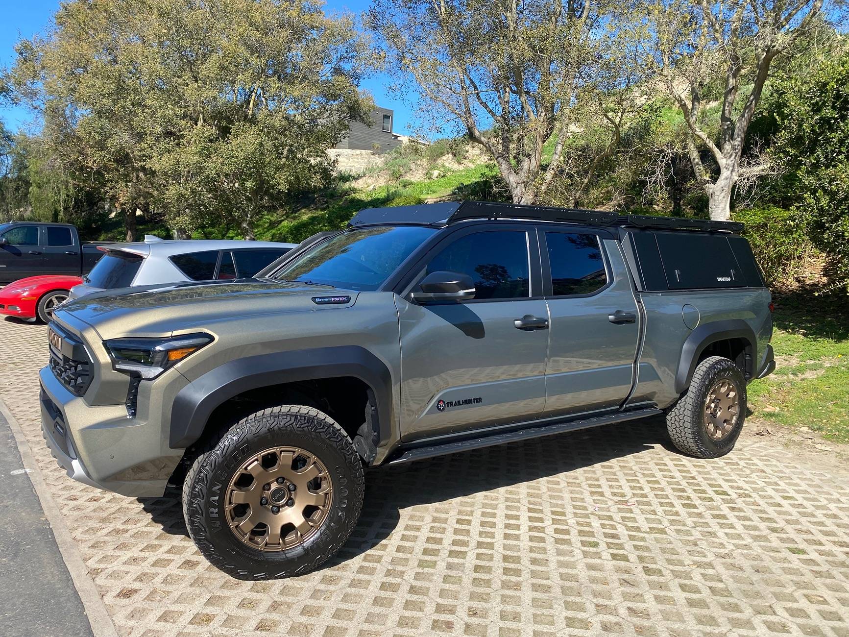

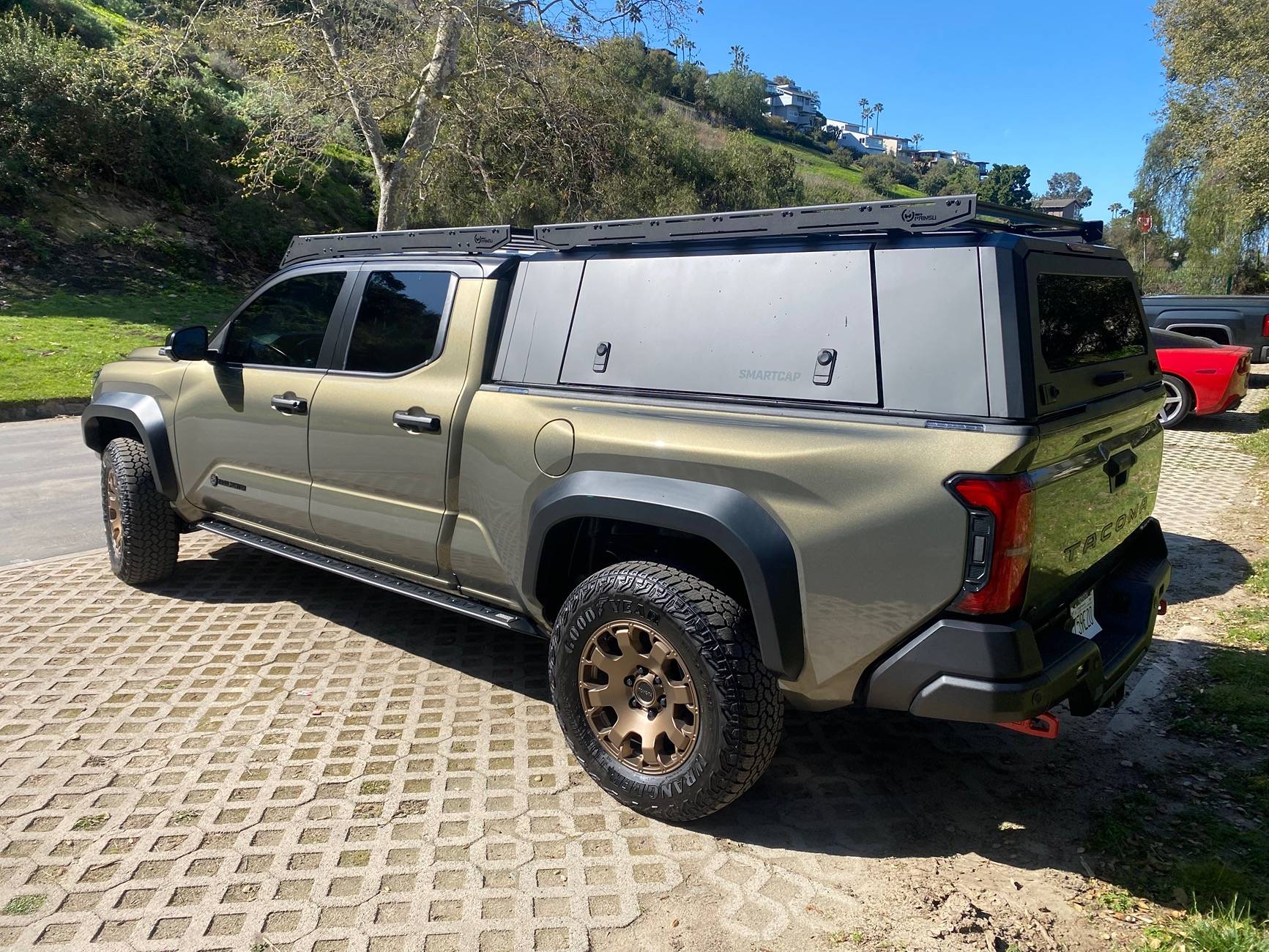

I have the Prinsu Pro racks and a Smartcap mounted on my truck. The front rack installed easily and is working out well. The rear rack was a bit more of a challenge . The hardware Prinsu provides is not compatible with the Smartcap so I had to buy M8 bolts and drill out the mounting feet to allow the bolts to pass through. Be careful drilling through the soft aluminum because it wants to bind up(drill press recommend). I have the rear rack at the lowest position and it is about 1/8” lower than the front rack. My gull wing doors open until they are about parallel with the ground before they hit the rack. I’m going to raise the rear rack by one setting so that it is slightly higher than the front. This will make it easier to slide lumber on from the rear and also allow the doors to open a little more.lm going to add some cleats to the sides of the Smartcap where I can attach ratchet straps because it’s awkward to strap things down onto the Prinsu racks. My last truck (2001 Tacoma) had a lumber rack so it’s an experiment for me to try these racks for work. Still under 600 miles and figuring out the best ways to make them effective. My Smartcap does leak a little but I live in Southern California so it’s a non issue. I torqued everything to specs. Smartcap now makes the roof panel in 3 pieces instead of one to make shipping easier. Overall I am liking the setup and will probably like it even more once I get it dialed in.

I believe that the Smartcap could be effectively sealed. If I was building the cap again I would probably run a bead of silicone along the edge of each panel before they get sandwiched together. There might be an Smartcap installer in your area that could share their tricks for sealing the roof panels. Also, you could have the cap wrapped after it’s built. The doors and windows seem to seal really well.

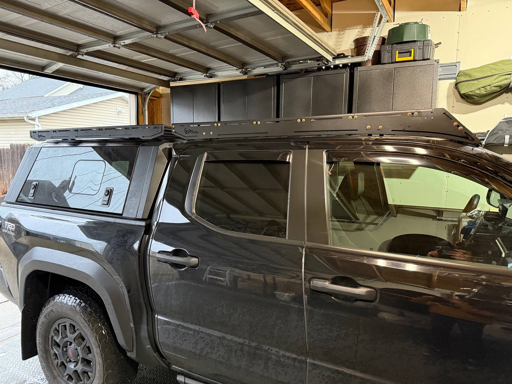

I have both the Prinsu Pro roof rack and top rack on my Tacoma, along with the SmartCap. As Berno mentioned, installing the rack on a SmartCap requires M8 Bolts and drilling a larger hole in the feet for the bolts to fit it. I have the 5ft bed/SmartCap, and with the top rack, I lose most of the ability to use the gullwing doors. It's not a huge deal for me since I camp in the back of the bed and have windows that I can open. But if you want to use your gullwing doors, I would look at a SmartCap-made rack.
Overall, I have no complaints about these racks; they're sturdy and well-made, and I would recommend them to anyone. Right now, I have my solar panels on there with Startlink Mini; once I start camping, I will load up my 270 awning.

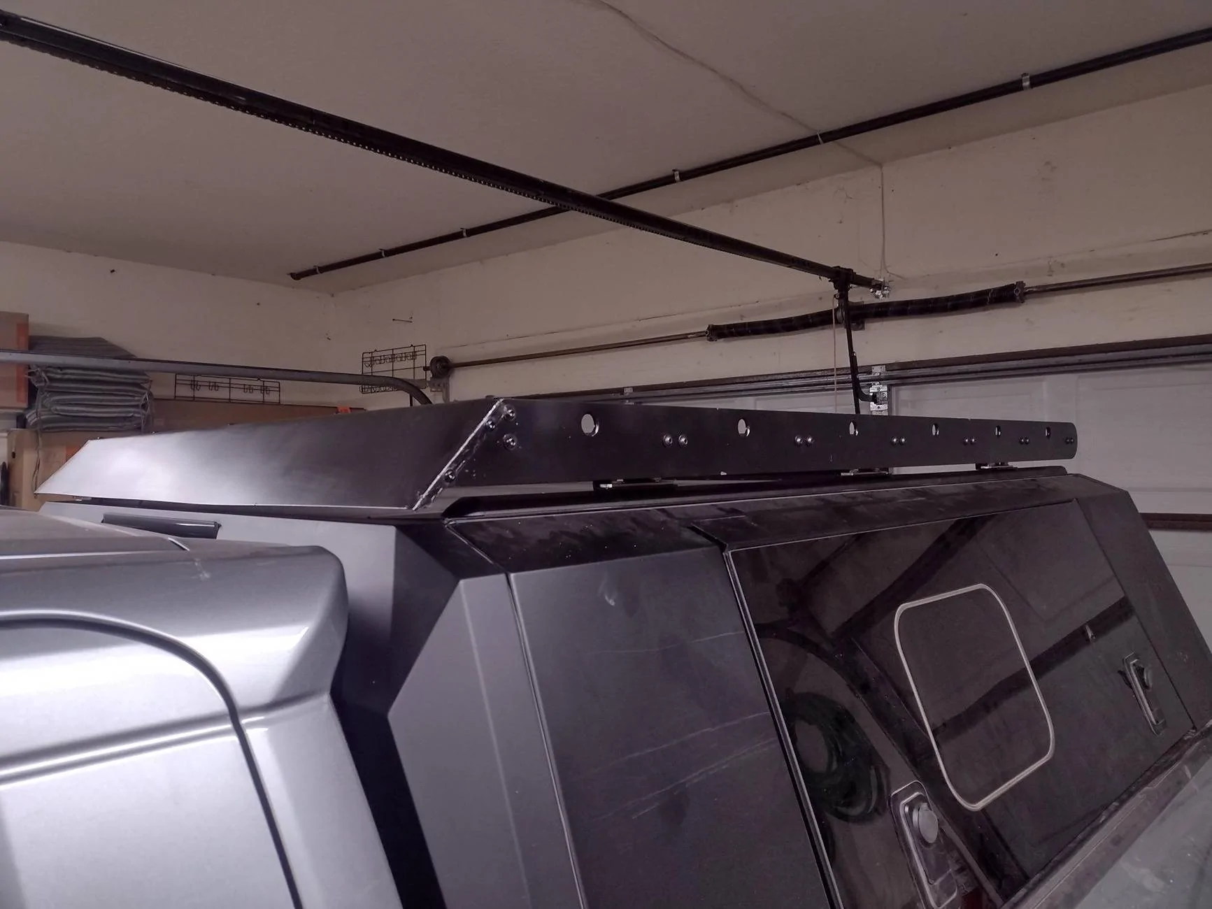

I ended up building a rack because I wasn't sure about the fit of the Prinsu one (plus it was not clear just how long delivery would take and I had a trip coming up). The trick with the gull wing doors was making the rack a bit narrower than the cap.
As far as leaks are concerned, I'm planning to use RV roof sealing tape if it is a problem. Have to check with my nephew about which kind he used that he said was very good.

That's awesome you fabricated your own. I was thinking I could modify the crossbars on the top rack to the length you have here. But I do like how the roof rack and top rack align, and as I mentioned, I don't need access via the sides.
I did put some rubber edging along the bottom of the Prinsu top rack, so I don't scratch the glass if I open the gullwing doors a bit.
