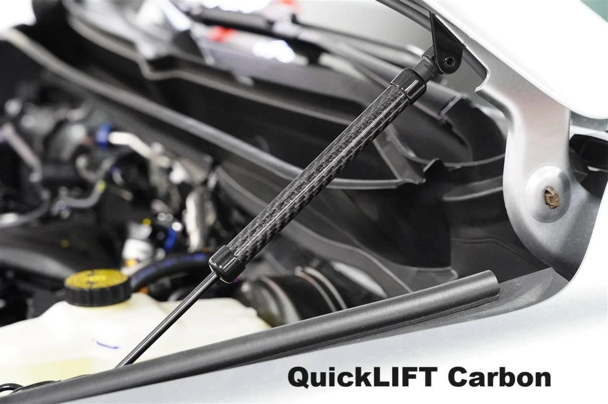

2024 Tacoma Rough Country Hood Struts installed on Trailhunter mldzina-jpg-
QuickLIFT Carbon :
Real Carbon fiber sleeves that can be added to our PLUS system as an option.
