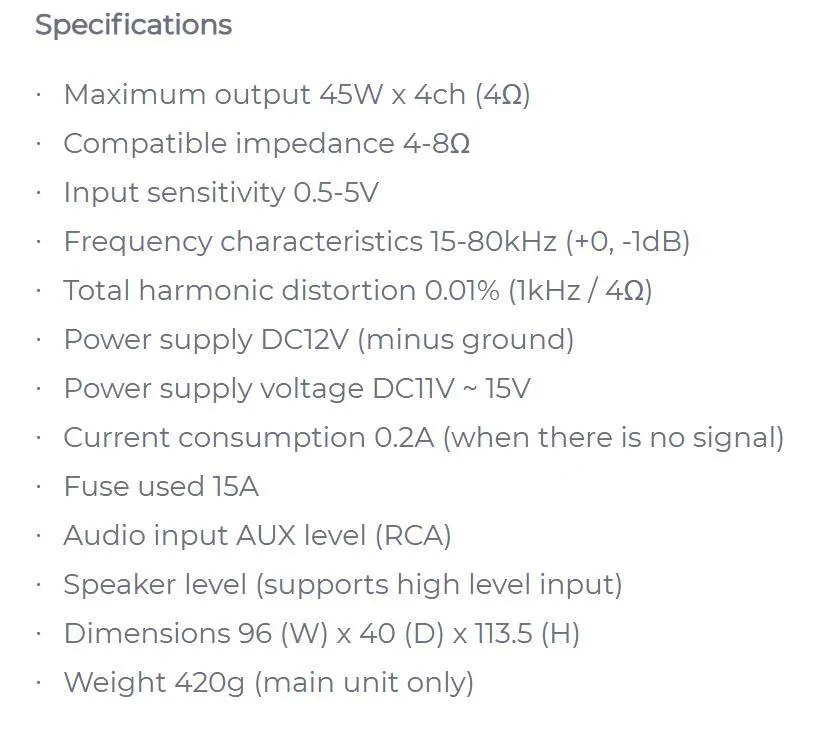

I'm waiting to hear more positive feedback on the Beat-Sonic solution. This may be the better option with or without speaker upgrade.
