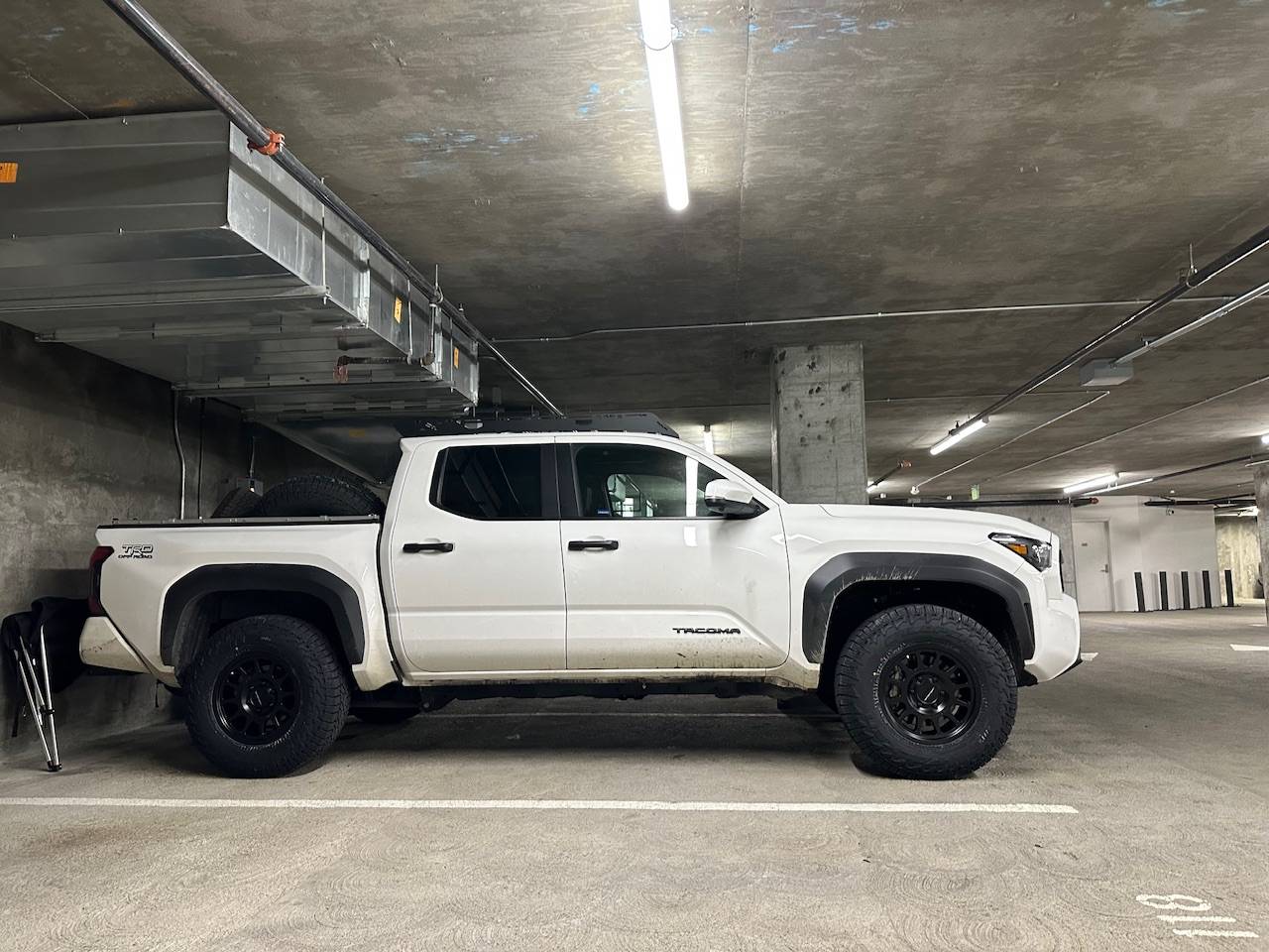

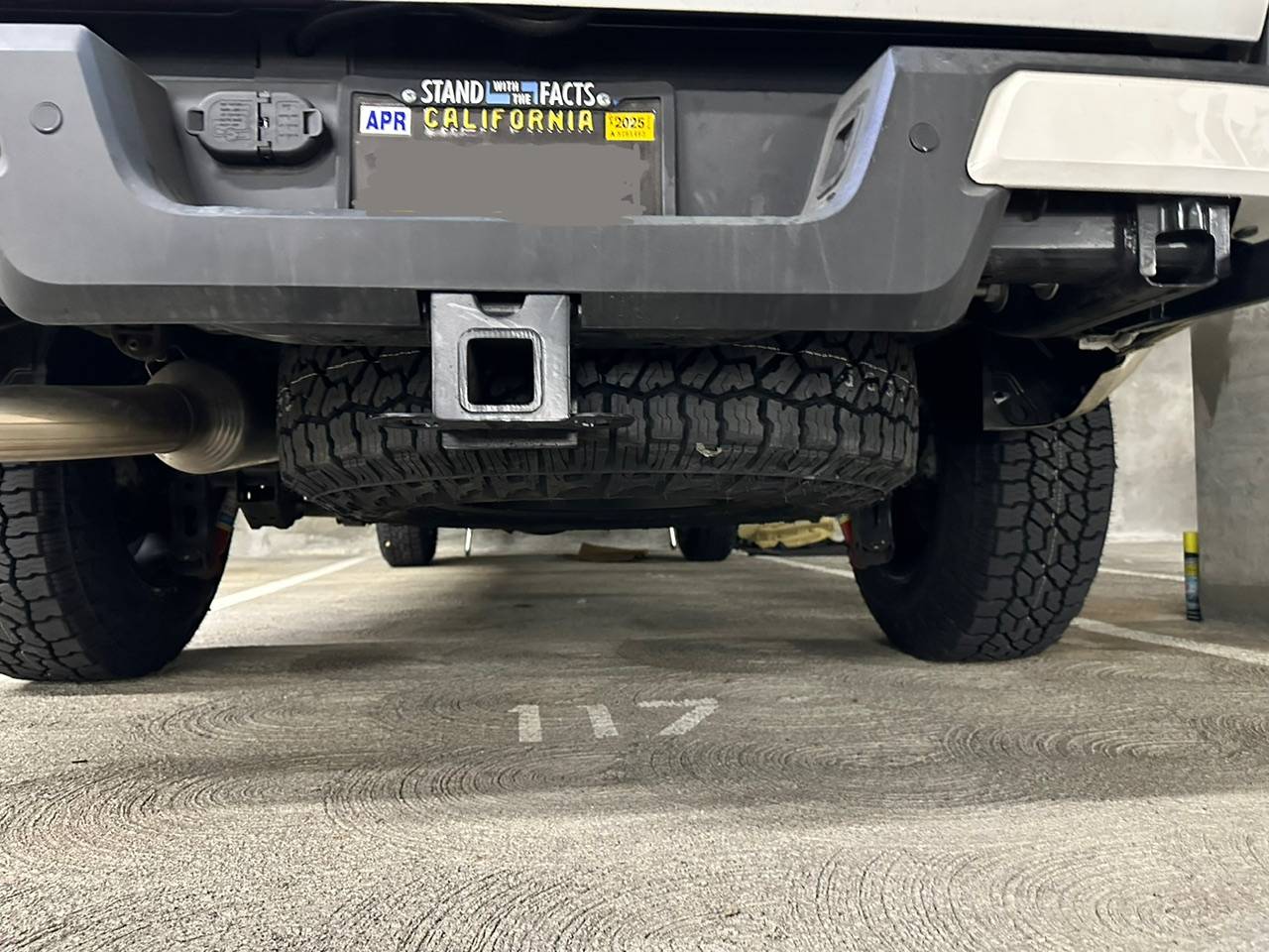

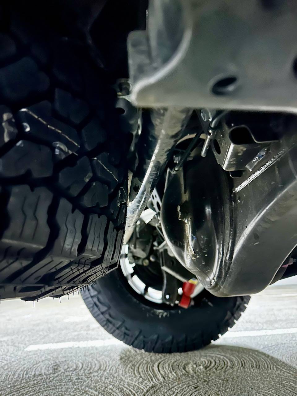

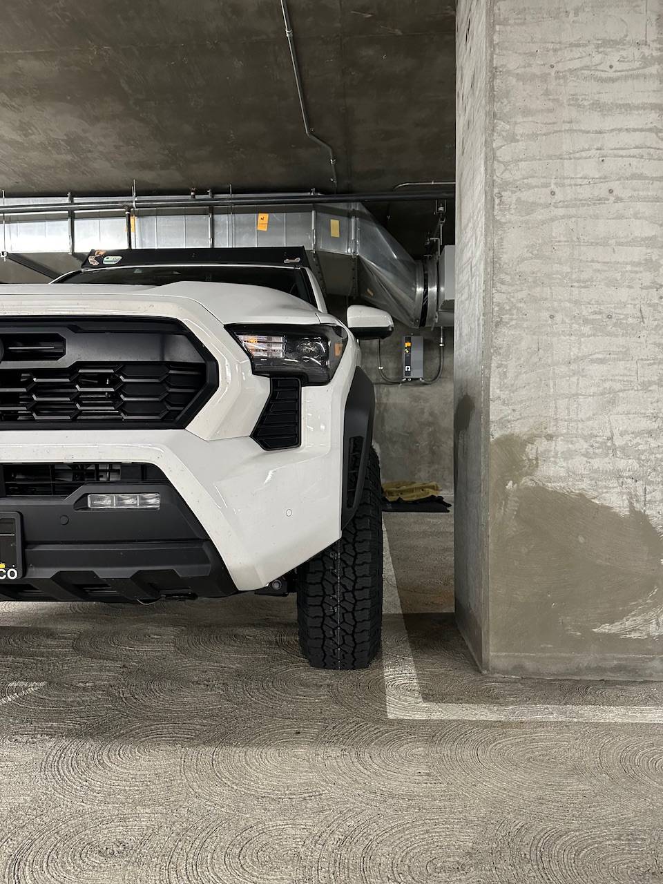

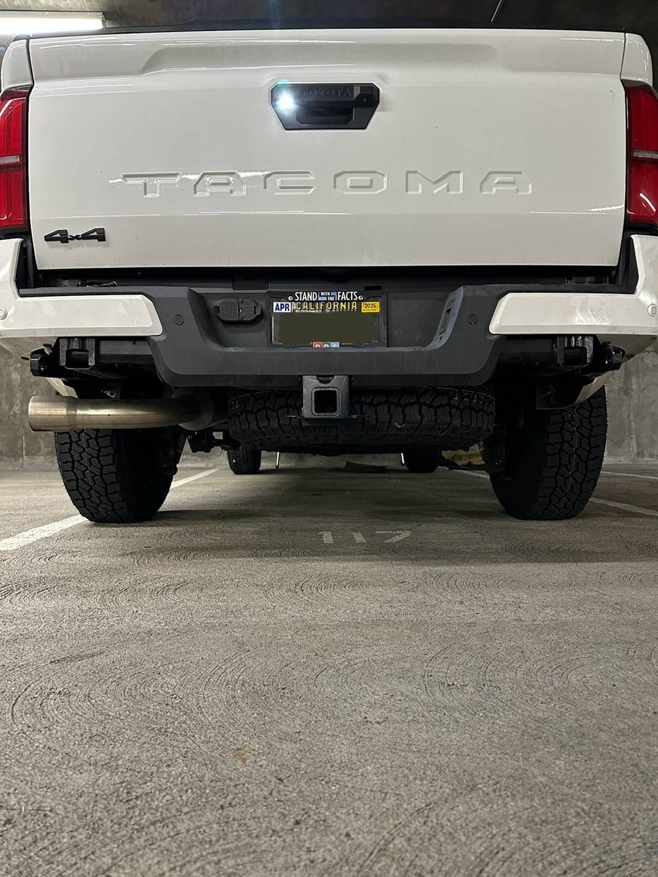

Mostly posting as I was curious how these would fit / look and if a full size would fit in place of the spare. Good news is they fit great and align perfectly with the fender flares, look great, and fit in the spare spot (very tightly).
Tires: LT255/80r17 Falken Wildpeak AT4W Load E
Wheels: 17X8.5 METHOD MR703 +25mm offset

How do they ride? This is a great choice for performance, off-roading capability, weight savings, handling on the highway, and fuel economy (low rolling resistance). I personally prefer the look of a wide tire but recognize that the skinny is better for performance.
Your tires are a true 33” which is 👌🏼

They ride great! Definitely stiffer than the stock tires but worth the peace of mind when it’s tire versus rock. It was definitely for all those reasons I went with these - plus not hanging as low in the spare tire spot. They really fill out the truck better too imo.
