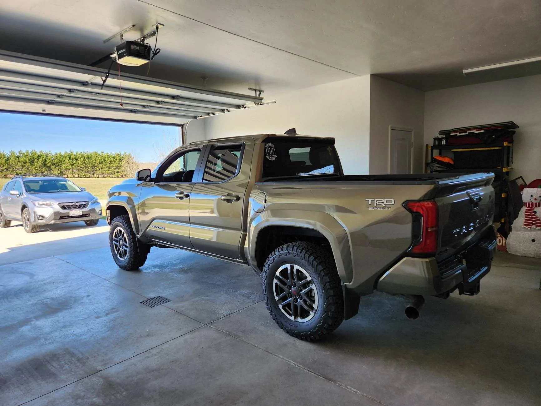

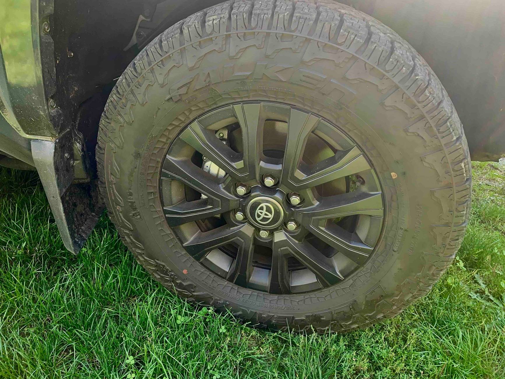

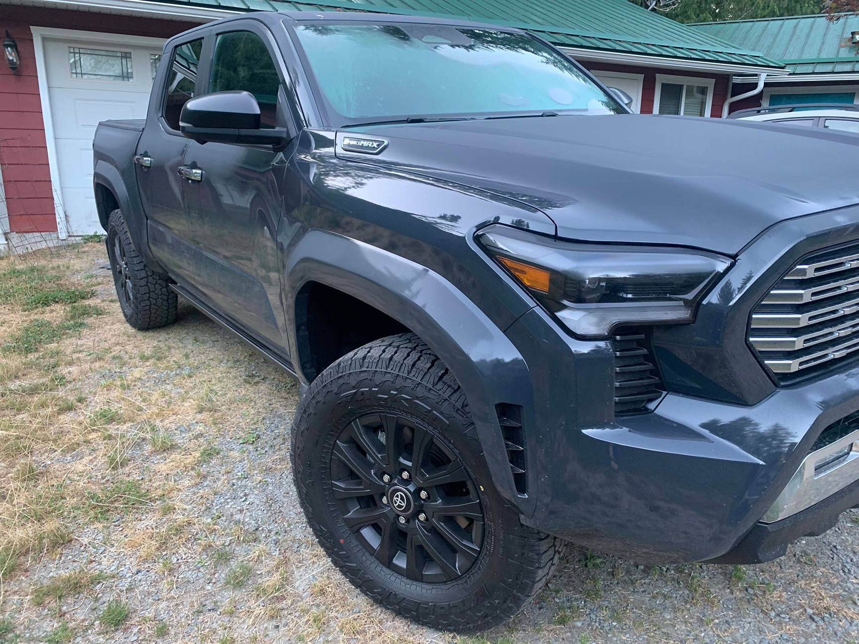

I have 265 70 18 falkens (33") on my limited.
Fits with lots of room. Sport should be the same.
34" is where it starts to get tight.

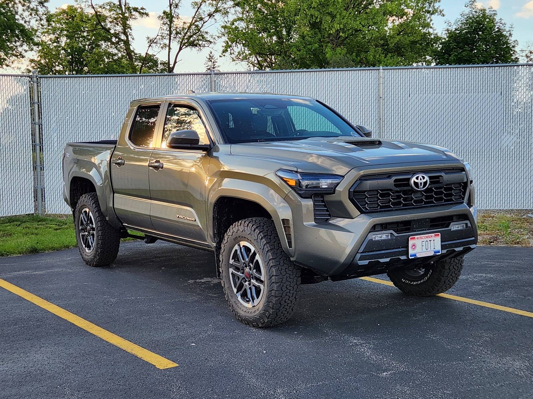

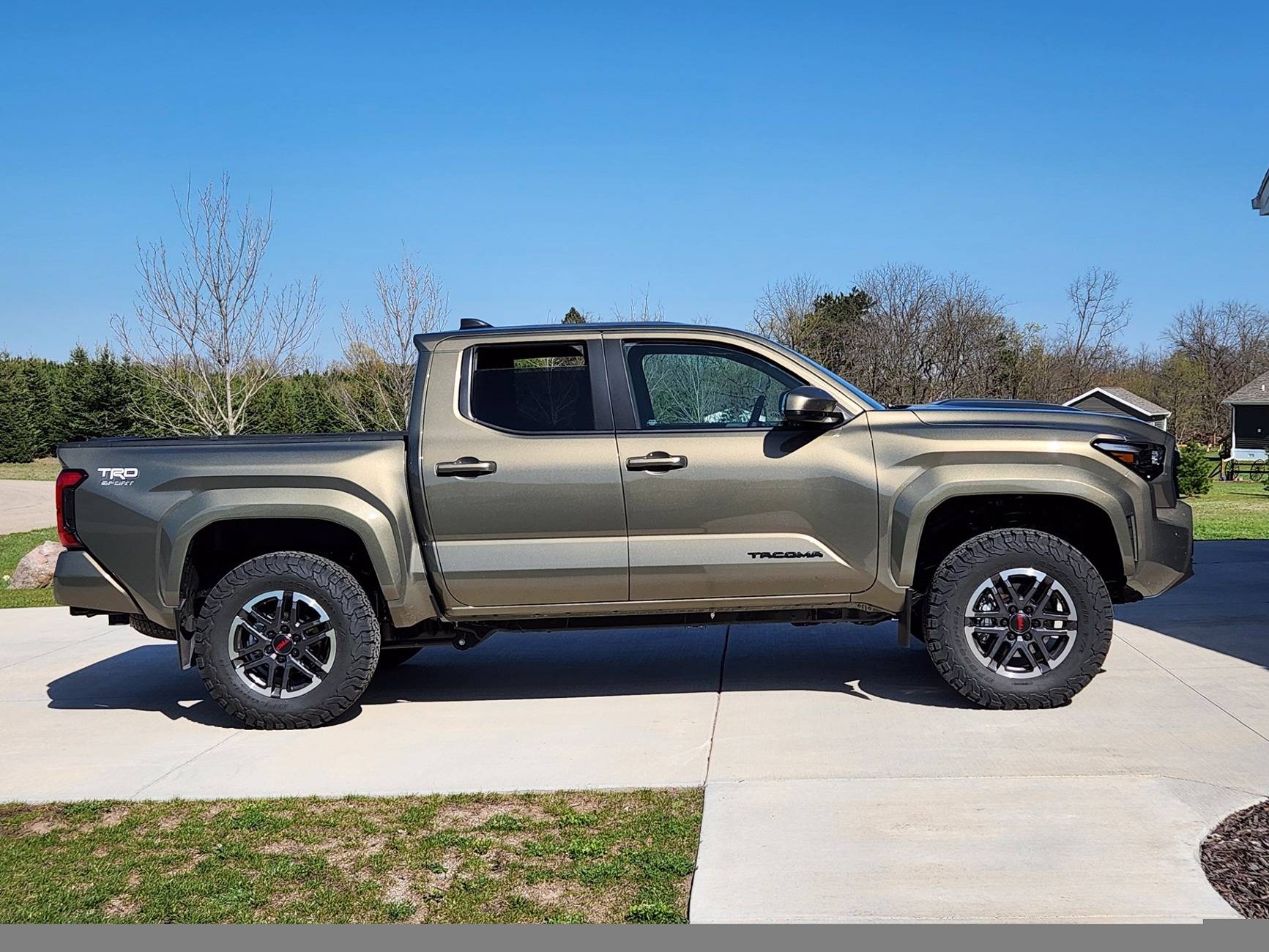

265/70's on factory 18's will fit nicely. Though I have the RC spacer up front, stil no issues even stock.
Here are KO2's at 265/70 on my TRD Sport:

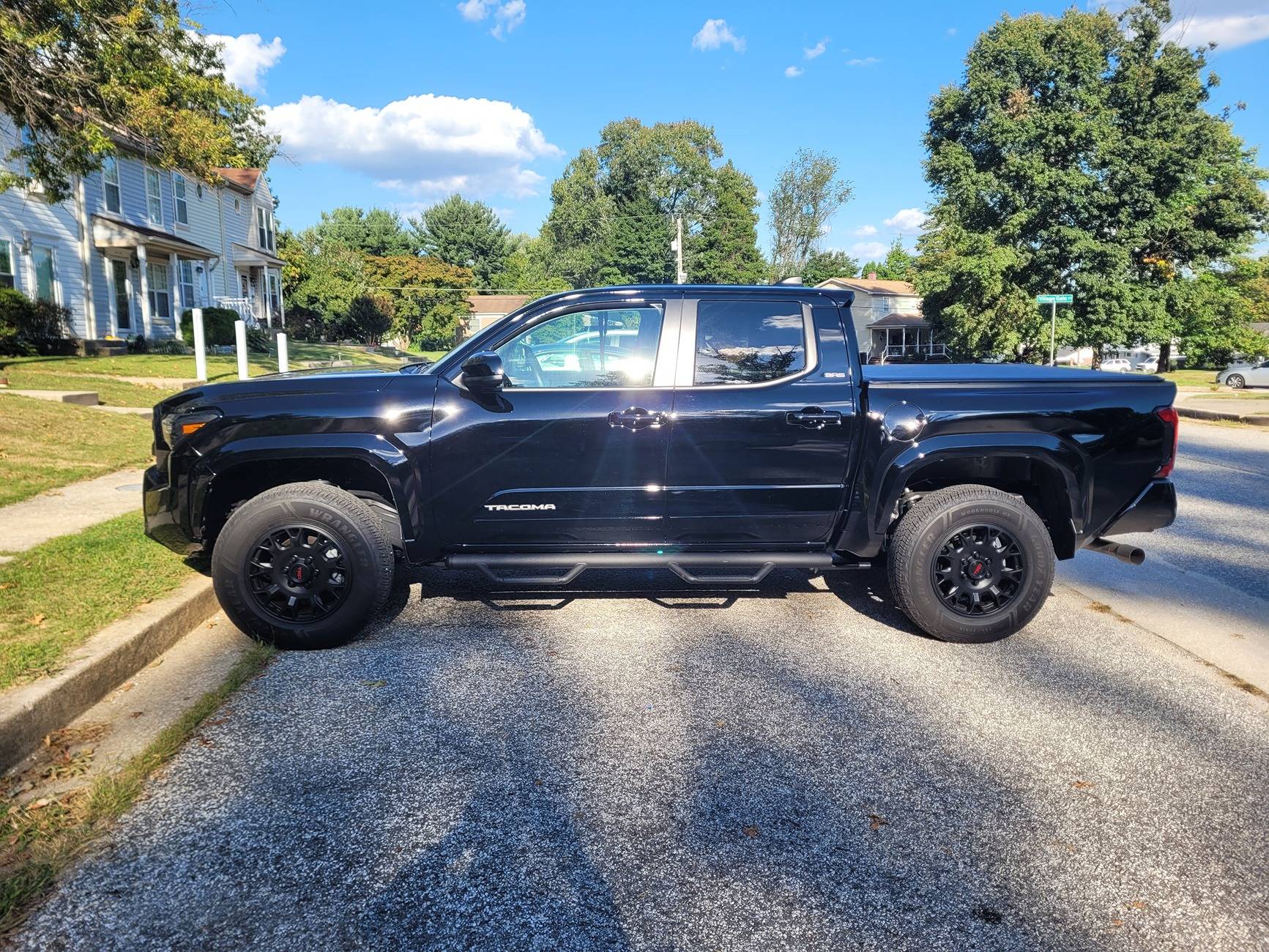

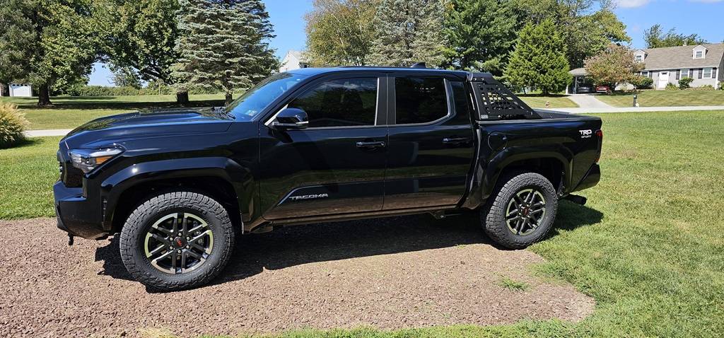

I have the Falken AT4Ws in that size with no issues, however, running 18x8 +32 wheels. Stock height.
