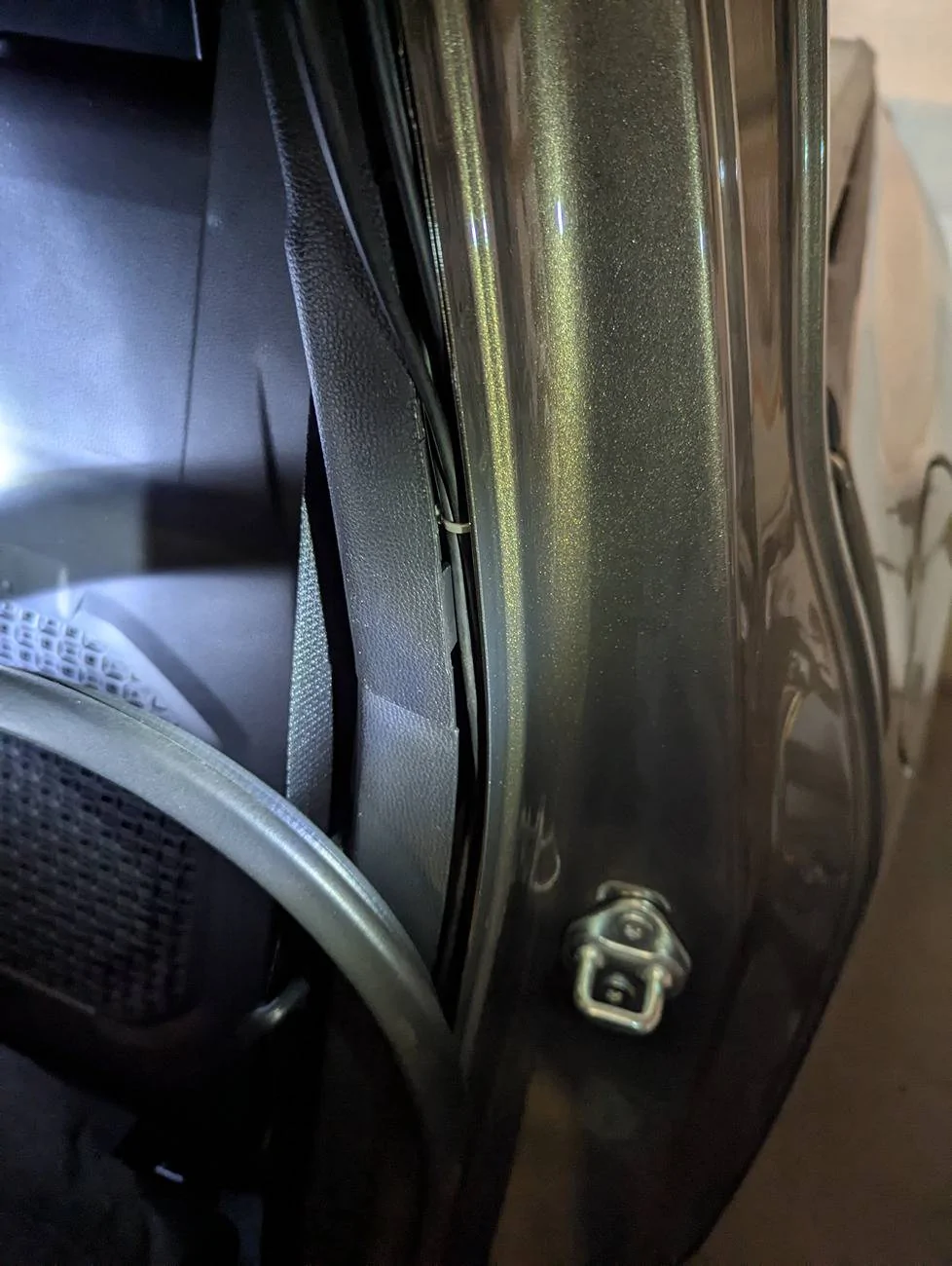

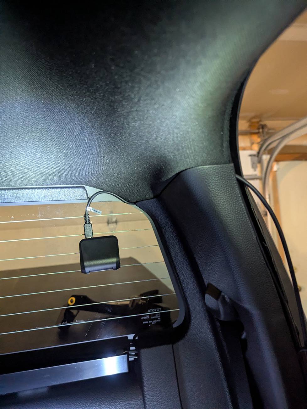

With our Vantrue N5 I tucked the rear wire right under the headliner (see pic)
Then at the A-pillar I crammed into the gap between between the plastic and headliner, without removing the A-pillar cover.
At the top of the door there's rubber weather stripping I super easily tucked into, to the B-pillar right at the crack, then all the way to the back window.
The excess wire I coiled up and left behind the rear seat. I'm only assuming this doesn't interfere with the airbag because it's pretty much following the exact edge of the headliner, which itself would not interfere with the headliner (again, an assumption). I didn't look too hard but you don't see or feel any other wires when you stick your fingers under the headliner.

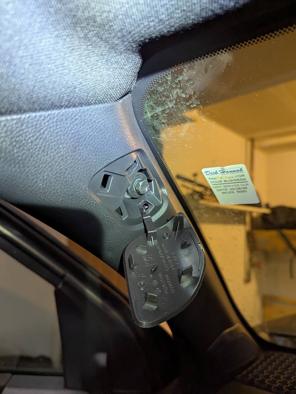

1. The cover for the screw just pops out, and it's a 10mm. Once you finished the job the torque spec for this is 9.7 N-m or 86 in-lb. If you have the JBL premium sound, be careful of the tweeter speaker wiring at the bottom. I popped the top out then just laid the cover on the dash, there's enough slack on the speaker wiring so I did not disconnect it.

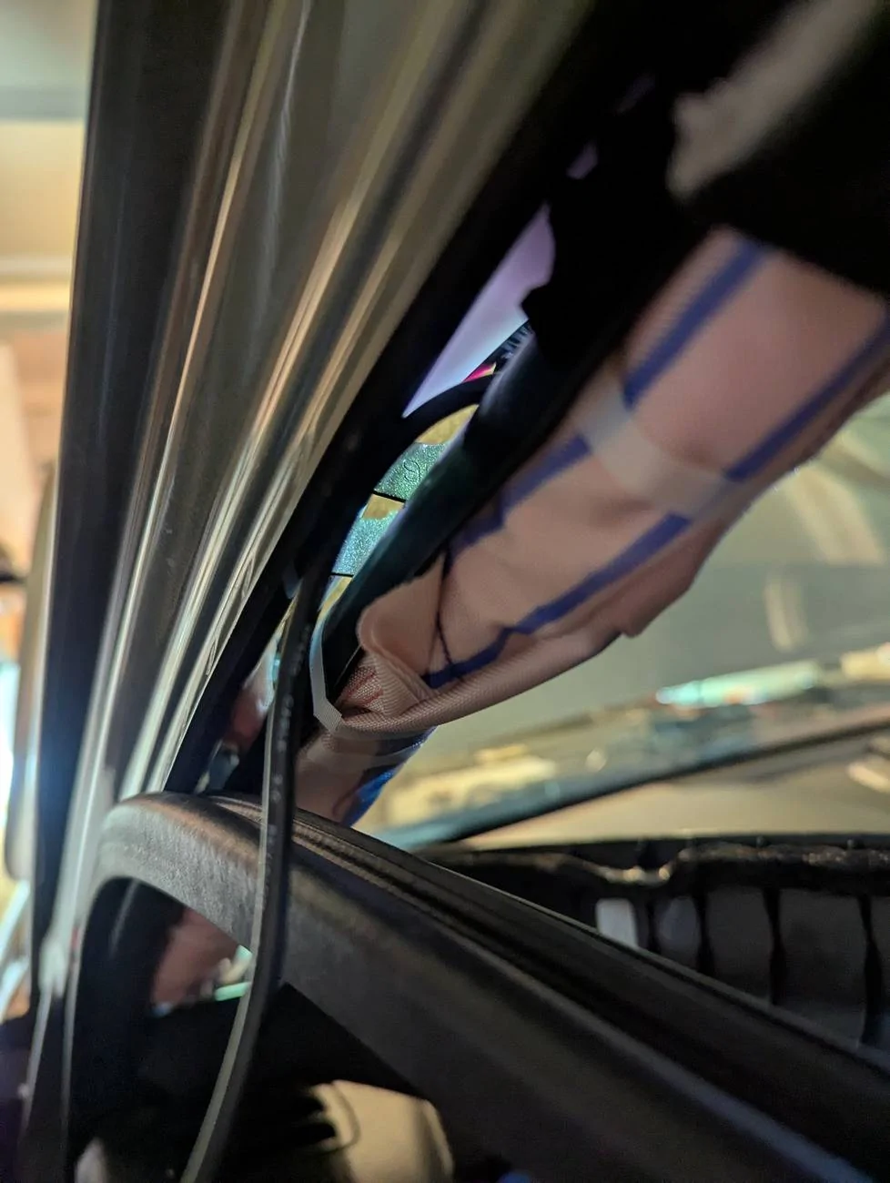

2. I routed the cable along the headliner and the aforementioned A-pillar cover, then between the airbag shield and the sunroof drain hose, then up the headliner.

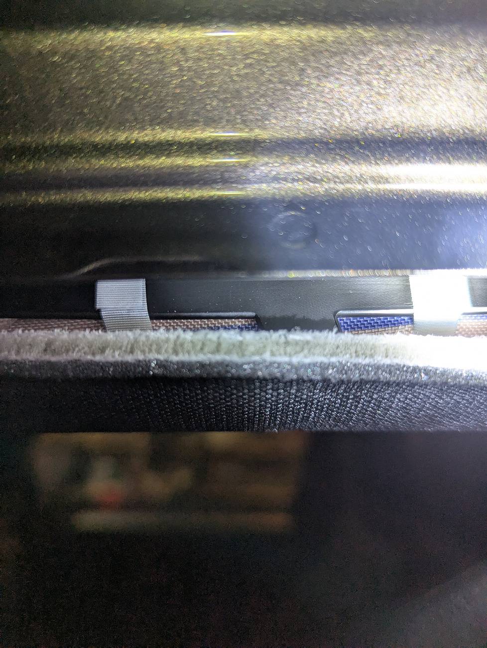

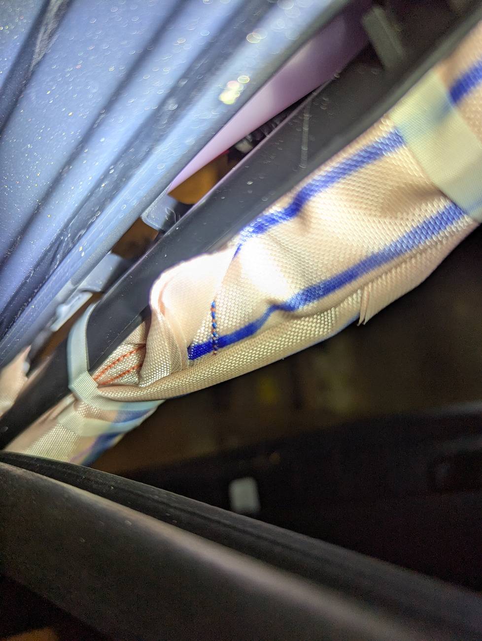

3. I routed the cable along/above the shield for the side curtain airbag to the B-pillar. Since the side curtain airbag should deploy downward, I assume as long as the cable doesn't go below the airbag it should be safe.

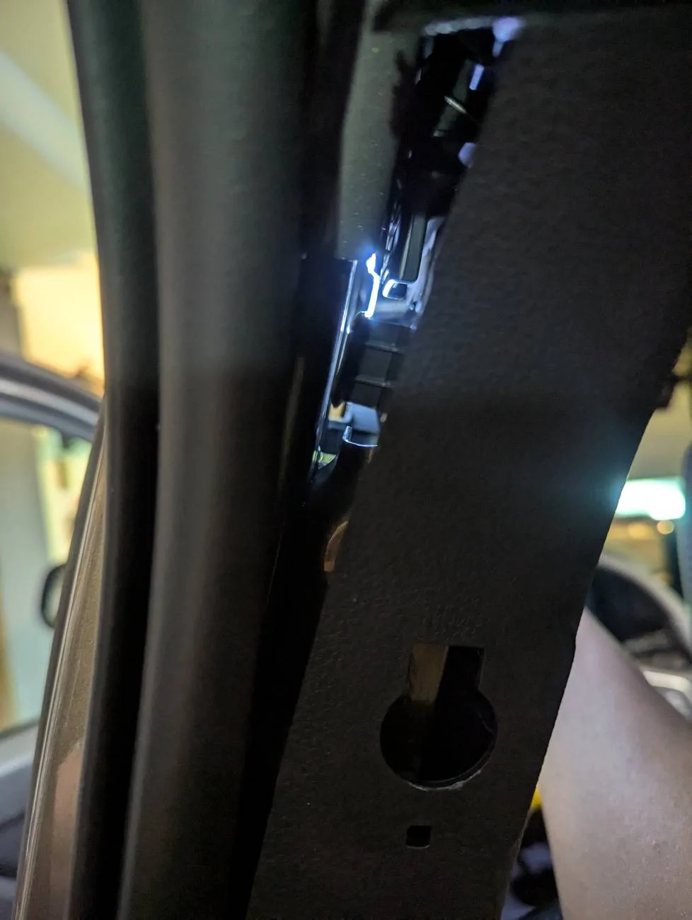

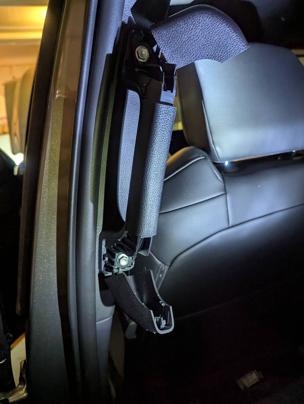

4. I undo the rear handle (couple of 10mm bolts, I again torqued it to 9.7 N-m/86 in-lb since I couldn't find the specific torque for these in the service manual), popped the top of B-pillar out a little so I can route the cable through there.
